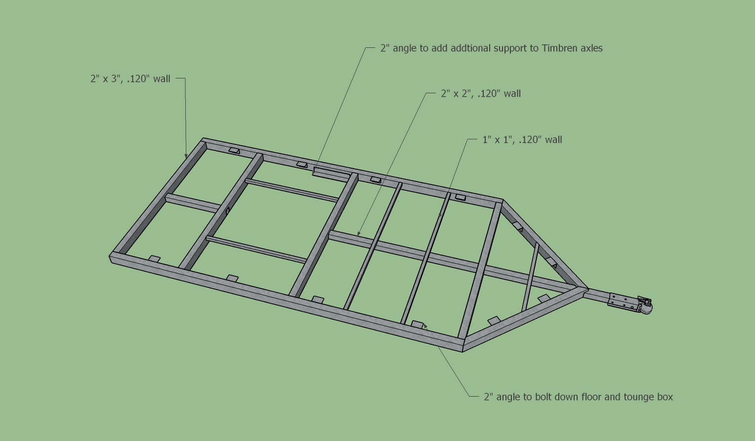

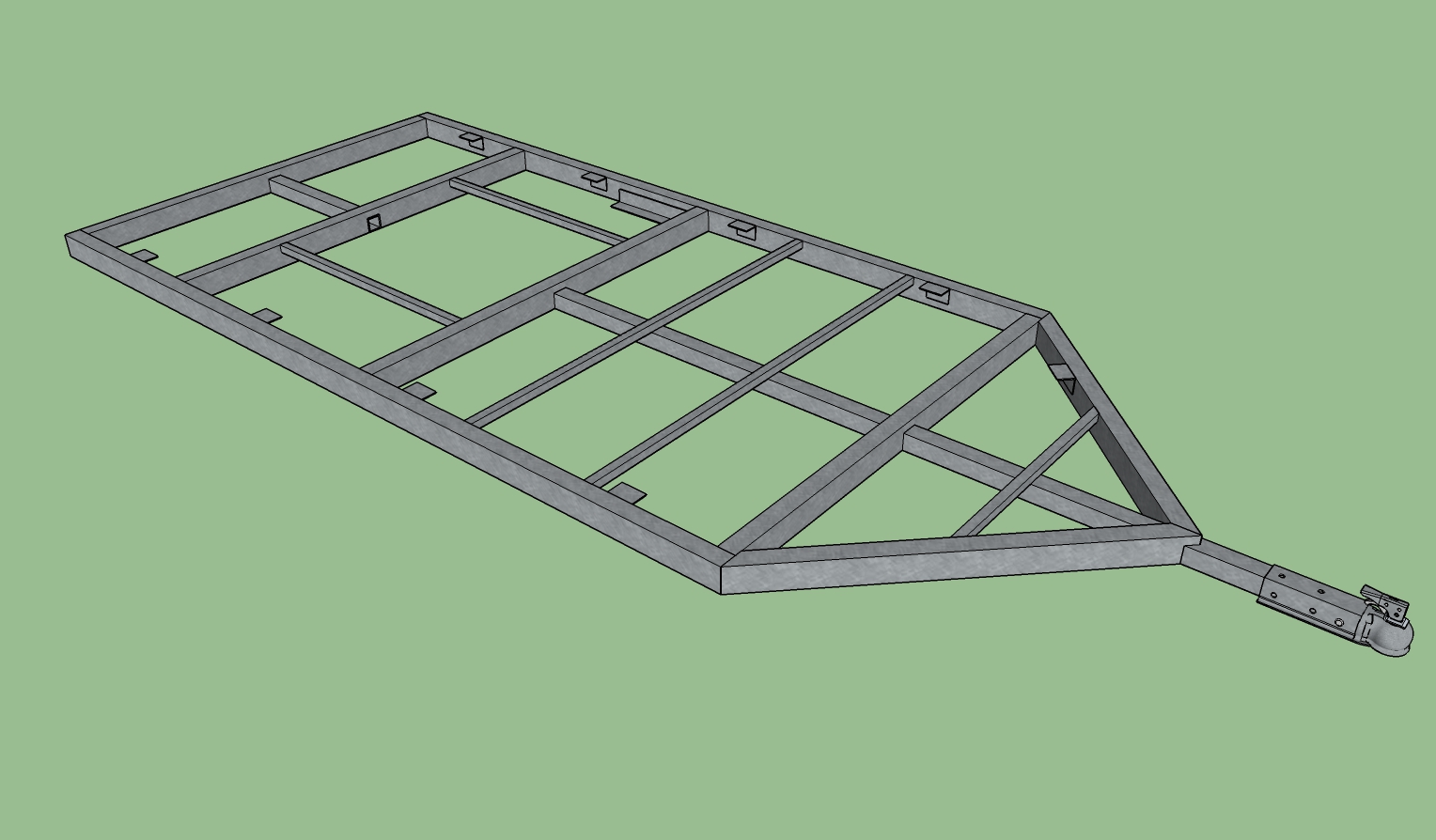

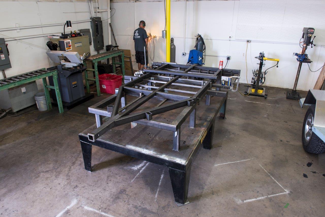

For my first ( of many i'm sure) question for the site, I wanted to get you guys too look over my plans for the trailer frame. Working as a project manager in chemical plant, I've made some very awesome connections in the construction group. One of my friends has offered to help me weld up my frame and get it powder coated through another one of our connections. I've based my plans on the frame of a Turtle Back Trailer (something I was lusting over before I decided that a teardrop is the way to go). I "borrowed" my design ideas from the following page:
http://turtlebacktrailers.com/2014/10/0 ... xperience/

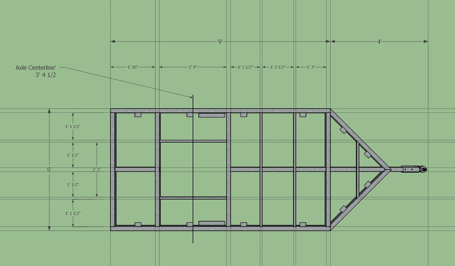

One of my concerns on the trailer design is the axle placement. I'm using Dave (DMcCam) plans for his ATMA Travelear Trailer as a guide. He used 37.5% of the frame length for the centerline of axles.
I've attached my drawings below, so let me know what you think.
Thanks,
Annu

Re: Kid's Club House Teardrop Build
Postby KCStudly » Wed Oct 05, 2016 2:27 pm
That's a lot to cram into a 5x9. For the record, 30 gal of water weighs in at 250 lbs.
Don't forget that you can get the hatch skin and roof skin out of separate pieces of ply, so you may not need a full 10 ft sheet for the main roof skins. It's easy to do a butt joint on a spar or framing member, so if you are not doing a full blown woody and your seams will be otherwise covered, the extra expense for 10 ft sheets may not be required.
On the frame, the way you have the center member lighter than the A-frame members, and coped into their underside is not conventional and much harder to fab. Also, under slinging the A-frame (rather than mitered corner joints) is far stronger and much more failure proof. You can also eliminate several of the intermediate xmbr's if you are doing a built up floor and don't intend to dance a jig on it.

Postby SCwood » Wed Oct 05, 2016 10:41 pm
I'd consider moving those mounting tabs into the corners where the frame rails meet. It'll help strengthen the frame. Not that it doesn't already look sturdy!

Postby Curryfire » Thu Oct 06, 2016 12:53 pm
Hey Guys,
Thanks for all the suggestions.
KCStudly, I see what you are saying about the frame:
"On the frame, the way you have the center member lighter than the A-frame members, and coped into their underside is not conventional and much harder to fab. Also, under slinging the A-frame (rather than mitered corner joints) is far stronger and much more failure proof. You can also eliminate several of the intermediate xmbr's if you are doing a built up floor and don't intend to dance a jig on it."
I was going back and forth on under slinging the a-frame. I really liked the look of the Turtle Back trailer and modeled my with theirs in mind (see attached pic). I'm having a mechanical engineer friend of mine run the stress calculations to make sure the setup will be strong. I was also concerned about that coping, but contacts through work said it shouldn't be a problem for them.
Thanks,
Annu
Curryfire
Posts: 6
Joined: Wed Sep 28, 2016 3:57 pm
Postby KCStudly » Thu Oct 06, 2016 2:30 pm
Okay, done deal.
When in doubt, over build! :lol:
