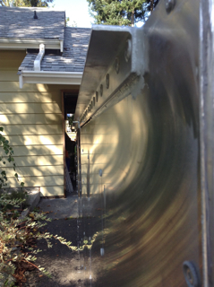

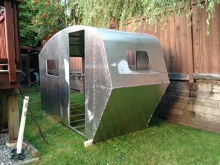

bottom of cabin - this 3/16" angle frame rail sort-of serves as a 'doubler' increasing strength/rigity of the cabin

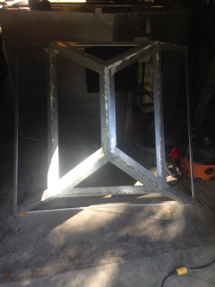

this is the cargo door (i know, it doesn't look like a door think of it like a clamshell and you get the idea)
current state of affairs on the machine

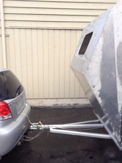

Nice rims! It looks good! Do you have another photo of the front of that trailer? I cant quite make sense of whats going on in the second photo. Too many reflections :)

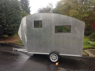

Working on it.. have a pic I'm sure somewhere.. ya the rims are.. dadadahh aluminum of course. Had to use wheel spacer adapters to fit them. If you look close at the pics you see how the back wall of the trailer is off level. This is on purpose so that the cargo door can be left open in the rain and the water hopefully drips away.. we'll see if it actually works, but its in the design. The whole shell is being leak tested for sure, just given the weather it will have to endure over the winter just sitting there.. right now the trailer is full of water, doesn't seem to have any leaks.. I dropped a medium sized c-clamp from over-height like 7ft on the skin, and punctured it with a dent and a tiny hole, and afterwards I realized it wasn't a big deal I just drilled a hole where the puncture was and riveted it with a rivet dipped in acoustic sealant. Its boat tech, so seems pretty easy that it will work with a novice aluminum welder such as me.

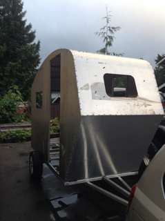

only see the tires in the mirrors, 54" wide
successful practise run with the cabin on

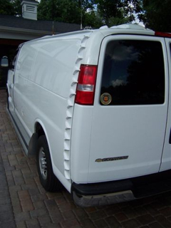

For those interested in reducing overall drag ratios using many tiny vortices of air this is the idea about using airtabs: (you get the idea, one line on the tow vehicle, one line on the trailer)
Edit: removed oversized photo with 938 views, added proper sized photo

Postby Dan242 » Sun Oct 23, 2016 11:05 pm
ssuuki19 wrote:For those interested in reducing overall drag ratios using many tiny vortices of air this is the idea about using airtabs: (you get the idea, one line on the tow vehicle, one line on the trailer)
I need to learn more about Vortices, My trailer has a square back end on it. Is their a thread on this?

Postby ssuuki19 » Sun Oct 23, 2016 11:20 pm
there might be a mention somewhere, its a small mod you can do and it does pay off, even for safety/handling. i've researched it lots, haven't used a setup yet.. so this is all talk for now. but build time will tell. i think you can just epoxy them on so if its not square it doesn't matter you just have to line them up so to speak for the effect to work best, and its a small effect, but noticeable by the reviews so i think this setup would be a good one to try them out. plainly put if they work properly they are supposed to pay themselves off in fuel savings... like i say i'm just researching them, but its seems pretty clear the install will be a significant upgrade to the tow vehicle / trailer combo. I can't wait to see what mileage it gets.. this is going to be very interesting indeed.

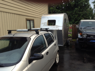

dancam wrote:Do you have another photo of the front of that trailer?
Ok so I attached some photos, I just realized you need to see the window for the effect... its a tinted moon-roof style window, I'm going to tint it even more to match all the windows.
Pretty soon, say as soon as the floor is installed, I will have to do the final weigh in, I guess I've been putting it off, I just wonder how heavy is it gonna get? Is this trailer actually going to do what it sought out to do, to run well behind a budget sub-compact?

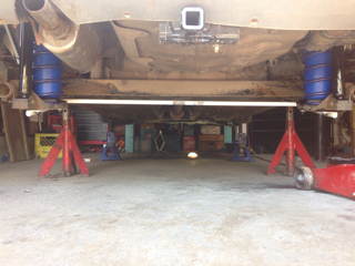

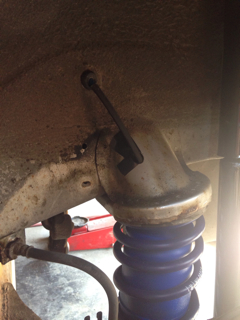

Hey Dancam, you were asking about the tow vehicle - Heres a pic of the car suspension so to show one way it can be done that seems to work just fine. At 5 or less psi the rear suspension just works with the munroe shocks and h&r lowering springs, at 15psi the airbags raise the suspension back to, (~1.25"), and over stock height, at 30psi its like there is no suspension, the munroe shocks are way beefier than the oems too:
Edit: removed oversized photo with 888 views, added proper sized photo
