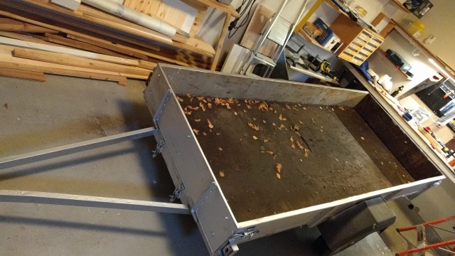

I'm building a removable teardrop/sleeping cabin for the common utility trailer. I just bought the trailer two weeks ago.
The measure is 120cmx280cm so it will be quite narrow. Suitable for one person. I bought it used and fixed the lights. I need to change the plywood. I'll do it at the beginning of january.

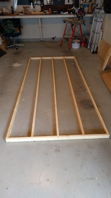

I built the floor frame. I'll add 0,9mm plywood to the frame and insulate it with polyurethane. The thing is that I'm not going to attach it to the trailer. The sleeping cabin will be attached from the side walls to the sidehulls of the utility trailer using this kind of locks:
