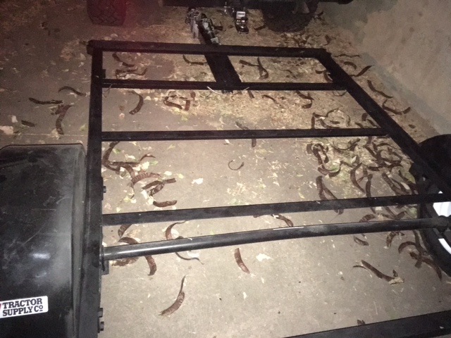

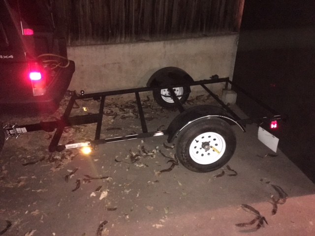

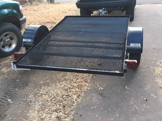

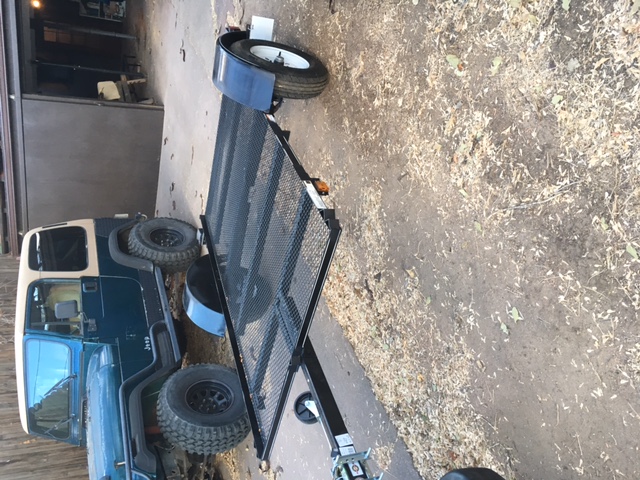

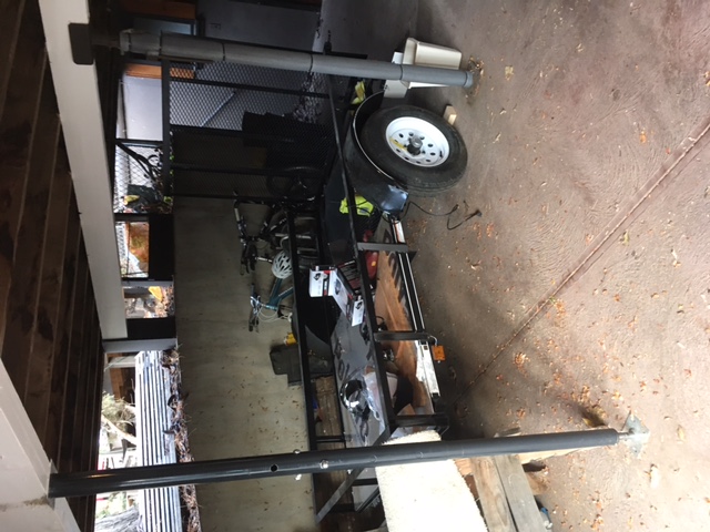

[img]Hey everyone! I'm going to attempt a build journal of my teardrop to specs I could not find. The idea is a 5x8 TSC trailer (carry-on frame) with a Big Woody basic wood components with the premium package. I am a local firefighter with a schedule of 48 on and 96 off. So I hope the build takes off really soon and allows ample time to complete my goal of completion by June 1, 2017.Three days ago I started with a factory TSC Carry-on trailer 5X8 mesh bottom. I was able to cut off the rear tailgate/ramp and grinded down the edges in about an hour. I sprayed the bare metal with paint to avoid rust. Following my shift, (today) I spent about 3 more hours removing the side rails via saws-al, cutting wheel and a grinder. I then again sprayed the bare metal with paint.

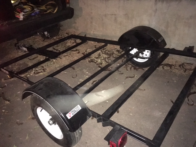

Postby cmoconnell » Tue Dec 06, 2016 8:41 pm

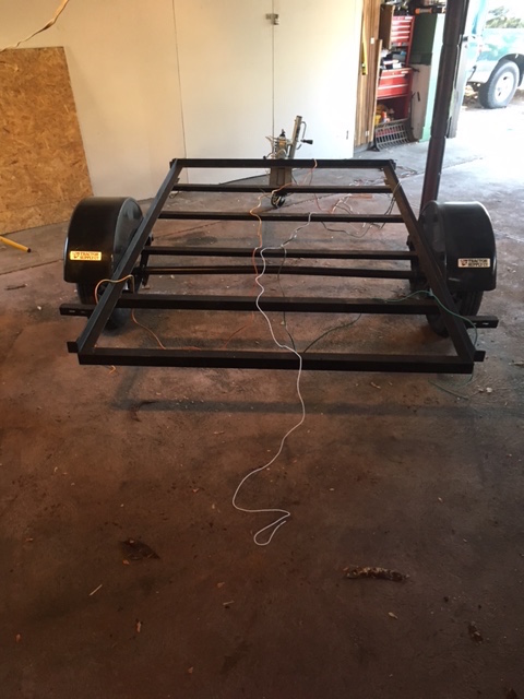

Alright guys and gals, I spent a good 5 hours cutting and grinding away the mesh floor on my TSC 5x8 here are a few pics after the work!...

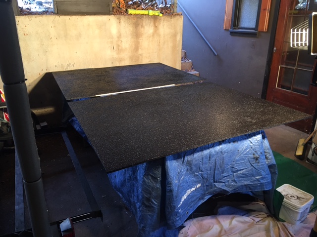

Postby cmoconnell » Thu Dec 08, 2016 3:23 pm

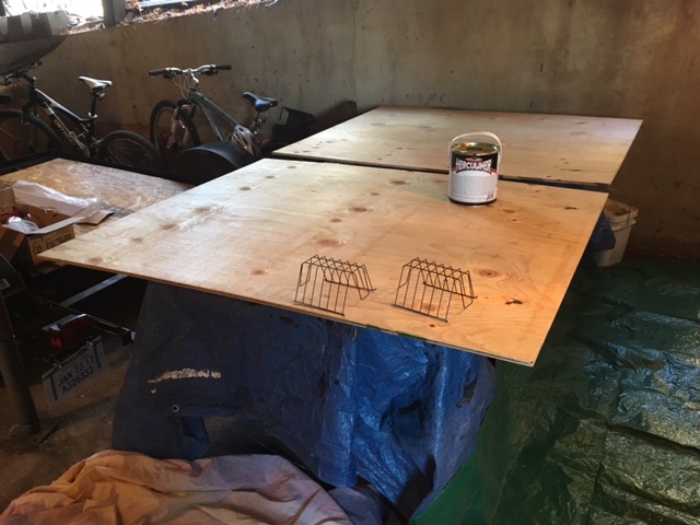

Thanks Jonb8. Its been cold outside so I haven't spent too much time on the build the last two days, but I did manage to get a few things done. Yesterday I purchased some plywood and OSB for the deck base. Today, I was able to put down my first coat of herculiner on the deck base. I hope the temperature isn't so cold that it will effect the product.... its about 25 degrees here and Im doing the work in a carport... thanks everyone and take care!
Herculined 1/2" plywood 5x4 feet times 2
Bare 1/2" plywood 5x4 feet times 2

Postby greygoos » Thu Dec 08, 2016 4:02 pm
cmoconnell wrote:Thanks Jonb8. Its been cold outside so I haven't spent too much time on the build the last two days, but I did manage to get a few things done. Yesterday I purchased some plywood and OSB for the deck base. Today, I was able to put down my first coat of herculiner on the deck base. I hope the temperature isn't so cold that it will effect the product.... its about 25 degrees here and Im doing the work in a carport... thanks everyone and take care!
Be Careful where you use OSB. It wicks up water like a sponge and turns to oatmeal.
greygoos
Posts: 631
Location: Syracuse NY
Re: 5x8 TCS Big Woody Build
Postby cmoconnell » Thu Dec 08, 2016 4:18 pm
Copy. The OSB will be above the herculined deck base and inset 3/4" on each side. Additionally it will not be exposed to the weather and will have other flooring on top.

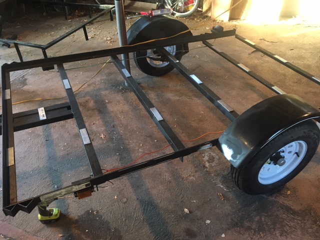

Postby cmoconnell » Mon Dec 12, 2016 9:48 pm
well got back to work on the TD again today. I started with another coat of bedliner on the deck bottoms. I think it's well coated and will keep the moisture of the road out with no problem. Next, I rewired the trailer since I had to make some electrical cuts during the tear-down of trailer. Finally once the deck (mostly) dry, I placed 1/8 aluminum shims on the low spots of the trailer with silicone. I then applied a generous amount of silicone on the frame and laid the deck onto the frame. Tomorrow I'll work on framing the deck and installing electrical and insulation before I secure my top to the deck.
