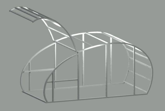

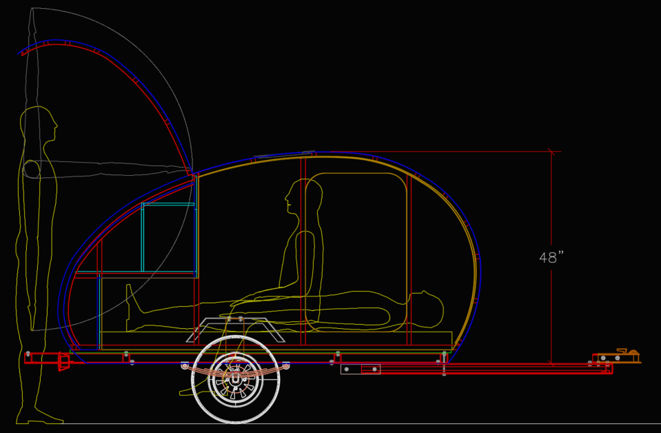

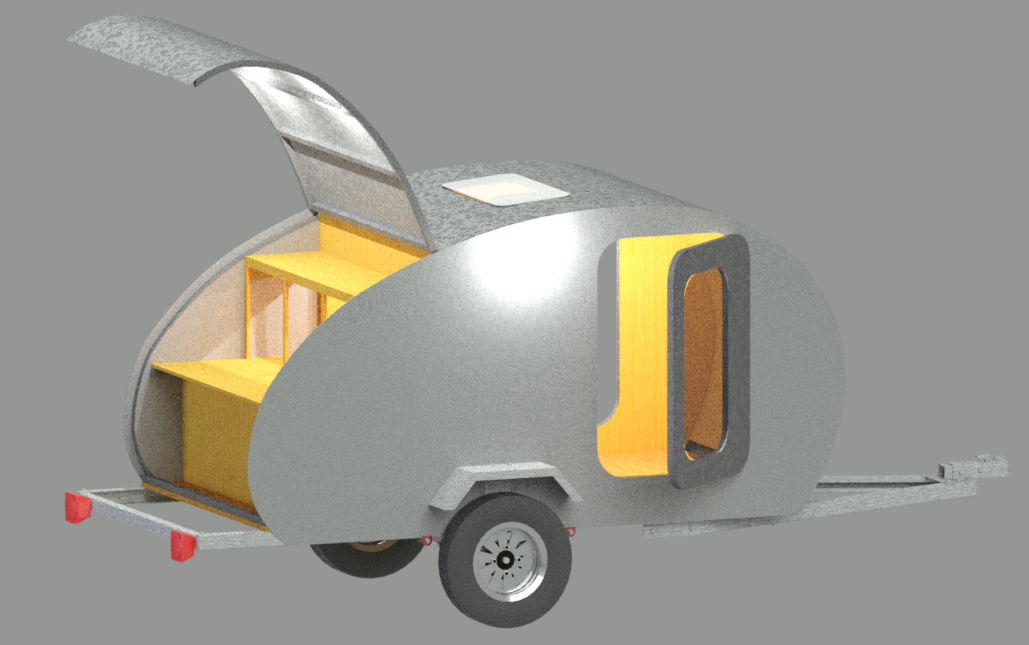

So, continuing from my original post in the "Newbies" section, http://www.tnttt.com/viewtopic.php?f=40&t=67465, I decided to take a shot at building my own Teardrop. Worked up my own plans in AutoCAD similar to the shape of the "Rascal" teardrop.
4X8 Teardrop - Section.PNG (129.95 KiB) Viewed 1160 times
4X8 Teardrop - Right Rear.PNG (583.69 KiB) Viewed 1160 times
Decided to build on the Northern Tool 4x8 Aluminum trailer and build it with 1" square aluminum tubing framing to get it as light as possible. Hoping to pull it with my motorcycle!
4x8 Teardrop Framing.PNG (69.22 KiB) Viewed 1160 times

Nice renderings. :thumbsup:
I'm curious if you have plans to shorten the rear of the chassis, or perhaps move the cabin and axle back (which would allow for a tongue box, but maybe weight control is more important... at least it would trail better with the axle back). I ask because many people find a rear bumper to be a shin knocker; several folks who feel the need for a dedicated bumper have devised clever ways to remove or drop/hinge them down and out of the way while in camp.
I agree with KC. You'll learn to hate the frame sticking that far out.

Looks great, although I agree with the suggestions to remove the rear bumper. or slide the cabin and axle to the rear. that would give you a longer tongue to provide better steering clearance and less tongue weight delta as you load and unload the trailer.
also, 500lbs should be easily achievable for a 4x8 I would think. just remember to build like an aircraft, not like a house. 10 lbs here and 10 lbs there add up quickly. put strength where you need it, and cut weight where you don't.
