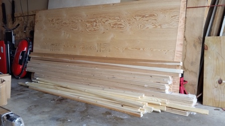

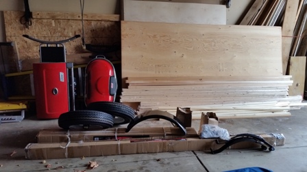

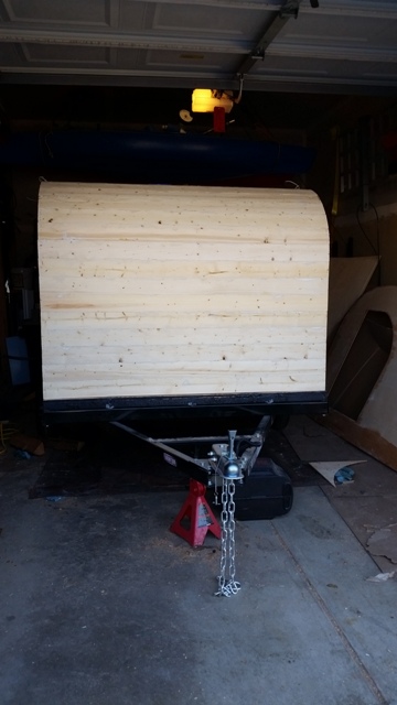

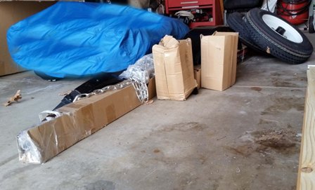

I've been lurking, asking questions, dreaming, designing and planning and decided on a generic Benroy. Ordered a 5x8 NT trailer and that arrived yesterday. Today was shopping day - picked up a good majority of my wall materials. The outside side walls will be mahogany, the roof will be white TPO, interior side panels will be covered with maps with the remainder of the interior made up of pine tongue and groove. Still looking at tutorials, need a full day of nothing to get the garage warmed up to work on the trailer and base. I don't now how often I'll post - but this is a start.

I have that same pile of trailer kit parts in my garage. I think you'll beat me to completed trailer. Looking forward to your build!

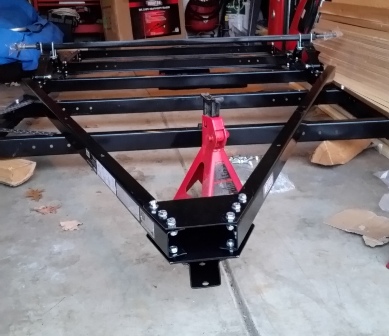

Postby dakippen » Tue Feb 07, 2017 8:39 pm
So, the trailer is done, lights checked and working. Next step is the flooring. No pictures on the wiring but hubby went the extra mile and beyond the NT wiring instructions. He beefed up the ground wire, soldered some of the connections, used a combination of black liquid tape and heat shrink tape for extra measure. Then as a bonus, we bought 1/4" black plastic channel for the wiring. Just wasn't comfortable with the wiring just tacked in place along the frame.

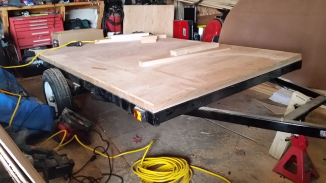

Postby dakippen » Sat Feb 11, 2017 5:30 pm
Making Progress

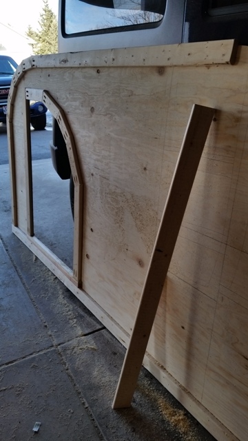

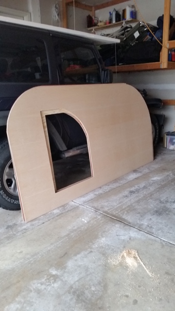

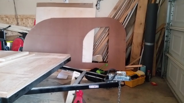

Max is about street ready, electrical on the trailer is finished so now he can be out after dark. Hubby was a sweetheart and got the decking and floor ready. Then came the template - after that was done, walls for both the exterior and interior were cut. But not without a bit of blood and bruises....
Since I'm using mahogany for my exterior, I've perused I sweat a thousand posts on sealing how-to and more confused than ever. Hubby is dead set against fiberglass....so that's out. Do I start with a weather resistant epoxy and then varnish or just a marine grade sealer?? Thoughts??

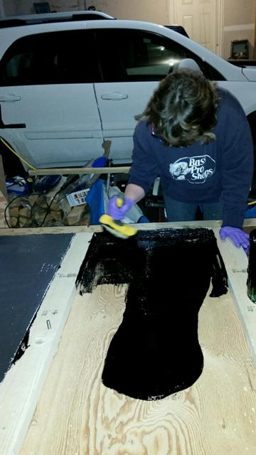

Postby dakippen » Sun Feb 12, 2017 5:44 pm

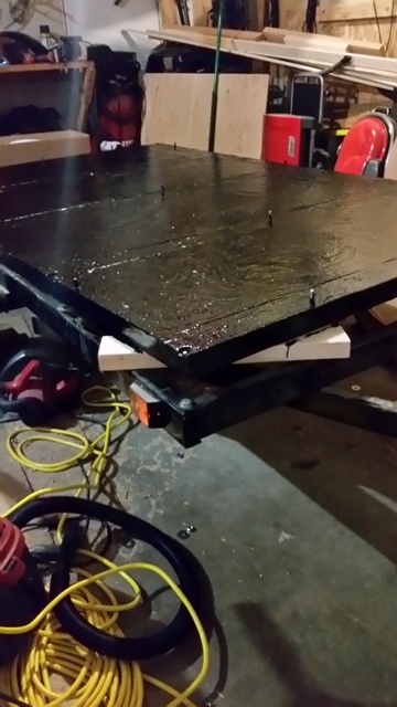

So, I couldn't find Henry's Roofing Emulsion in my area, so I went with what Home Depot suggested. Came home and tackled the really nasty job of applying tar to the underside. While I saw the most use rollers or brushes, we found that if we put on gloves, spreading went much easier...now to wait for it to dry and cure...good thing MN isn't in the middle of a freeze right now....

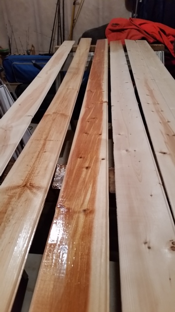

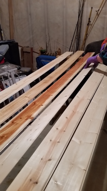

Until the tar cures and dries, I'm at a bit of a standstill so I started the polyurethane on the tongue and groove interior..I'm really liking the results.

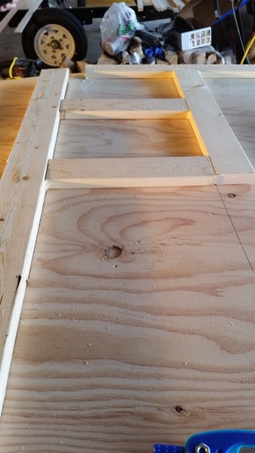

Postby dakippen » Sat Feb 18, 2017 4:52 pm

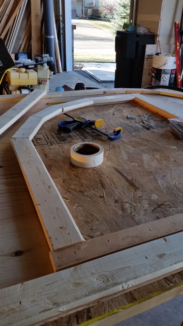

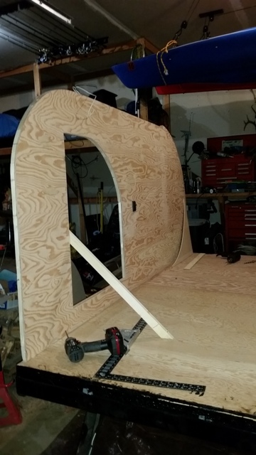

Lots of progress to date. Spread on the first layer of epoxy last night, today was spent laying out and framing. Max is really starting to take shape.

Postby dakippen » Sun Mar 05, 2017 5:06 pm
Between a nasty kick ass cold and being out of town, progress has been a bit slow, but hubby was awesome in getting some work done while I was out of town, this wkend the interior wall was put up along with the tongue and groove...today the exterior walls are going up and starting work on adding spars.
