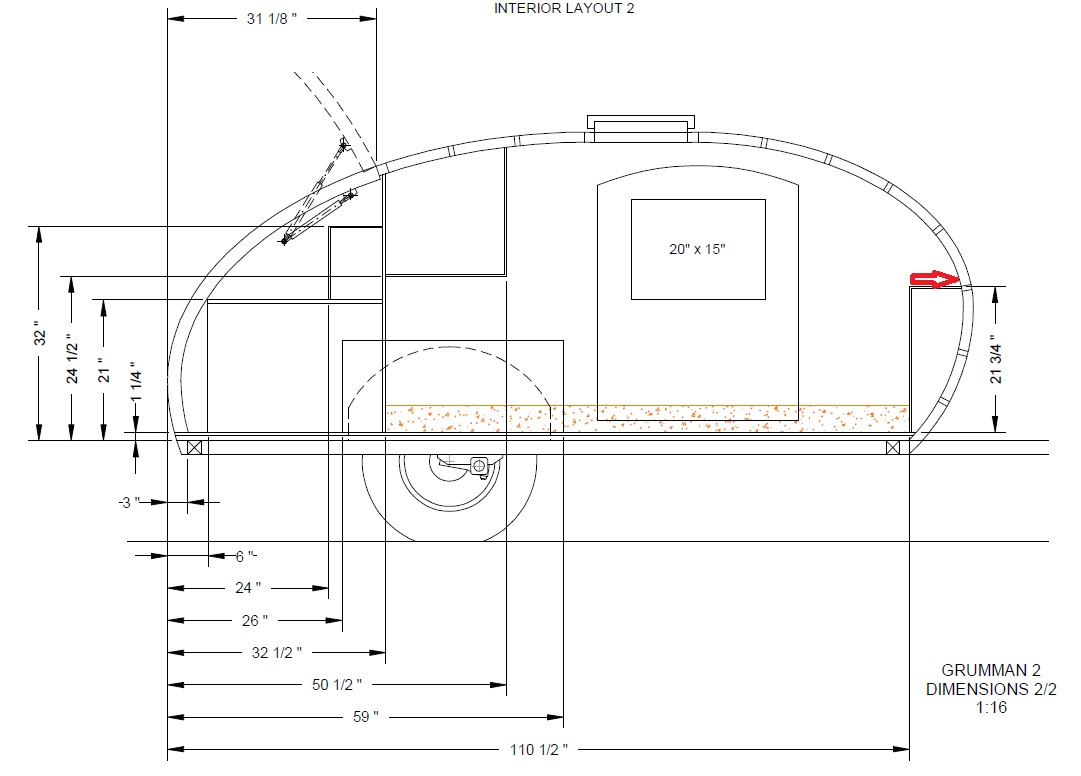

Postby DWT77 » Tue Feb 07, 2017 8:29 pm
Also if you are needing to add length to the sleeping area you could make the trailer 2 inches longer and shorten the interior cabinet by 2 or 3 inches. That would make your mattress area 80 inches. If you don't mind giving up cabinet storage at the head end. You will still have the interior cabinets at the foot end and the underneath storage.

DWT77 wrote:Also if you are needing to add length to the sleeping area you could make the trailer 2 inches longer and shorten the interior cabinet by 2 or 3 inches. That would make your mattress area 80 inches. If you don't mind giving up cabinet storage at the head end. You will still have the interior cabinets at the foot end and the underneath storage.
I was thinking of getting rid of lower cabinet storage in the front to get some more room but have a cabinet up higher so there is some storage, this should give me enough room. I have been playing around on sketchup with the wyoming woody plans to help me figure things out. Thanks for the ideas!
