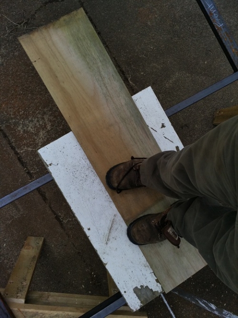

I have built stuff using an angle grinder to cut steel. I treated myself to a cold saw this time and (although a cheap one) it beats the grinder hands down for speed and tidiness. In this photo I am ripping some old 2" by 3/16th equal angle into flats to make tabs for bolting the floor to the frame. That cut was done in about thirty seconds. I build my own sawhorses, the one in the picture was done last week.

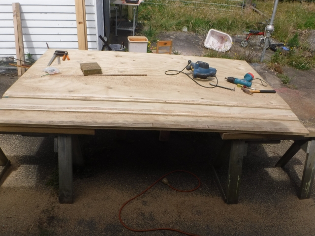

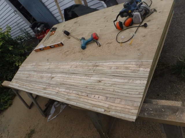

I'm using 3/4" treated ply for the floor and scarffing it as boatbuilders do. I used an 8:1 angle. Here are three sheets of plywood lined up and planing has started.
Planing took about twenty minutes of machine time, maybe, certainly not more. The work is in the lining up and tidying up afterwards. I did this partly because I wanted to practice scarffing for a different project. If you have never done it, you are aiming to get straight lines in the veneer edges and a smooth slope from the marked top to the bottom. You can do sheets one at a time but this is quicker. Scarffs nowadays don't have to be very neat, epoxy glue fills a lot of gaps.
Scarfing can also be done with a router or a circular saw, though you will need a 7" cut on the blade to scarff 3/4" ply at an 8:1 angle.

rruff, nice to hear from you, I am no craftsman either. I will let you know how this scarf goes together and how long it took when the glueing is done. The advantage of a scarf is that it allows a natural flex. I am pretty sure it doesn't matter in a small caravan floor but it is only an hours effort for a better job. If I had saved the time, I would only have wasted it drinking coffee.
Couple of pointers for anyone trying it. (1) make sure the plywoods best faces are face-to-face in your stack, so that when you join them all the good faces are on one side (I had to cut up pieces of paper and number them, sad isn't it?). (2) A master boatbuilder says to screw the planks together and to a backing sheet using heavy screws with long shanks and short threads. Nine holes to be epoxied is a small price to pay for squeezing out the warpage. (I used afew panel pins to get the alignment right before I put in roofing screws)
#1. YES, mark your panels BOLDLY in pencil
#2. YES, screwed to an under panel before even mixing the POX. the screw holes ARE insignificant
#3. make darn'd sure to use a good straight edge when aligning the panels for screwing
#4. use a lot of waxed paper under the process, a blue tarp might be in order. Pox will stick to any/everything

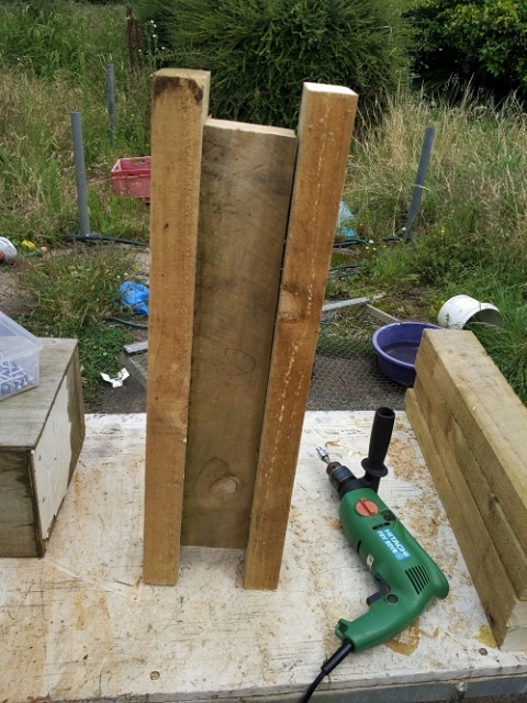

Swoody, first class advice, will take it all. You know your stuff. I am going to screw the boards upside down to two straight 2x4's when I glue them up. I wlll take the 2x4's off when it is screwed glued and bolted to the frame. The lot will weigh but I have a tractor with boom pole. I mean to work on saw horses, not the ground, so I will be able to observe the good faces, too. It's much better when you can access both sides.

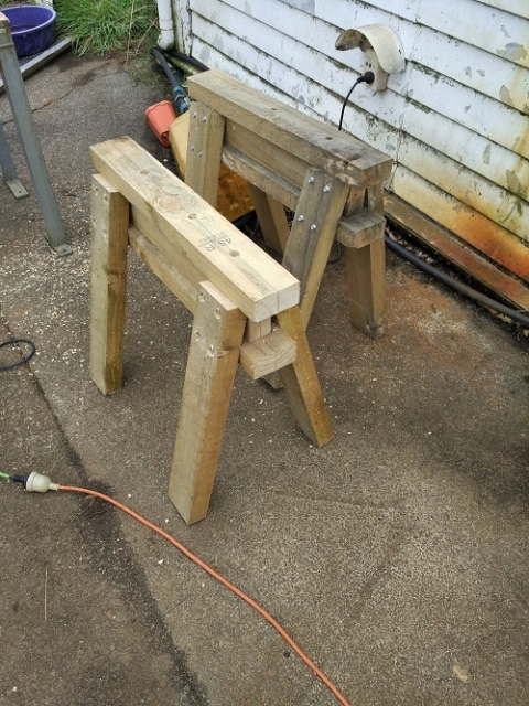

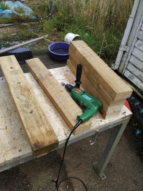

Today I built another sawhorse. Took maybe forty minutes. Not my design. The advantage is you can cramp all around the top on that overhang, and when the top is cut to bits in a few years, take off the legs, turn it over, screw the legs on again and, bingo, fresh top.

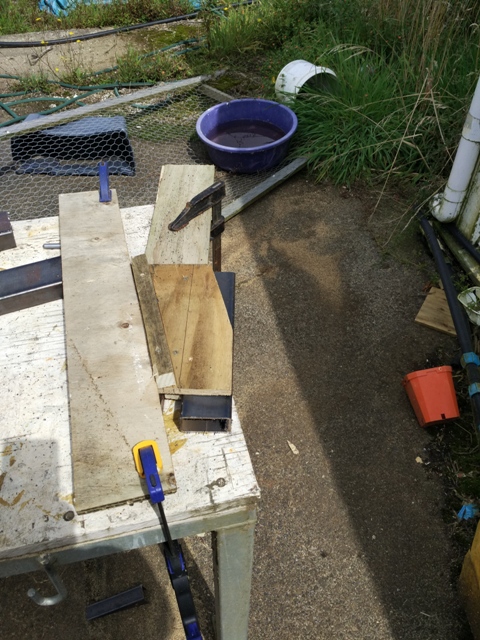

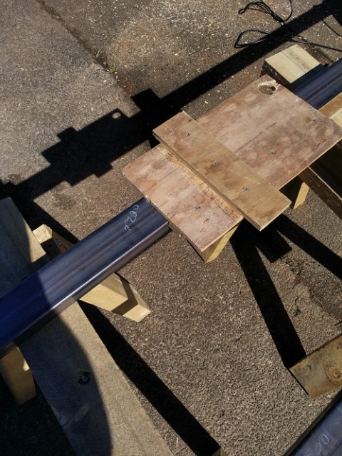

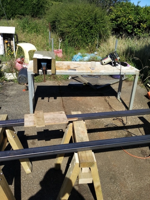

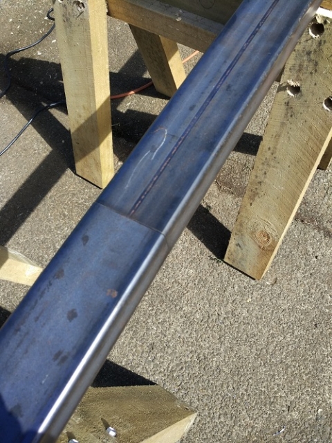

I used a simple jig I made to cut steel with the cold saw. Just a scrap of ply. Spent time getting it just right last week.
This is a long piece I cut, then turned one side. It's a good test of the angle.

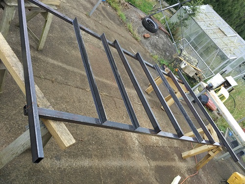

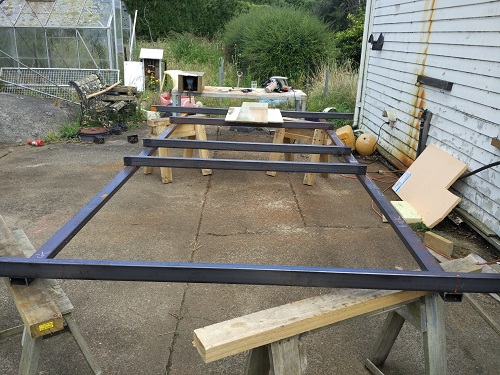

Caravan will weigh @2000lbs. The caravan will be 2200mm wide, the main rails 1585mm apart. (sorry, my calcs are in mm). I had to decide today how many cross members to use. Everything in this pic is 2 1/2" x 1 1/2" x1/8th tube. The torsion axle halves mount to the two central cross members which are effectively the axle, the a-frame mounts to the front two (furthest away). (The main rails are on their sides in this photo and nothing is in quite the right place).
I tested the flex in the floor before deciding on what size steel to use for the other cross-members. This is me between jumps. If I had known you would be looking, I would have tied my laces.
I settled on ripping 2 1/2"x 1 1/2" tube in half to make three 2 1/2" x 1 1/2" unequal angle iron lengths for the (counting from the far end, which will be the front) third, sixth and seventh members. The sixth and seventh members will be under the beds.
Rain stopped me then. I put it all under cover and will get the welder out tomorrow (I have a few spare days allocated to this either side of a business trip)

Postby hossesdad » Tue Feb 21, 2017 2:09 am

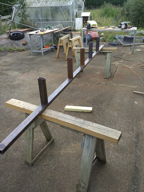

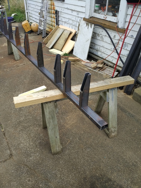

Cut outriggers today.
I like jigs. I made one for trimming the outriggers with the cold saw.

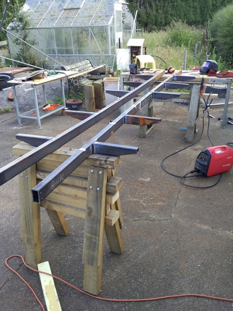

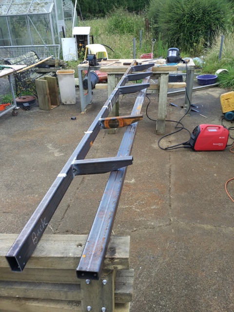

Tapered outriggers all on one rail.
Did the bevel and gap welds first
Checked a few. Seemed okay

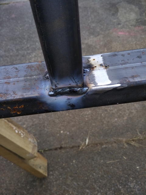

So I welded everything.

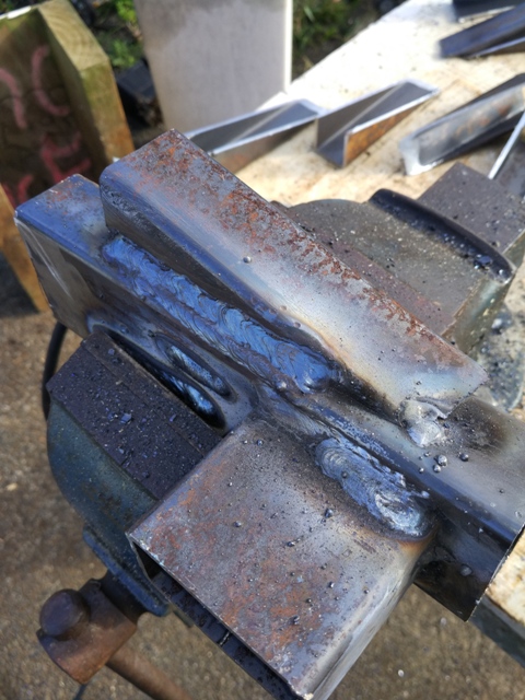

But when I knocked off the slag some of the fillet welds had slag inclusions! A problem with 6013 at low amperages, it seems. Upped the amps by 20 and did some practice runs on scrap. Much better.
Will redo some of the t-joints tomorrow. There is heat shrinkage in the rails, too, but I will be able to push it out when I do the cross-members.
