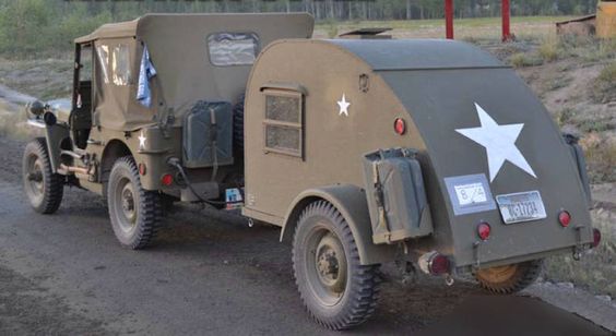

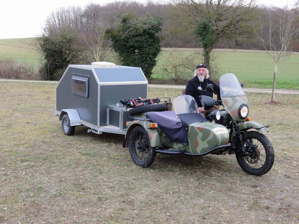

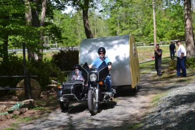

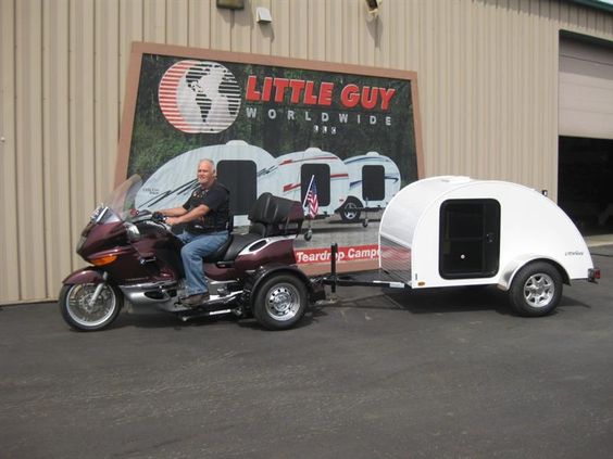

So, with all that in mind, here are a few pictures I've collected around the internet from which I'm drawing some ideas and inspiration:

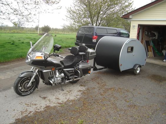

This fellow just shared his trailer on Facebook:
Photo credit: https://www.facebook.com/jose.meseguer.165?fref=nf
