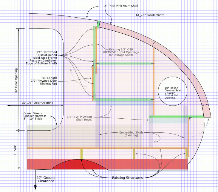

Late this afternoon I cleared everything out of the TD and started construction with some demolition. Most of the OSB shelving and partitions in the "galley" of the TD detached during transport last week, and that's OK since I plan to configure things there differently anyway. So today I removed one leftover shelf that didn't fit my plan, and also removed the hardware left behind from some of the torn-away shelving.
My plan in the back is to build in shelving but make the bulk of it accessible from the interior, not from the rear. So there won't be a hinged galley opening...since I'm not likely to need that kind of storage anyway. This should allow me to use the foam that seyfert3 has already kerfed and shaped. The piece he was going to use for a galley door broke along one of the kerfs but that should be OK. I will reinforce it and skin over the whole rear end for strength. I plan to provide an opening, with a latchable door, at the base of the back so I can slide large objects like a mattress and camp stove inside. Above that the rearmost storage area will be accessible from the TD sides, probably using a pair of 10" diameter Gamma Seal bucket lids. In this compartment I'll store long, slender objects like my tent, camp chairs and umbrellas. The two forward storage areas in the rear will be accessible from the interior only.
I've also been thinking about how to reinforce some areas and how to add things like a door latch strike plate in the foam. So today I tested a theory by drilling a 7/8" hole (using a spade bit) in the profile of one foam scrap, to a depth of 3". I then applied some Gorilla Glue in the hole and inserted a 3/4" dowel. 4 hours later (maybe less) I had a solid wood surface embedded in the foam that was clearly strong enough to accept a wood screw. I was able to drill a hole in it and drive a screw with ease. The 'hole' affair is far stronger than the foam around it so I'm confident this technique can be used to join two pieces of foam, or to provide for something like a door latch strike plate.

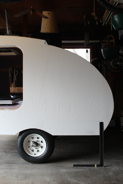

So that's the plan. Photos and a rear-end profile drawing follow. Let me know what you think.
I used this photo to create my rear-end plan/profile drawing.
View from the front left corner.

My initial plan for the back-end of the TD.
Screen Shot 2017-03-12 at 11.03.46 PM.png (125.79 KiB) Viewed 5341 times

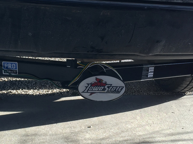

It's been a slow "trailer" week here, but I sill made a little progress, and I hope to do better tomorrow. :D
Managed to get my hitch receiver installed (complete with the required Iowa State University cover!) AND my trailer lights module and wiring. It works! I turned a 45-minute install into a 3-hour marathon (complete with one blown fuse) but it works!
The hitch in my git-along.

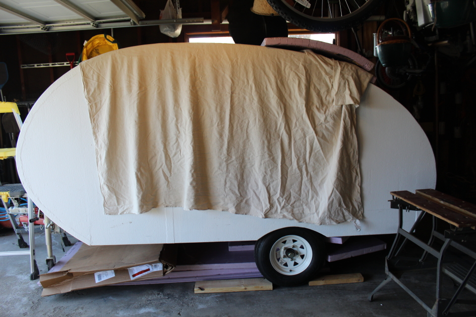

Started in earnest by leveling up the floor of the TD to give me a reference to work from. I spread the extra canvas over the top to let it dry for a week or so, and I stowed the extra foam board underneath.

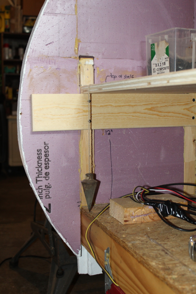

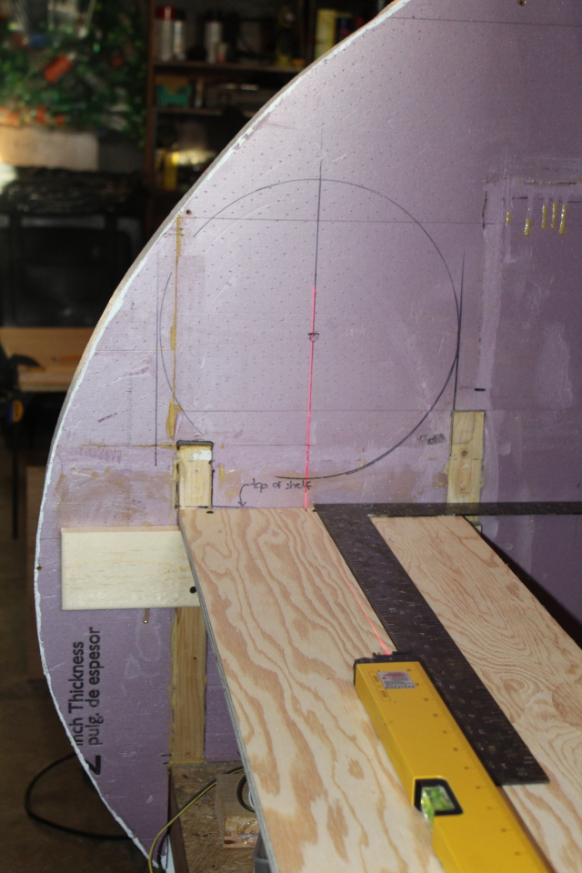

Ok, now we're getting serious. I found the rear end of the TD wasn't quite square...probably to be expected when working with foam. So I took a minute and went hunting through some old tools my dad left me when he passed away in 2010. I've never used many of them because I've had a pretty complete shop for the past 30 years, but I sort of remembered seeing an old plumb line somewhere...and found it! Put it to use here to make sure the back side of my shelf aligns perfectly with the rear of the trailer bed. I think dad would be proud, and I know he would have loved working on this project.

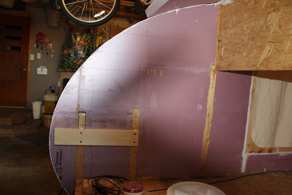

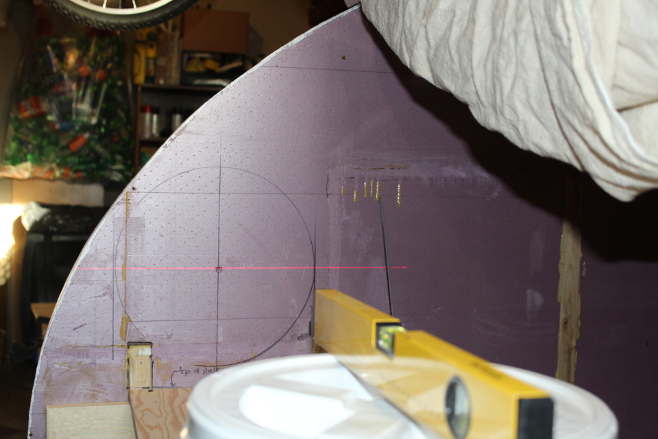

I wanted to get the locations for my rear storage covers (Gamma Seals) marked and since things aren't square I had to improvise. I positioned this where I wanted, drew in the circle (this is a 12" diameter but I might return it and go with a 10" as previously planned). Then I got out my laser level and put it to use so that I could transfer the position exactly from one side to the other.
2017-03-18 18.20.36.JPG (508.07 KiB) Viewed 5054 times
2017-03-18 18.23.28.JPG (526.29 KiB) Viewed 5054 times

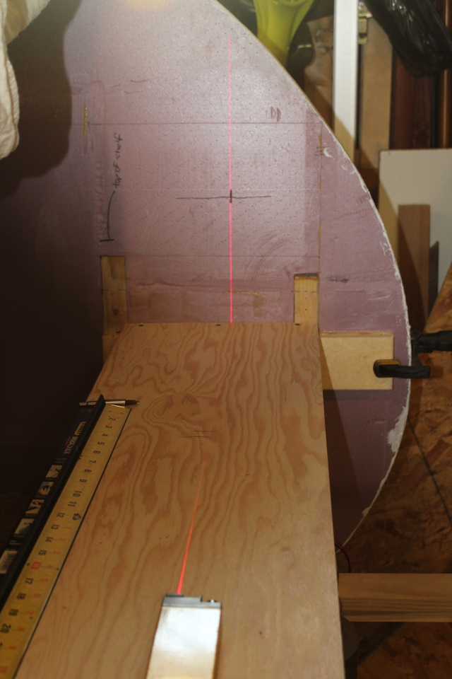

Postby SummittDweller » Sat Mar 18, 2017 10:45 pm
Here I reversed the laser level, keeping it square to the frame, and transferred the center marking.
2017-03-18 18.24.40.JPG (487.97 KiB) Viewed 5047 times

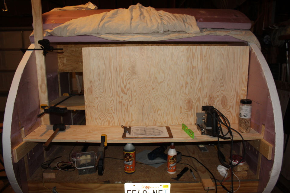

With the rear shelf screwed into place and the forward, lower shelf also installed, the plan was to add a large 3/4" plywood panel to stiffen everything up. However, as you can see below, I didn't have enough 3/4" ply to do the trick without splicing, and I really didn't want to buy another sheet just for the small portion I would need to do this in one piece. I was also lamenting how much weight that 3/4" ply would add to the build.
2017-03-18 19.58.36.JPG (553.03 KiB) Viewed 5047 times

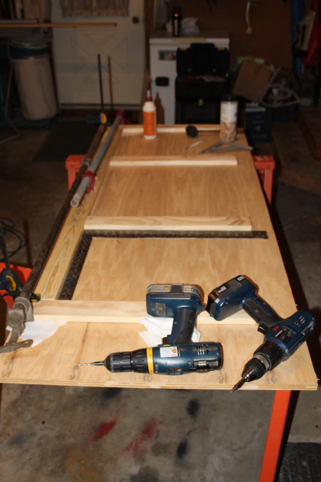

So I changed up my plans here and brought out the heavy artillery...my biscuit joiner. I used it to build three fourths of a rigid frame from 1x4 and 1x3 fir. The frame will take the place of this 3/4" panel and I'll leave it open for now for better access. When I do complete this partition I'll probably use 1/4" panel and make it removable to provide additional access to the rear shelf, if needed. The verticals in the frame will be screwed into the end grain of both the forward (two of them) and rear shelves so the whole affair should be nice and solid.
2017-03-18 21.02.23.JPG (484.61 KiB) Viewed 5047 times
I also pulled a couple of tricks here... I didn't have a single clamp long enough to pull the long member of the frame together so I screwed on a temporary cleat in the middle and used two clamps to pull the ends in tight while the glue sets. I also am positioning this frame inside the TD just below one of the seams in the rear of the roof. I'll reinforce that foam with a fir 1x3 and use the portion extending below the roof to tie into the frame. That should significantly stiffen and strengthen the roof too.
