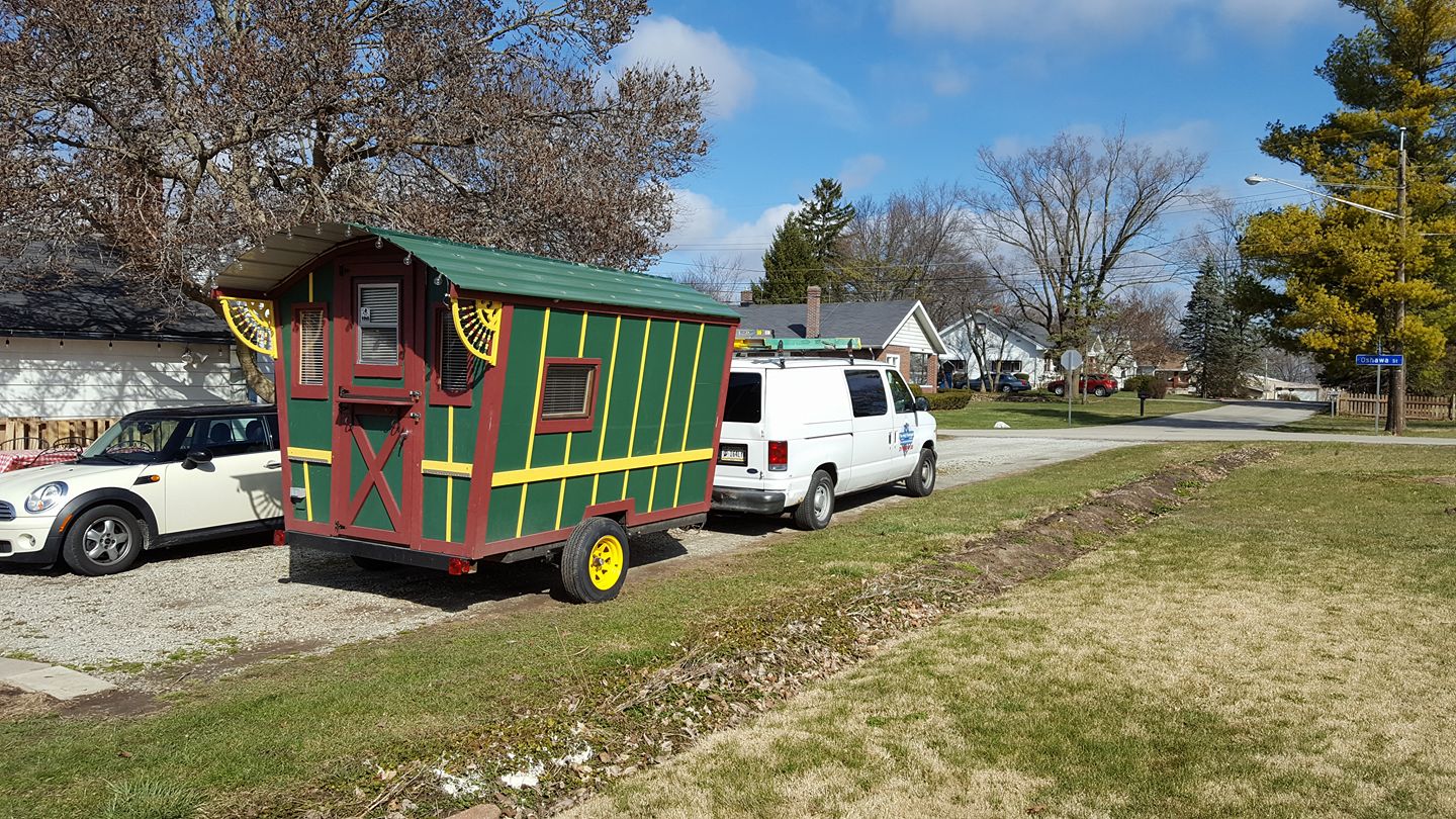

This pic is from my friend's home-built "Gypsy Wagon". Pretty much built like a shed that's permanently attached to the trailer. Queen bed inside with a small kitchen and a ton of cabinets for storing cookware. He loves cooking (former caterer), so he's got all the cast iron and everything in there. But he also has a small gas stove.
