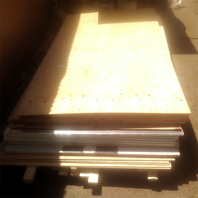

Postby Woodpecker » Sat Apr 15, 2017 6:12 pm
Fun day at the Hardware store!

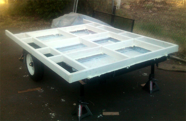

Postby Woodpecker » Mon Apr 17, 2017 8:26 pm
Fabricated the floor frame, fun! Flipped it to pre-drill the holes for the lag screws and paint the underside.
Nice layer of construction adhesive and lagged it down to the frame.
Primered the whole and ran the foam around it to seal any stray holes.

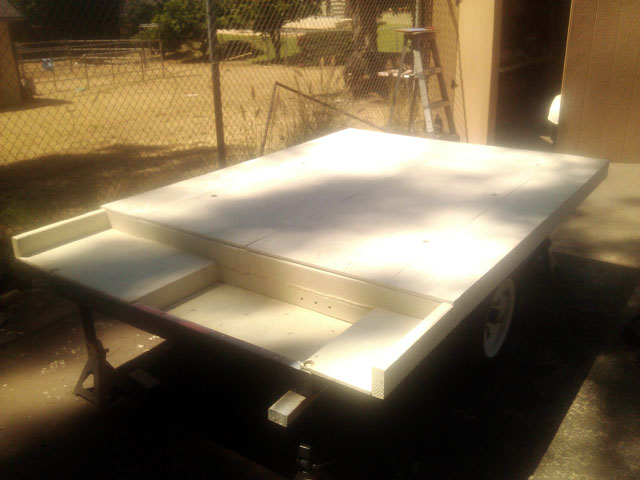

Postby Woodpecker » Thu Apr 20, 2017 1:49 pm
Storage Nest doors all done. Trailer floor fabrication is complete and she's ready for some walls!

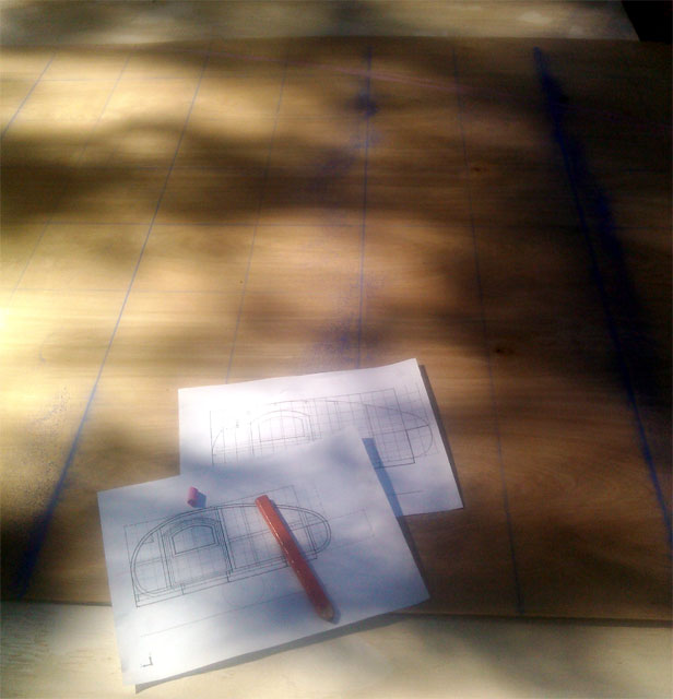

Made some design changes so I had to loft a new Jig.
Cut all 4 walls. Now to do some math and cut the doors out.
