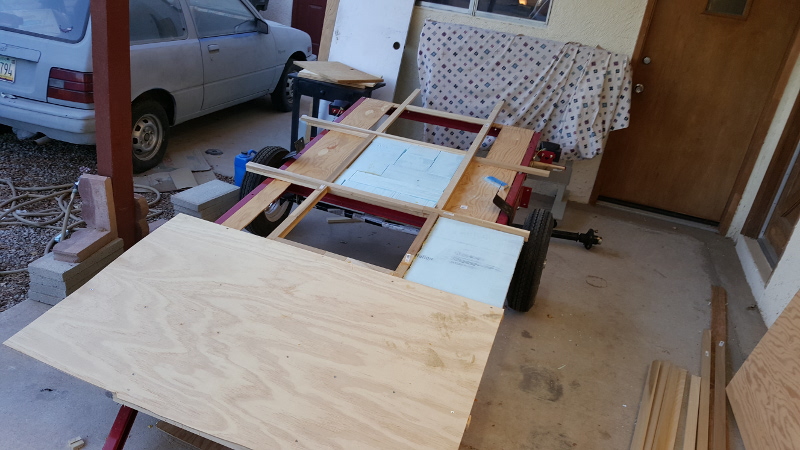

Postby nemoskull » Fri Jan 19, 2018 3:24 pm
the deck is built. im going for minimun weight, so its 1/4 plywood with foam insulation sandwitch. works good. nice and solid. poplar frame. 5x10 on a 4x8 chassis.
the pic gives a good idea of the construction method.
i got three dropped floor/under deck storage compartments, roughly 24 inch square and 9 inches deep. the front most one will probably house the batteries.
