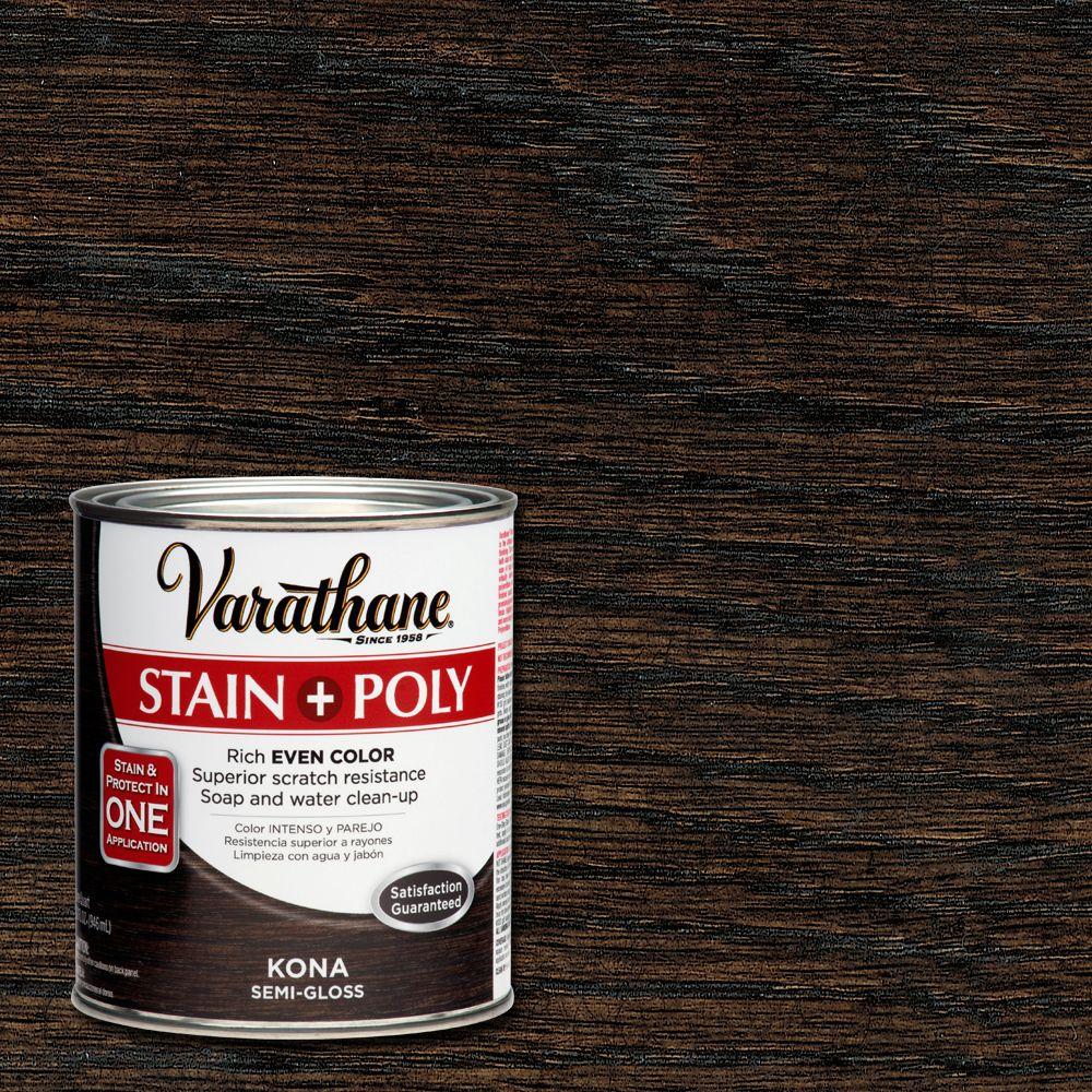

I don't have any pics right now, but one thing I can post is a pic of the color that I will be staining the plywood parts with to protect them and give my machine some character...
Stain + Poly for the CNC
