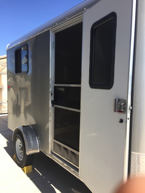

I ordered the trailer new, its a Mirage, with the bubble wrap foil type of insulation, an RV style door with window and screen door, sliding windows with screens on either side and a standard size roof vent. It has a fold down rear ramp door and curved front and roof, and is an extra foot tall from standard. Since I've had this trailer a few years now and camped and moved with it I think I would purchase a Vee-nose with flat roof if doing again, but oh well it is kind of a parachute behind the truck.

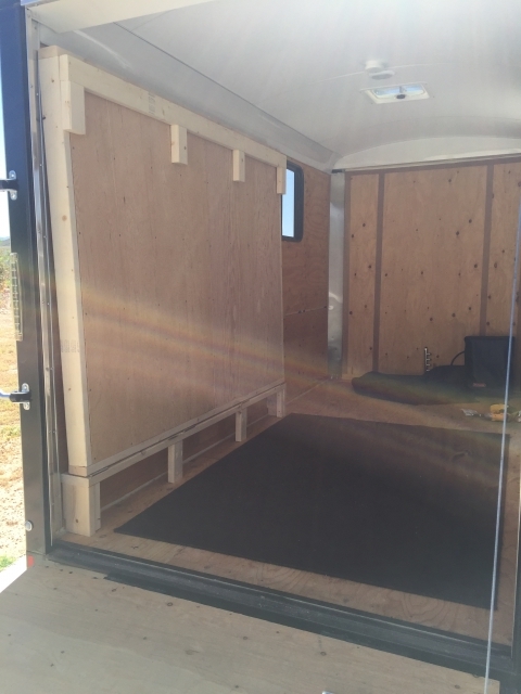

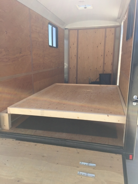

Last year I built a fold down queen size bed that we will use with a 4 inch memory foam mattress pad. The bed is quite heavy though, I am thinking of having a friend make up a steel frame thats much lighter. Does anyone know of good design resource for metal fold down bed? I don't want to make a second "too heavy" bed frame.

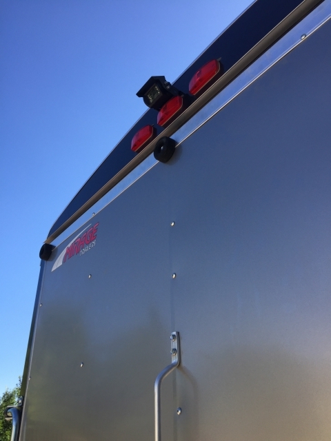

Backing up was always a worry of mine, especially when we camp for hunting we are just out in the national forests here in UT so theres usually obstacles when parking. I got a backup camera kit intended for road salt spreaders, and installed the camera up high on the back of the trailer. The wire runs hidden inside the trailer and then out to a connector on the tongue. I got an adapter to fit the factory plug on my truck at the tailgate. When I hookup the trailer, I just unplug the tailgate camera connector and plug in the trailer and now when reversing the trailer camera is what comes up on the factory screen in my truck!
