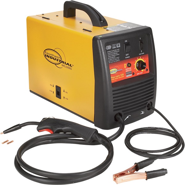

  • I helped make my frame (from a junk motorcycle trailer) by welding on 12" in front, and 24" in the rear, and other major mods, using a big Miller 220vac Mig unit. I helped, because I was not a welder, but had been attempting to learn for 10+ years. My friend, an expert, did over 90% of the welds. But, years later, I had to do a major modification to my completed trailer, removing the old (undersized) axle, and replacing it with a heavy-duty 3500 lb axle, springs, hangers, and all. And reinforcing the damaged frame at the same time (spring hanger tore off).
  • That's where our stories meet : " I don't trust my welding or my cheapo HF welder so I used 2" angle and bolted it in addition to welding....". I had to do the welding myself, this time, using a new Northern Industrial 110vac flx-core welder, using it for the first time. I had bought a 220vac stick welder from Northern, to do the job (for which I bought 1/4" angle iron, for the frame beefing and repair), but my garage wiring was only 40amp, so I didn't have time to rewire the service to handle the stick welder (I found out later, that it would've worked anyhow, with new receptacles). I'm sure that the 110v welder isn't capable of as deep a penetrating weld as the 220v welder, but I repeatedly worked on my pieces, beveling, welding, grinding (repeat, repeat), until I was satisfied with it. Then, I took the pieces (30" long angle iron with spring hangers welded to them) to work, where I had our resident welding specialist examine them, and see if he needed to re-do them for me, with the monster Mig he had there. He said that the welds were deep enough, and he said he thought I used the 220v welder, not the 110v. Even with the reassurance, I also bolted the spring hangers to the angle iron, as a safety, in case the welds failed, later. Three years, 2000+ miles, and a near catastrophic pothole incident later, the pieces are still holding together.
  • I've seldom had to use the 110v welder (nor the 220v welder, still wrapped in plastic), but it's never short-cycled on me, and exceeds its' listed duty cycle, making it weld like a larger unit. My neighbor borrowed it to weld on his recently bought trailer (his welder(s) were un-reachable, buried deep in his garage, and expressed his amazement on the capability of the little welder, also. I guess some Chinese junk will work, sometimes. But, I'm waiting for the day when we're finally ready to upgrade our home electrical service, so I can use the big welder, and make a trailer from scratch, like I used to help do, at my friend's shop. Having a success repairing and rebuilding my trailer (against advice), sure gives me the confidence that maybe old dog can learn new tricks!
    northern welder.jpg (85.09 KiB) Viewed 2267 times
    the 110 vac welder "overachiever"

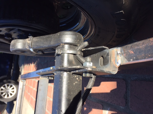

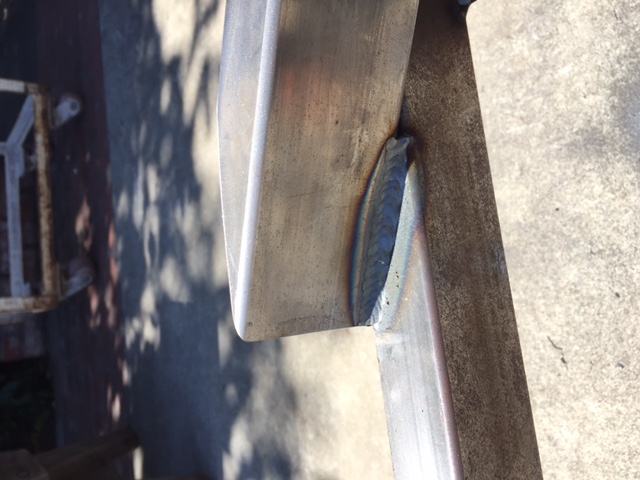

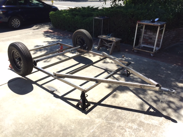

More work done this weekend after getting my #9 Torflex axle in the mail. Stats are 60" between brackets and 72" between hub measurements, 32 degrees down angle, with camber, reverse brackets, ez-lube and prewired with electric brakes, that last part threw me a curve ball today. I chose the reverse brackets because my frame is only 1.5 inches wide and didn't want the weld on bracket to stick outside of the frame. I added some 1/8 inch 1.5 x 2" angle spaced at 2' to support the floor.
The pre-wired option came into play when I went to weld the axle brackets. I thought I would tack weld them in place with the axle still bolted to the bracket and then remove the axle so I could get good clearance to strip the paint and weld comfortably. Anyhow, since they came pre-wired, the wires pass through BOTH brackets making it a major pain to remove the axle, so, I didn't.
The other difficult part today was lining up the tongue so it was dead on straight. I took multiple measurements to ensure it was centered and not angled to either side. I hope I got it right!
wire passing through both brackets
good tongue weld
progress as of today, it's upside down but really started looking like a trailer

Nice looking welds. :thumbsup:

Super looking welds... but isn't your axle on the wrong side of your chassis? :lol: :lol: :lol:
I find it easier to build the cabin on a dolly and load it on the chassis when it's nearly done. Much easier to work around.
You might toy with the idea. I've done it both ways.
