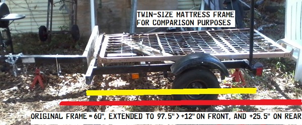

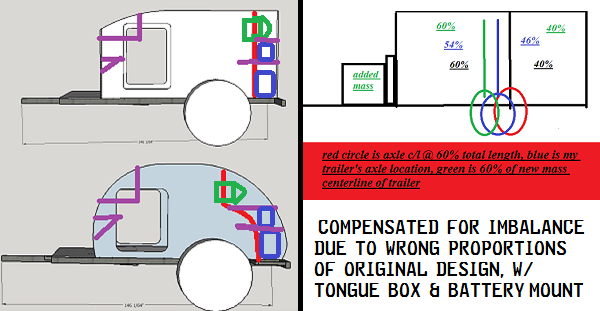

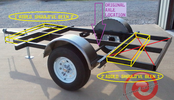

  • Months of planning, and fore-knowledge of proper trailer balance helped me get my trailer (on paper) near the magic 60/40 proportion, but, when actually constructing it, changes in details made it a challenge to get correct, especially after altering the frame proportions to attempt something different than normal. After lurking on this site, and Expedition Portal, before starting my trailer build, I thought I had a good plan to convert an old trailer frame into a simple, strong TTT, using 3/4" plywood, with a limited budget and woodworking skills. Since this was a project that was not needed at the time, but built in preparation for my retirement years (I told my wife it was for her, true if she desired it, but most likely for me, later), I had to keep the materials cost low, and only as needed at the time. And, trying to save money, I only used tools I had on hand (or at my friend's race shop home garage). That meant (for me) that I had to utilize straight cuts and no bends, since I thought the thicker plywood would hold up better than the bendable, thinner materials, and basic wood cutting tools, we both had. Plywood only, no foam or dent-able aluminum skins, and all materials to be constantly moved around in his shop, for a year, while working on automotive projects. So, I constructed a "simple" 4'x 8' TTT, hoping that it would eventually be soft-road capable, with good ground clearance, acceptable departure angle, and the longest tongue I could fit into my garage bay (12' overall length).
  • The original frame was 60" long and 50" wide, and I added rectangular steel tubing, to extend it to 97.5" long, to have room for a twin mattress, with just enough room in the galley for an on-board generator. The simple's square shape in the rear dictated the available depth of the galley, from closed vertical hatch, to the rear bulkhead wall, as roughly 22". I had originally planned to use my 6k watt generator there, but it was too big, so I traded it for a 2500 watt that would fit (and mount on a swiveling slide-out). Storage space in the galley would suffer, due to this generator placement, and the trailer balance, too.
  • I always had intended to get the trailer balance near to 10% tongue weight, favoring a lighter tongue weight than most, since I was to tow with a light vehicle, so I added more length in the rear than in front, much as the Europeans do (they use smaller vehicles, and lighter tongue weights, than here); the plan was to build the trailer and equip it first, followed by finishing it with a tongue box only large/heavy enough to balance it out. Changes in details, adding more weight to the rear than I had accounted for, and greatly underestimating the finished total weight threw my original plans & proportions out the window. The rear weighed too much, forcing more forward weight to balance, and accentuating the mis-proportioned frame dimensions' effects. Prior to finding the correct tongue box, and shifting weight forward ito it, I had 0 lbs tongue weight, dry, with no loads. The extra length in the rear was showing its' negative effects, now.
  • Slowly modifying gear and loads, and later greatly strengthening the running gear, my TTT is now over 2000 lbs travel weight, far exceeding my original 1000 lb goal. Forced to tow with my HD truck, I have the tongue weight near 15%, more conventional than I had planned, and the full tongue box, and a front rack, have brought the weight distribution to a final resolution. But, if I were to build it again, even if the materials and gear were the same, I would have kept the frame proportions at a de rigeur 60/40 ratio, rather than attempting to defy conventional wisdom.
    compensated for incorrect proportions.png (77.3 KiB) Viewed 1600 times
    my components superimposed on the OP's design; my centerline vs weight struggle
    original frame before extensions.jpg (102.23 KiB) Viewed 1600 times
    my original frame dimensions; added structure in wrong ratio
    frame extended using wrong proportions.png (409.46 KiB) Viewed 1600 times
    another view of what was vs. what should've been done
