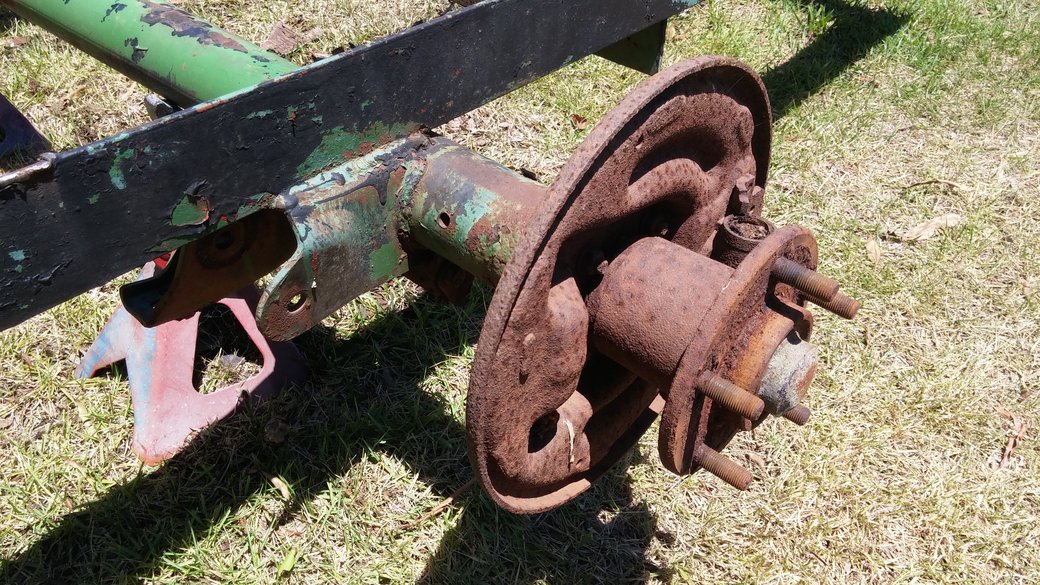

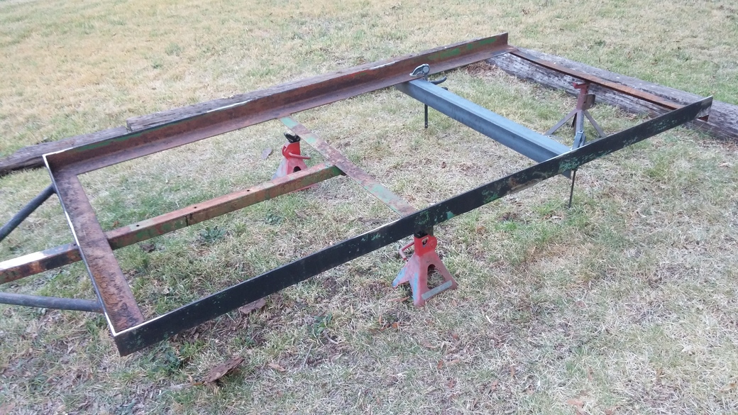

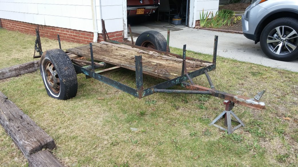

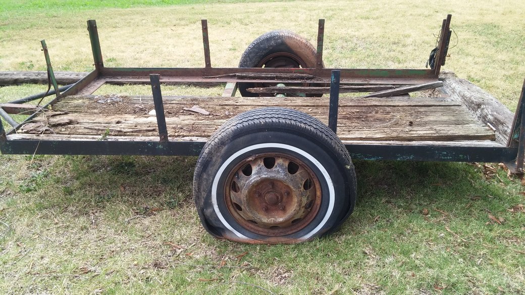

My initial plan was for a 5x8 trailer to start with, but my scavenging brought me across a 4x8 a friend had. It was in pretty terrible shape but it was mostly there and a decent place to start. Not to mention the price was right, only $20! I quickly paid him without hesitating and my 5x8 plan was out the window, but I'm happy with the 4x8. Here's where I started....

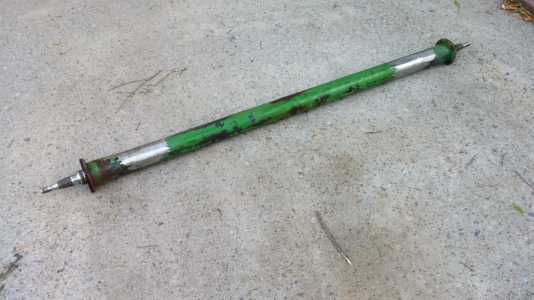

Postby JackieK » Wed Aug 23, 2017 7:27 pm
It's not pretty but the potential was there. It's an old homebuilt trailer, all the welds look professional. Whoever built it knew what they were doing, the axle is out of an old 70's oldsmobile. My main problem with it was that the axle was welded right to the frame. Not ideal for a smooth ride, so it had to be cut out. Which was easier said than done. But after hours with a angle grinder, saw zaw, hacksaw, die grinder.... it finally fell! I also had to cut of all the side supports as they will not be needed. I decided to go with 2000 lb leaf springs so the hangers had to be welded. It also needed a little more bracing on the back half so a new piece of angle was also welded in to help.

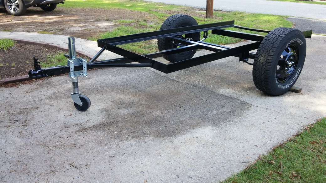

Postby JackieK » Wed Aug 23, 2017 7:37 pm

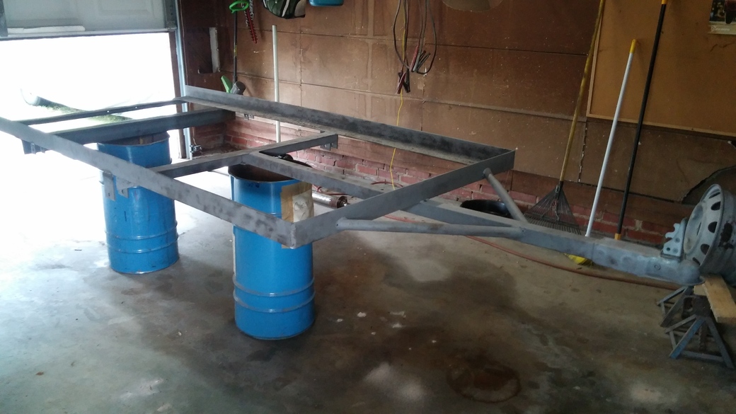

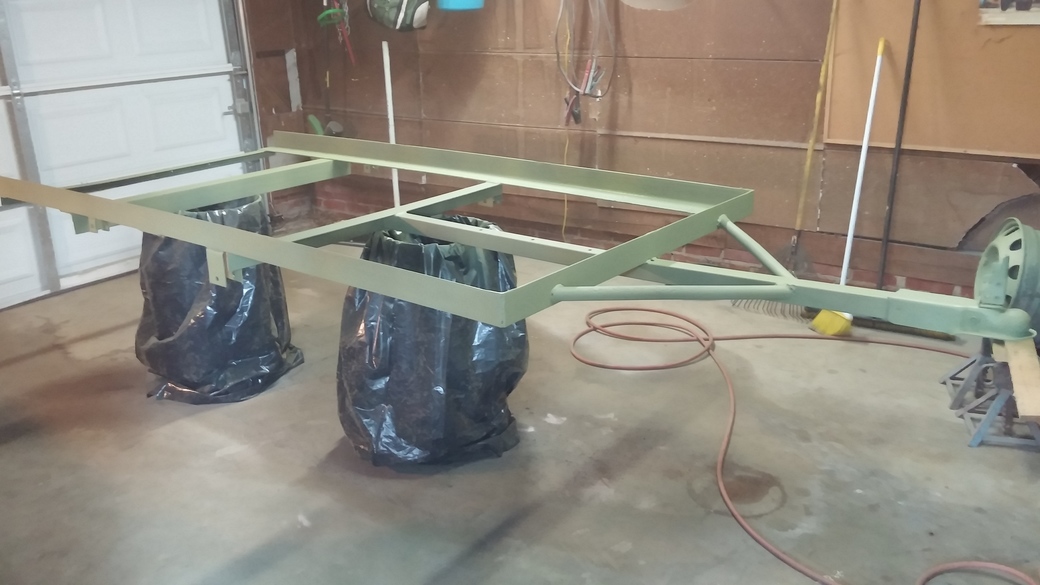

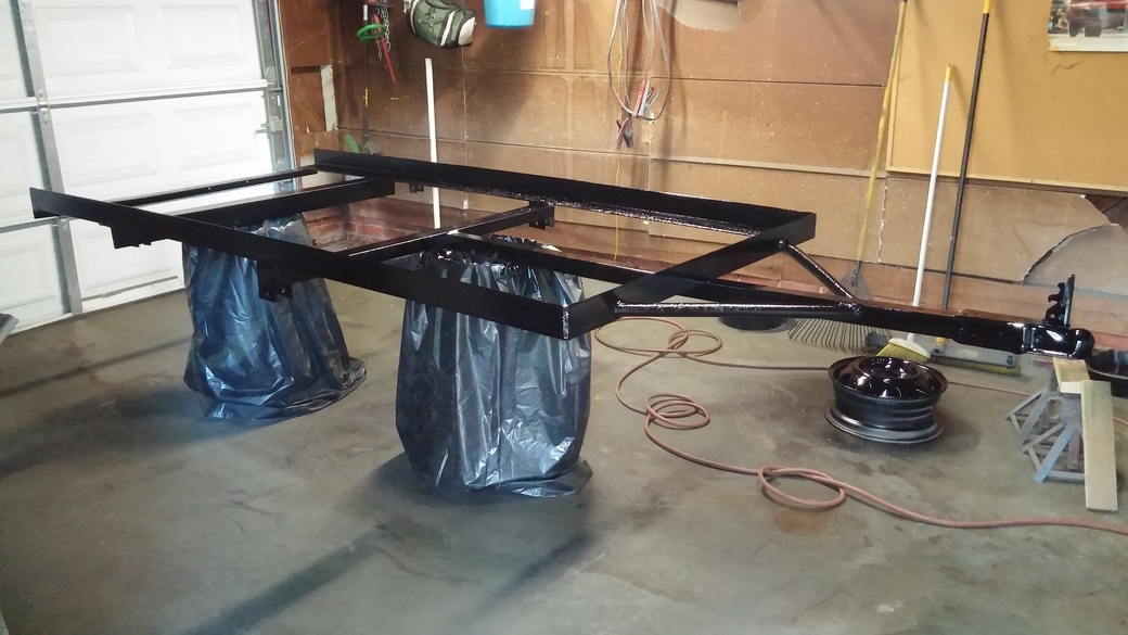

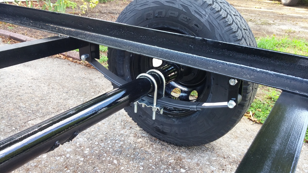

My next step was to sandblast everything. The whole trailer had several coats of paint on it with the top layer being some kind of latex house paint...yuk. So after blasting everything was etch primed and painted black with durable 2k urethane(I work in the coatings industry so most of my paint and what not is freebie stuff!).
JackieK
Posts: 18
Joined: Mon Aug 21, 2017 5:05 pm
Location: Kannapolis, NC
Re: Newbie Build in NC
Postby JackieK » Wed Aug 23, 2017 7:46 pm

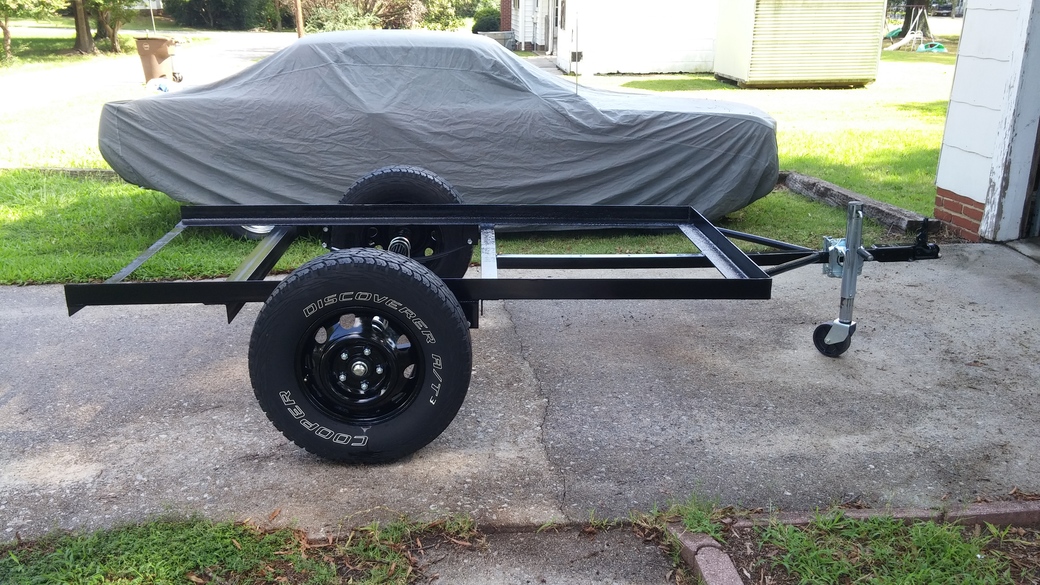

Then it was time to reassemble! The hubs got new bearings and wheel studs, also got a free trailer jack from a friend. Came across some cheap used cooper tires the size I was looking for. All in all it turned into a pretty sweet deal, I spent $100 at northern tool for the springs and all the hardware, about $120 for the tires, and with other odds and ends the total cost is around $300. I'm currently in the process of getting a title, registration, and tag. I don't want to go much further before I do that but I'm on my way!

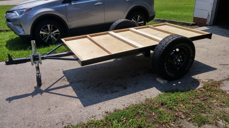

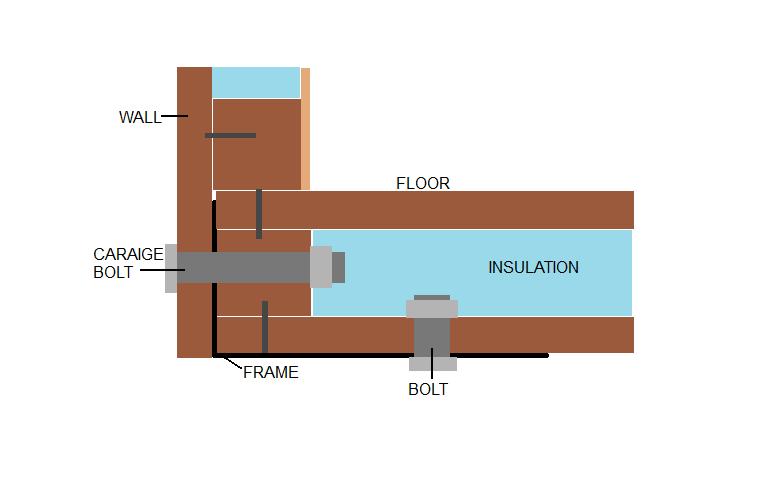

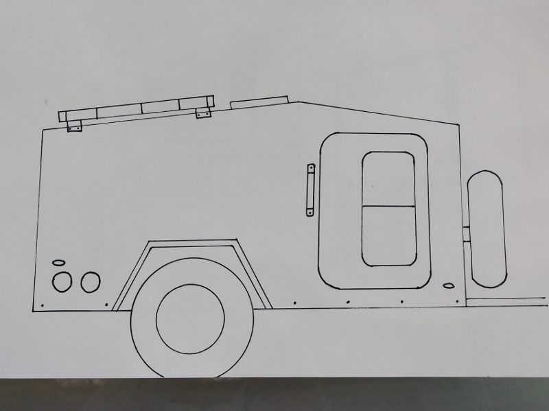

So first was to build the floor, not a very complicated task but with the angle iron frame it did require a little thought as to how the floor and walls would be attached. I decided that the floor would lay inside the angle and walls would attach to the outside. I made a simple diagram to illustrate the idea. I also made a quick simple drawing to scale for the shape I was going for. I installed the floor after I gave it a few coats of asphalt paint to seal the bottom.

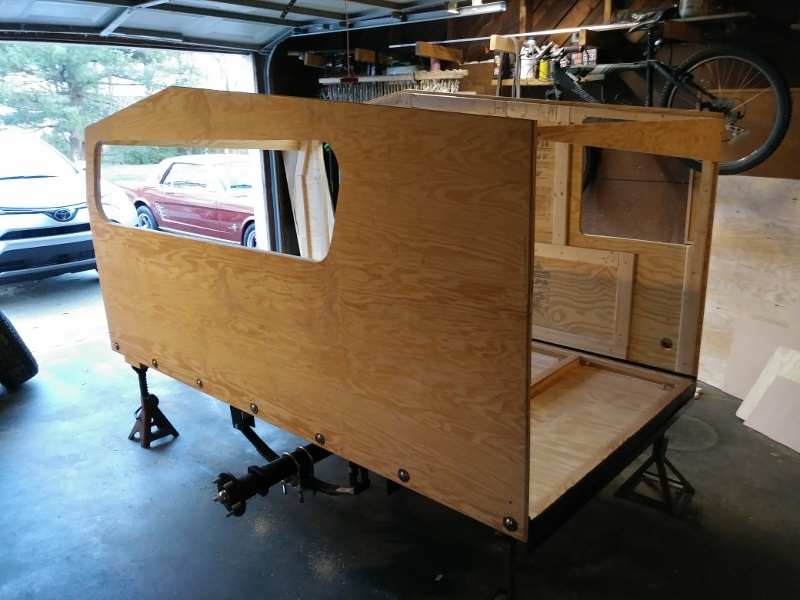

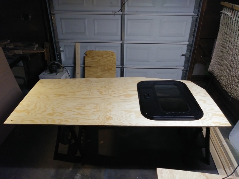

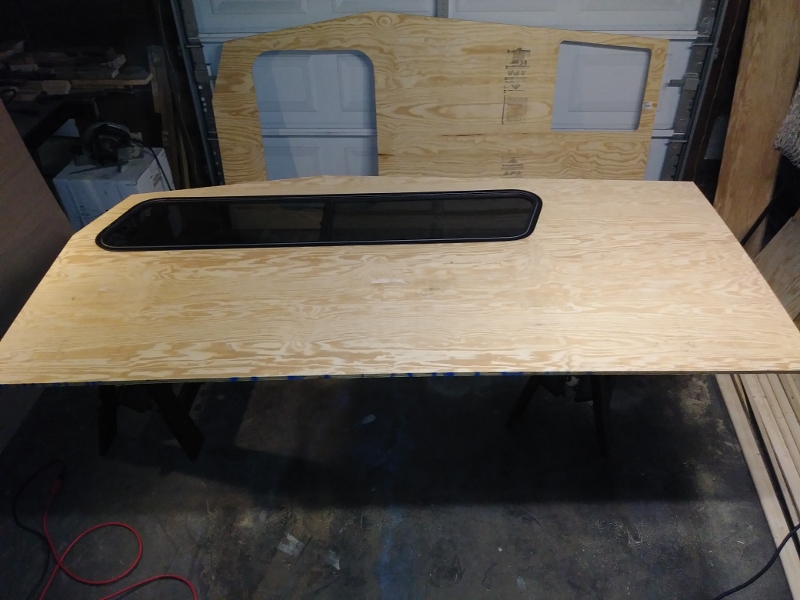

Next was on to cutting out the wall profiles, I used 1/2" plywood for the walls. I got a free window out of a truck camper top to use for one wall. Its a little longer than I would have hoped for but I can make it work. I revised my side profile just a little to match the window shape. I also bit the bullet and bought a vintage technologies door. I just figured it would save me a lot of time and hassle, and in the end I'm glad I did. I also plan on adding some access doors at the back for a storage area where the galley might usually be on a traditional teardrop.

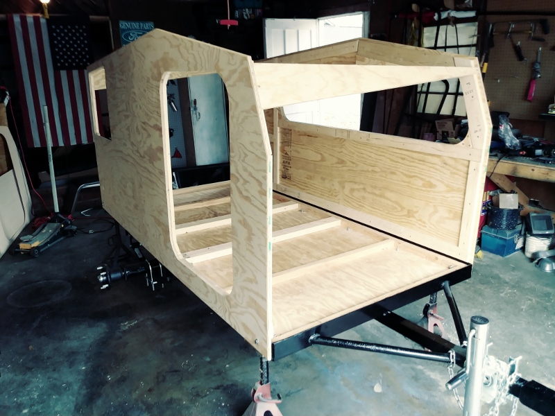

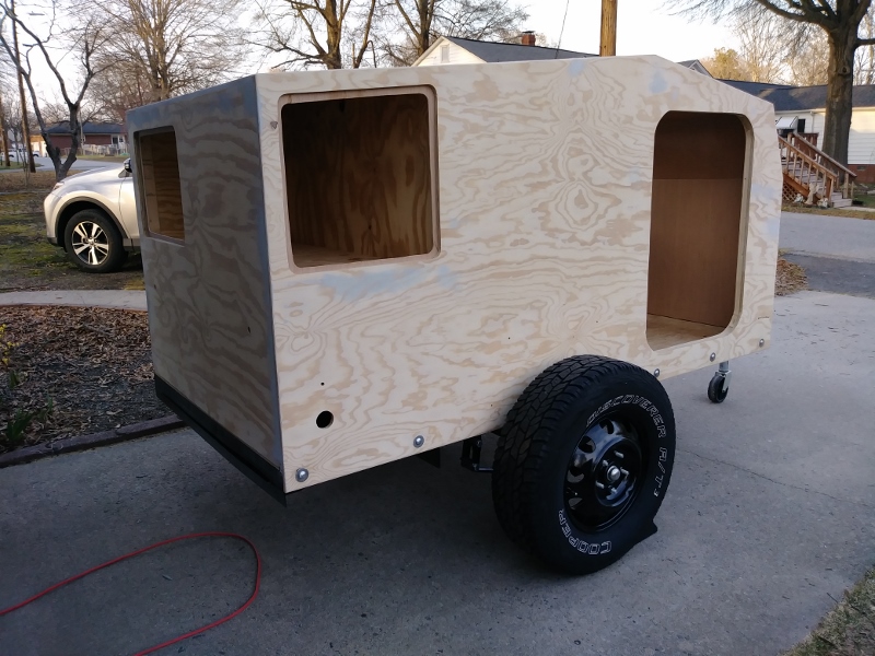

After the walls were cut then I moved on to framing, I used 1"x3" boards for that. Then I attached the walls to the frame with carriage bolts like in my diagram. I used wide fender washers with the carriage bolts and ran some sealant on the back side so no water would seep in.

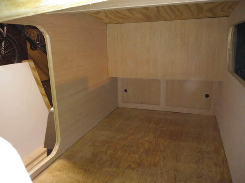

After I got all the walls in place I insulated them. The floor got 1.5" insulation and the walls and roof got 3/4". Then once the insulation I moved on to skinning the inside walls with 5mm plywood. It's real thin stuff sort of like paneling. My galley area will not be used as the standard kitchen setup, it's main purpose will be storage. The top section of the galley is accessed from the outside of the trailer(more on that later) and the bottom is accessed from inside the trailer. I rigged up some sliding doors on the inside to close off the storage area, it will mainly be used as a place to store your shoes, bags, etc... Here's a pic of the inside so far.

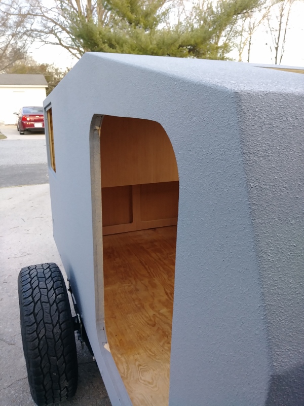

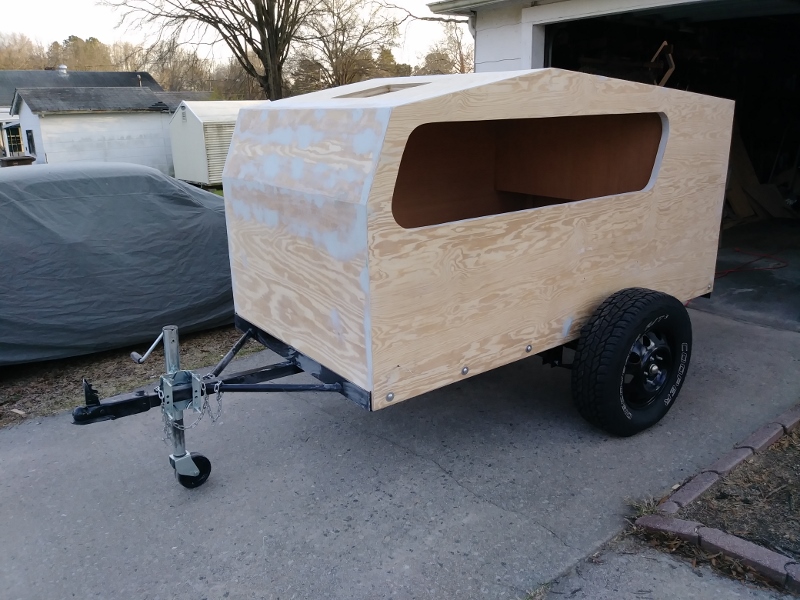

Finally starting to look like something! I decided to coat the outside with a spray on bedliner, like I said before I work in the coatings field and I've seen this stuff sprayed on all kinds of stuff. It made perfect sense to me to spray my trailer with it, it's a super durable coating that seals up the wood nicely. It means that I could also just round over all the corners and not have to worry about any trim at all. So I started to prep it by filling in all my screw holes and seams in the wood with a little bondo just to smooth it out. Here it is ready to be sprayed...

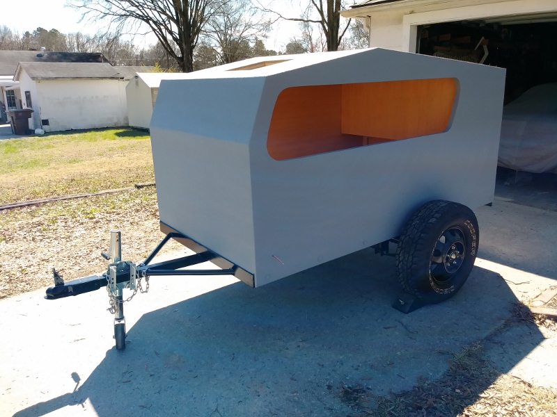

Postby JackieK » Thu Apr 12, 2018 7:50 pm

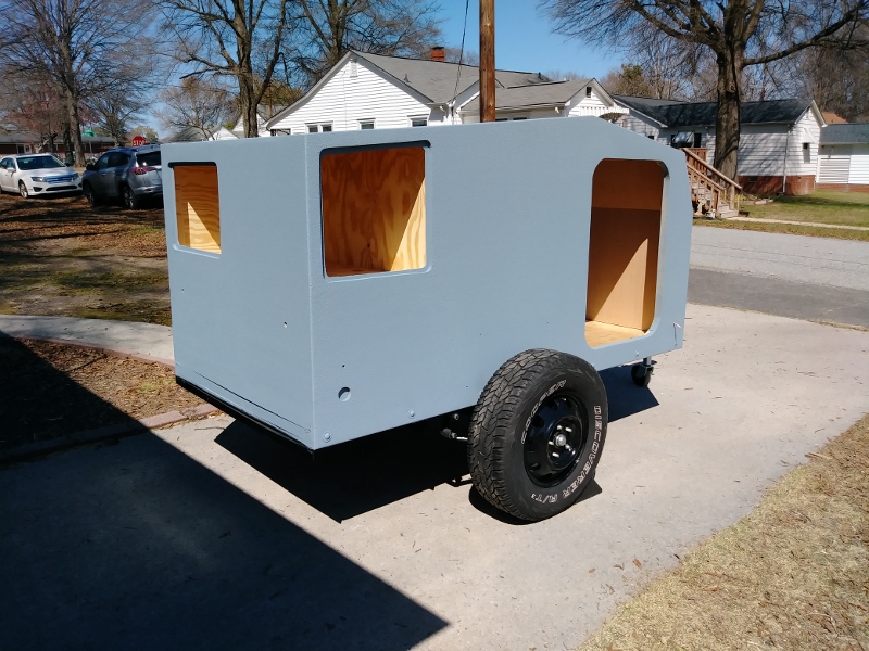

And here it is after spraying! The bedliner can be tinted any color you want, I went with a bluish gray almost like a battleship gray. I thought it would look decent with my silver Toyota. At this point everything has been fitted and should go together smoothly.

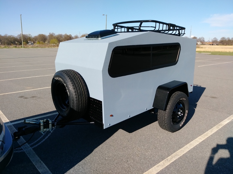

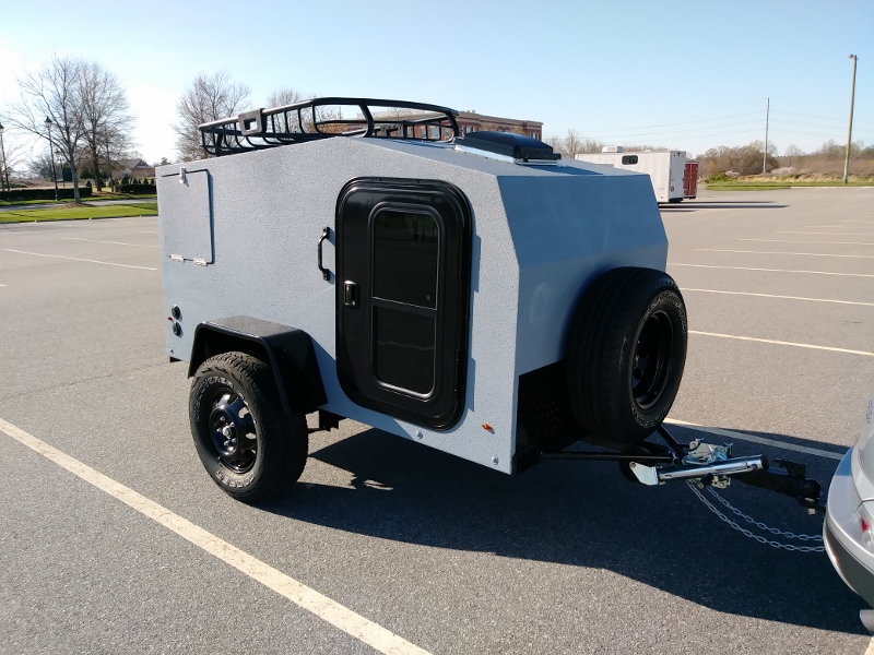

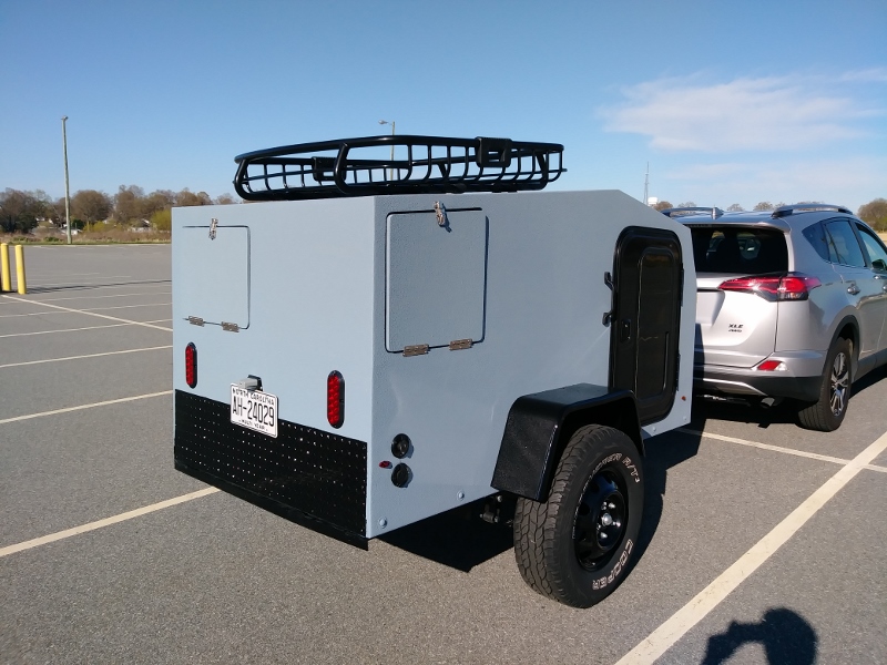

The first drive around town!!! I know this looks like a big step forward from the last post but I was so excited and busy with the progress I forgot to take pictures. So I'll try to talk you through what I did. Of course the door and window were screwed in, the rear access doors were installed. I bought some jeep style fenders along with some diamond plate(just to give it some class) both had to be painted black. I bought a roof rack, vent, and lighting kit on ebay. Also mounted a spare tire at the tongue, it was mounted using a scraped bracket I found laying around and a 6" bolt. I also added a power plug in on the side along with a input for cable tv. I'm going to take some more detailed pics soon and more on the interior also. But I'm super pleased with the results so far!
