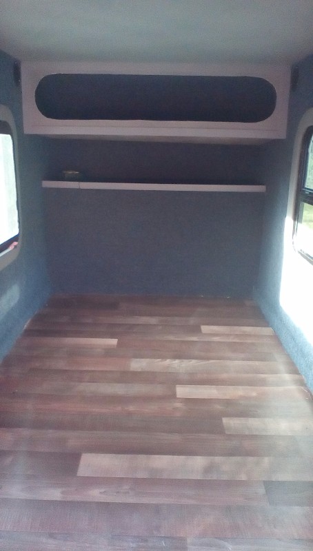

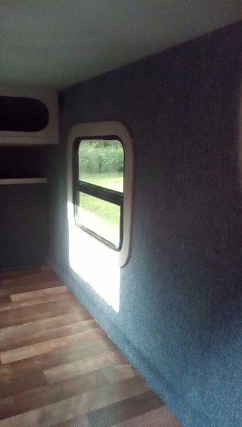

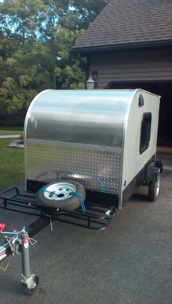

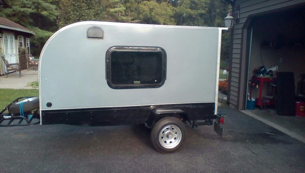

Postby greygoos » Wed Aug 30, 2017 7:32 am
4 X 8 simple sleeper. Welded tubular frame, 1/2 inch plywood walls skinned in painted aluminum, roof constructed with spars and FRP, and skinned with polished aluminum sheet. Forward interior storage and shelf. Cabin walls are blue carpet with gray
.headliner. Floor is vinyl. 2 large windows, drivers side is emergency exit. AC electric with breaker and Marinco inlet. Large rear door with overhang. Bulldog jack, galvanized tires with spare. Forward luggage rack. Rock guards all around.

Postby Wildfire » Wed Aug 30, 2017 9:44 pm
Looks great. What axle did you use?
Wildfire
Posts: 30
Joined: Sat Jun 03, 2017 6:09 am
Re: New Square Back Finished
Postby greygoos » Thu Aug 31, 2017 5:43 am
It is built on a Yacht Club trailer with new wheels and tires.
