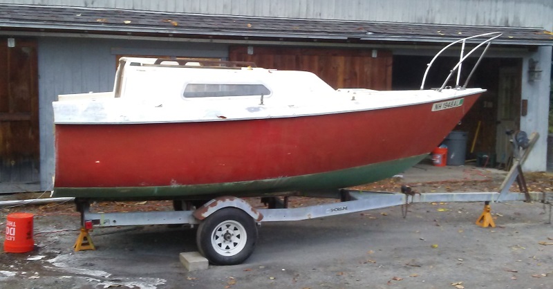

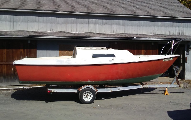

I found a cheap trailer with awesome potential on Craigslist the only catch was I had to take the 22 foot sail boat strapped to it. As I was towing it home I got to thinking that the sailboat cabin was exactly what a camper trailer is supposed to be, just wrapped in a boat. So I am going to attempt to turn the boat in a camper. Worse case scenario the idea fails and I cut it up and throw it out. I would have to do that anyway so why not try to re purpose it first.
Kells 23 Sailboat before surgery

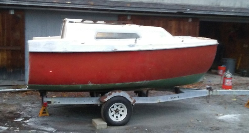

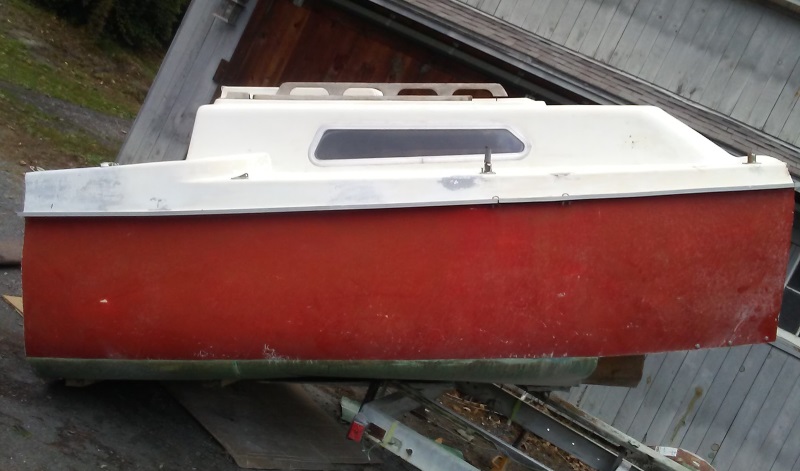

Took about 6 feet off the back
And a little off the front.

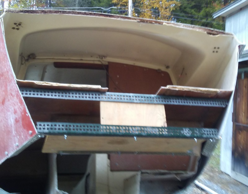

Who would have thought that a 1900 pound boat has a 600 pound kick up keel hidden beneath it? I lost a day fighting with that giant chunk of iron but I won. I have decided to start at the front and work towards the back. I am cutting the boat at the water line and using some angle iron to to frame it out as I work back. I will lose a few inches off the floor, but it will give me a flat bottom while keeping most of the interior fiberglass cabin. I am not sold on the sanity of this project yet, but I am still having fun.
Side View you can see the front where I have started to cut at the water line.
Front View basic frame concept seems sturdy enough.

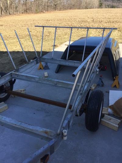

I scrapped the boat idea. I got it cut down, and reinforced, but I was not happy with the interior space. Not enough head room and the door was less than ideal. I thought about trying to save parts of it, but I figured if I was gonna work that hard at it might as well go back to the drawing board.
Basic idea is to drop a truck cap on to my trailer and call it a camper. I got the cap on craigslist for $100 am using 3/4 emt conduit for my frame. The welds are ugly but 3/4 emt seems up to the task.
