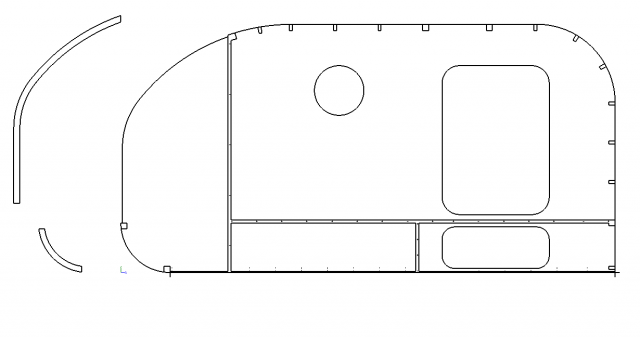

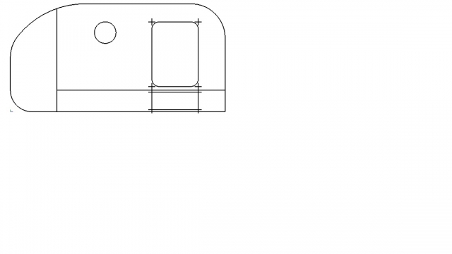

Postby soapcreek » Mon Jan 29, 2018 9:26 pm
Where has January gone? I'm no where near where I need to be on my other project but it's time to put it on the back burner and get started on this Benroy if I have any hopes of getting some use out of it this year. I finally spent some time taking my scratch drawings and building a formal drawing. I converted my cnc plasma table into a router table over the weekend. This will be my first time using it setup with a router so there will be a learning curve. Plan is to cut out some saw horse pieces for practice before turning myself loose on my side walls. At this point it could be total success or complete failure. The journey is half the fun anyway right.
So the plan...
1) Roughly 5x10 overall size
2) Bottom 12" will be storage. Back half of storage accessible from within the cabin. Front half accessible from exterior baggage doors. Divider between.
3) Sidewalls will be made of 3/4" ply with pockets milled for 1/2" foam insulation (not shown in drawing). 1/4" Interior cover to be decided. Overall thickness of 1"
4) Door will be 26x36. Set 15" from the front
5) 12" Diameter Port Style Window
6) Galley is 26" deep at its widest.
I hope to get time to cut & build the saw horses this week. That will educate me on which path I'm heading down with the cnc(success/failure). Anyways, let me know what you think of the drawings so far.

Postby tony.latham » Mon Jan 29, 2018 10:21 pm
Soapy:
Your head's cranking away!
I would be concerned that your door might be so far off the ground it may be somewhat of a chore to get into. :thinking:
Re: SoapCreek Adventure Trailer
Postby KCStudly » Tue Jan 30, 2018 11:44 am
... and perhaps (the side doors) too far forward. Search for discussions on the "sit and spin" method of entry.

Postby soapcreek » Tue Jan 30, 2018 11:33 pm
Made a little more progress on the drawing. Overall door & galley height off the ground once you throw the trailer into the mix does have me concerned. I'm far enough that I'm confident the overall width and length won't change so I can progress with my trailer build. Once I have that complete I'll determine if my planned height will work for me or not. The front edge of the door has been adjusted back to 16" from the front. I'll see if I can find myself a large enough piece of cardboard to make a template to verify my sit and spin activities can be performed comfortably.
