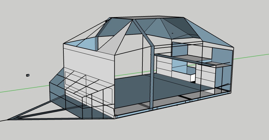

the sketch below is a bit hard to see, most of the panels are not filled in, so imagine it filled in solid. The tongue box will be a box, but this is the cage design my son likes. on the rear wall, a drawer is pictured as open - they might open towards the middle of the camper. Also pictured is a fold down desk/bunk(?) that might go on top of the shelves.

How big will that deck be? Will it be large enough to be worth the effort? Maybe you could design a deck that stores under the floor. That at least would be large enough for two to sit on.

under the floor... yes. i have given it about five seconds thought but yes, i like that idea. the deck as door thing makes a very small deck... ummm, fun design challenge. adds a little more protection underneath but also less clearance. ummm, i suppose i can go all the way to within a few inches of the axle... and have it the width of the trailer.. if i can figure out how to slide it out easy, with some feet that fold down. I am also liking the idea of doing a back door as a back door and not worry about also making it into a deck.
This would allow a chair or two, two people on it, as we are hanging out at camp. A weight penalty and a deck is nothing i would think of putting in, but under the floor might really work for us.
Thanks.

How about some metal C channel welded or bolted to the frame. We did that years ago for a ramp for a motorcycle trailer. The ramp (deck in your case) was 5/4 cedar deck boards with 2x2 stringers to screw the deck boards to.

Setting aside the fact that I don't see a deck as being a practical camping accessory, I suggest that you include a ramp gate in your trailer purchase and convert that into the "deck". Keep the entry door separate so that you can focus on making it water tight.

you could weld two receivers on the back and have two 6 or seven foot beams to stick into the receivers with small jacks under the floor at the far end of the deck.
the floor could be hinged and stowed on the roof on a rack.

Years ago I used a utility trailer for a work trailer. I made a raised floor in the trailer of 6" and under the floor I created a roll out. When the trailer was full of cabinets to be installed I needed a work platform. Constructed a pull out work platform. That was 5' wide and 10' long. I made the roll out, using angle iron, garage door roller rails and garage door rollers. With 3/4" ply for the top.. it was strong enough to set my 10" Bosch table saw on and a Dewalt 12" miter saw with stand. With a couple jack stands under it.. it was very stable...
This could also be done under a trailer. Plywood would have to be sealed really well..
Something similar to the following:
https://www.carid.com/cargoglide/bed-slide.html?gclid=EAIaIQobChMI7JnUh_Wv2AIVD7XACh1vSw23EAQYASABEgJ6WfD_BwE
There's a couple videos on the right side of the page. That might give you some idea of how I designed mine.. same principle..

Thanks for all of your advice. All good ideas. Certainly I would never go through trouble to build a deck for any practical purpose other than to fill my son's wish. I like the idea of using the back gate of a trailer. Thought of that earlier and might just do that if i run across the right trailer for sale.
Welding a c channel might be where we go with this. Seems to be a pretty simple solution, without too many moving parts.
I also like the idea of two receivers welded to the back to slide the deck out onto and then fitting into, rather than just have the end of the deck sitting in the channel. jacks would be a simple solution for keeping the far end up. I hate all of the weight i will be adding to this.. but also with the c channel, i can choose to leave the deck and jacks at home and only have to haul around empty channel on the bottom of the trailer.
The cargo glide might be the way to think of the deck - have some way for it to be more of a glide with wheels rather than a dragging through channel. Umm, could even be some small wheels recessed into a torsion box deck. would glide out, or roll out but not make the deck too thick..
thanks for the ideas. every day in the planning process seems to have a different theme. today i went back to thinking through skinning ideas, still thinking of canvas and glue but thinking covering all of the roof panels with their various angles will be a pain.

Covering the flat areas will be easy. The joints can be then covered with 6 or 8" wide strips at the corners like shingling a hip roof on a house.
The real problem I see with a hip roof is door height. How tall are the vertical sides? My door is 28" x 42" which is fine but I wouldn't want it smaller. You could make the back flat and put the door there.

Never lived in a house with a hip roof so was not thinking about them. thanks. did some research into hip roofs and that is kinda what i got going. i put a ridge cap on our metal roof, so i could think of the seam coverings in similar terms - a bunch of ridge caps...
the side door heights is an issue. there will be a back door, but i do also want two side doors, i go from envisioning pretty normal side doors purchased or making some custom pretty wide doors. The side wall height as it is now will be 3' tall. vintage technologies has a 26 by 36 door, so even for this door i will need to tweak my side wall just a little bit. So if a 36 inch high door is tall enough, i will be able to fit that in with roughly the design i have now. But i do think i would like a taller door, i would appreciate (in my imagination) not hunching to get in and out too much. Just not sure if 36 inches high would feel just fine for me or not, when i am up 2 or so feet off the ground, on a bed etc...
The door height, and where the door will be located because of where the wheel turns out to be, is something i will keep coming around to examining i am sure.
