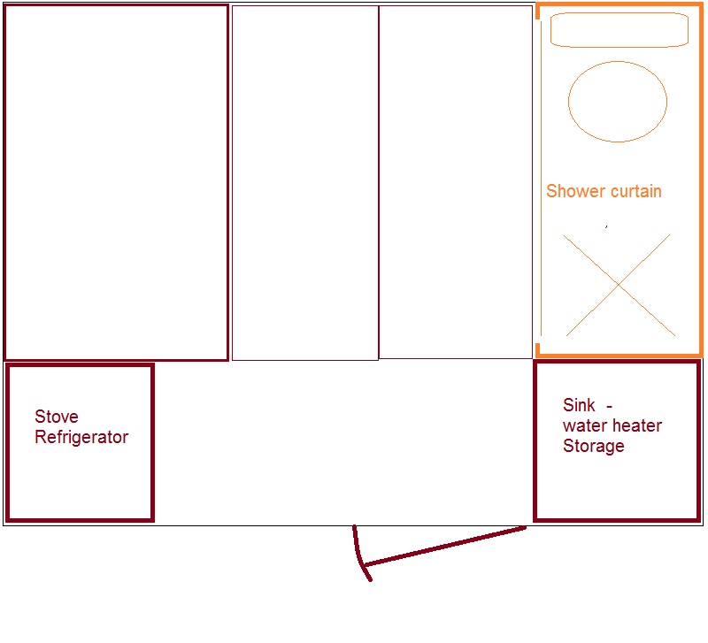

Postby jbell.louisburg » Sun Feb 18, 2018 6:55 pm
Ever considered something other than a dinette? If so, it opens up lots of possibilities.
If I were forced into a 6x8, and "had" to have a bathroom, and ALSO "had" to have a kitchen....
I'd either do a trifold like this:
https://www.birchlane.com/furniture/pdp ... e=hotdeals
or possibly a 72" jackknife sofa on the far wall (takes up the same bed space when folded out)
https://www.wayfair.com/furniture/pdp/a ... s2189.html
It would give you a sitting/eating place when folded up, and a bed when folded out.
Because the bed buts up against the shower curtain, you could let your feet hang off the end.
Splitting the kitchen into 2 pieces also helps.
Kinda like this:

Postby nik1093 » Sun Feb 18, 2018 8:51 pm
jbell.louisburg wrote:Ever considered something other than a dinette? If so, it opens up lots of possibilities.
Kinda like this:
I was playing around with a sofa bed type deal but it leaves less usable storage space underneath. A dinette, only requires that about 2 feet squared has to stay empty under the bed. Also, the bathroom would be difficult to access with the bed extended. I was thinking the only things I don’t need with the bed out would be the stove and the table. Also, the drawing you have puts the stove on the short end of the camper. I could change the shape but I didn’t want it to be that tall at the back.
Thanks for weighing in on my problem.
