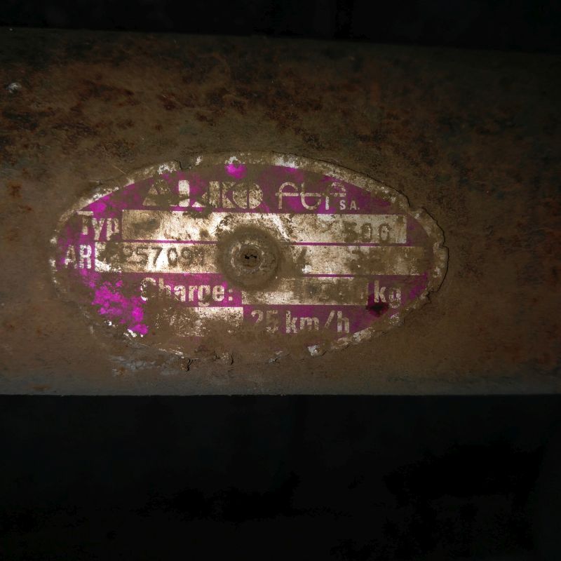

well slow day today almost downed, by a little metal plate.
alko plate.jpg (79.58 KiB) Viewed 1822 times
the alko axel is a 1/2 tonne, the original plan called for 6mm ply inner skin, celotex insulation, 75mm spars and a aluminium outer, polycarbonate windows, and aluminium framed doors, with the weight of the chassis this would take us to 500kg still within our 750kg theoretical un-braked class maximum but now its easy to go over our axel weight, if we add say a mattress and spare wheel.

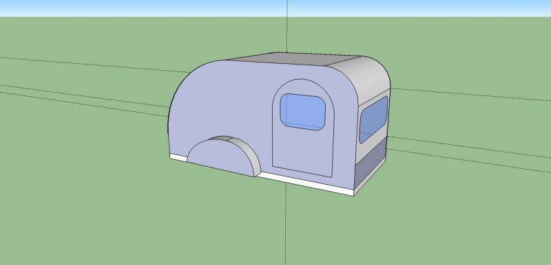

So this is now the plan
traditional benroy shape
single outer skin 6mm ply incorporating one door each side with polycarbonate windows, woven glass reinforcement on all the seams.
construction method stitch and glue.
insulation 3-6mm close cell foam possibly fabric coated as an interior liner.

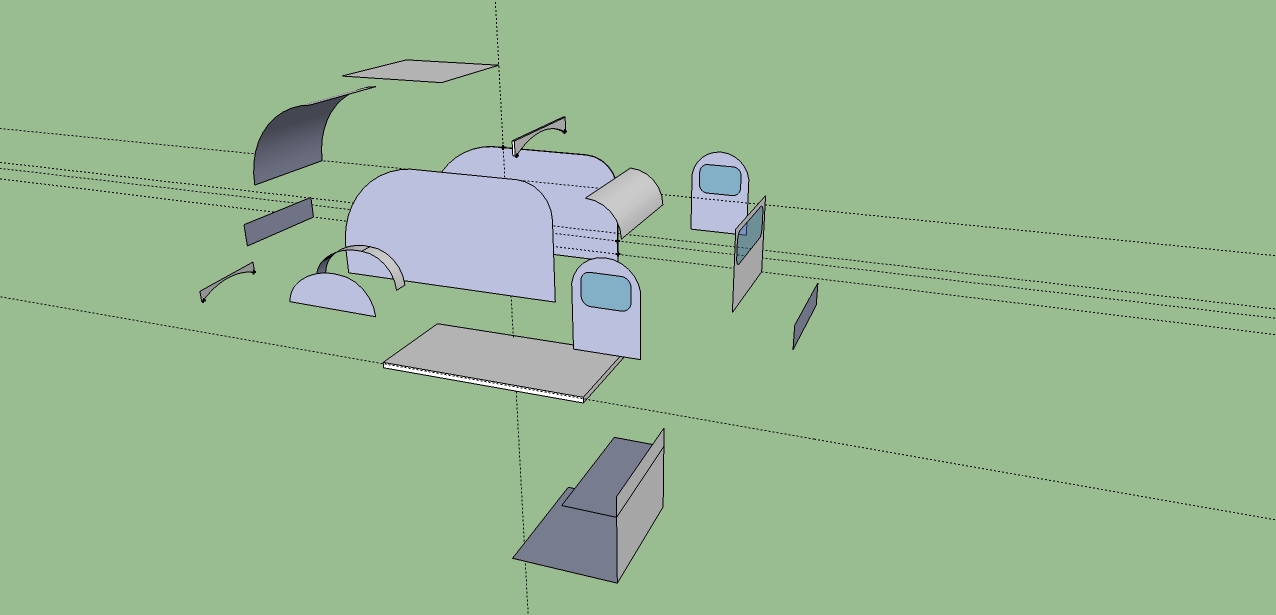

sarahs tear assembles.jpg (16.59 KiB) Viewed 1731 times
sarahs tear exploded.jpg (143.73 KiB) Viewed 1731 times
All the time was mostly spent in planning and ordering.
First was the H13212TAE (Encore 30) Lloyds GP Resin 25kg a general purpose resin is used by professionals who require a top quality, pre-accelerated, thixotropic, orthophthalic resin suitable for a wide range of applications LLOYD’s Register of Shipping approved.
Manufactured by one of the worlds leading producers of resins, it is formulated to provide high quality mouldings whilst keeping styrene emissions low, allowing a better working environment.
Comes in a range of colours I ordered clear, I can add all sorts to it was contemplating a silver mica I will have to play with that.
Then the wood.

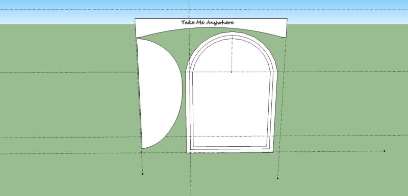

cnc sarah2.jpg (20.77 KiB) Viewed 1731 times
2 of each from a 25mm sheet, the wheel covers door surround and a bracer / decoration for the front.
oh and getting sketchup to output a dwg file after your trial has expired...pain in the neck but i found a solution from NB70 on github sketchup-dxf-stl-exporter

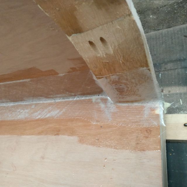

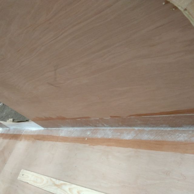

153893
153892
discovered the aerodux glue is excellent at bonding the sides to the base, shirts to trousers and dirt to hands, there is no cleaning method. discovered this after master Wright spent 15 minutes trying to unglue his cup of wet smoked grass from his hand.
