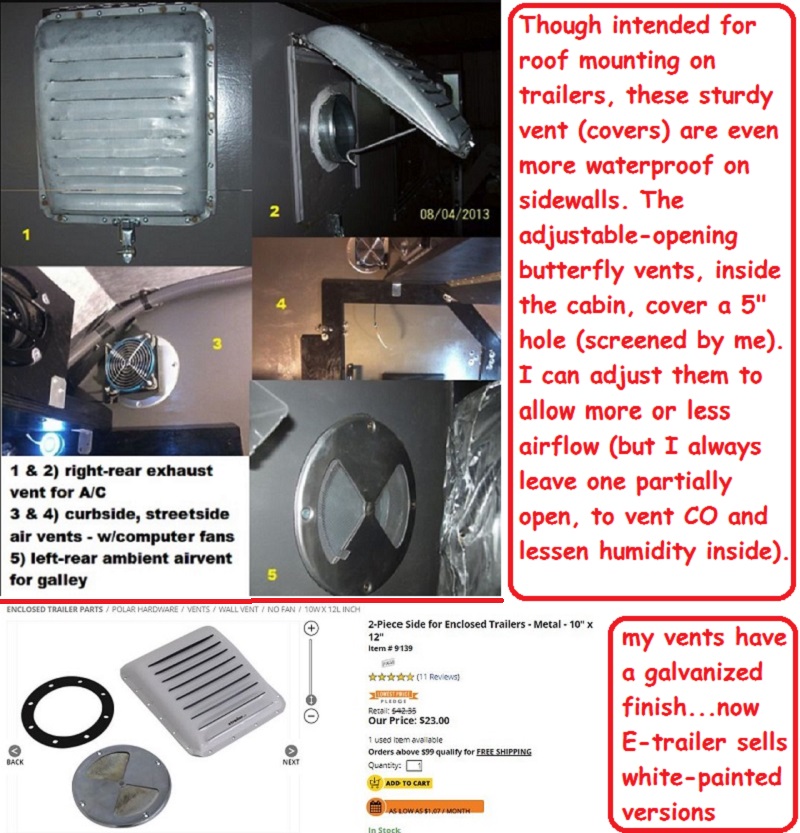

  • ***I kind of dont want to use a roof vent/fan
    **** one door and 2-3 windows
  • ***,****I used vents placed on the sidewalls, instead of on the roof, and used computer case fans to assist in airflow, but I usually prefer using my 11" fan, and two open awning-style windows for ventilation, during pleasant weather (the awning windows and the "waterproof" side vents don't allow any rain in). See: http://www.tnttt.com/viewtopic.php?f=21&t=70100&p=1225933#p1225827
