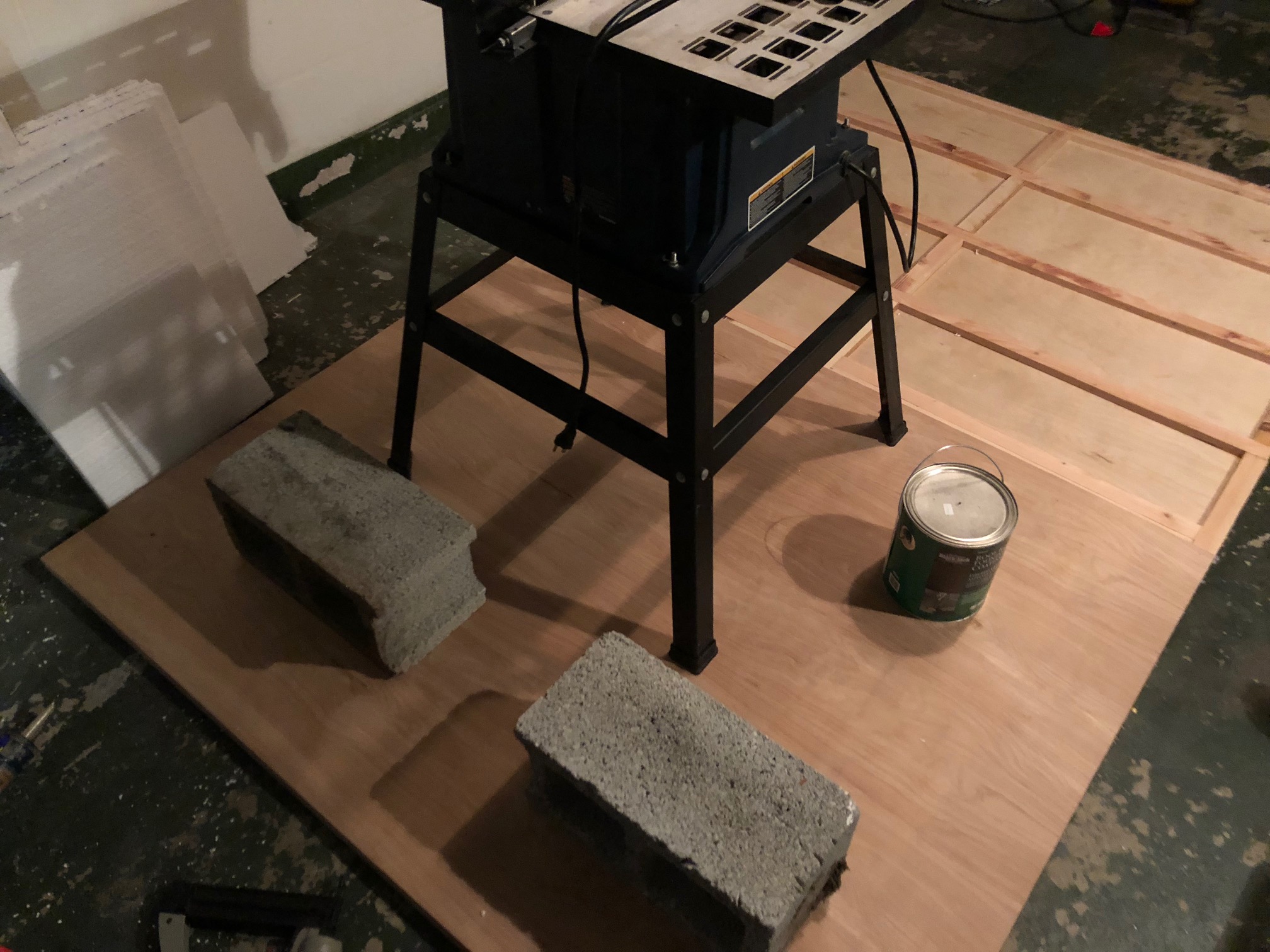

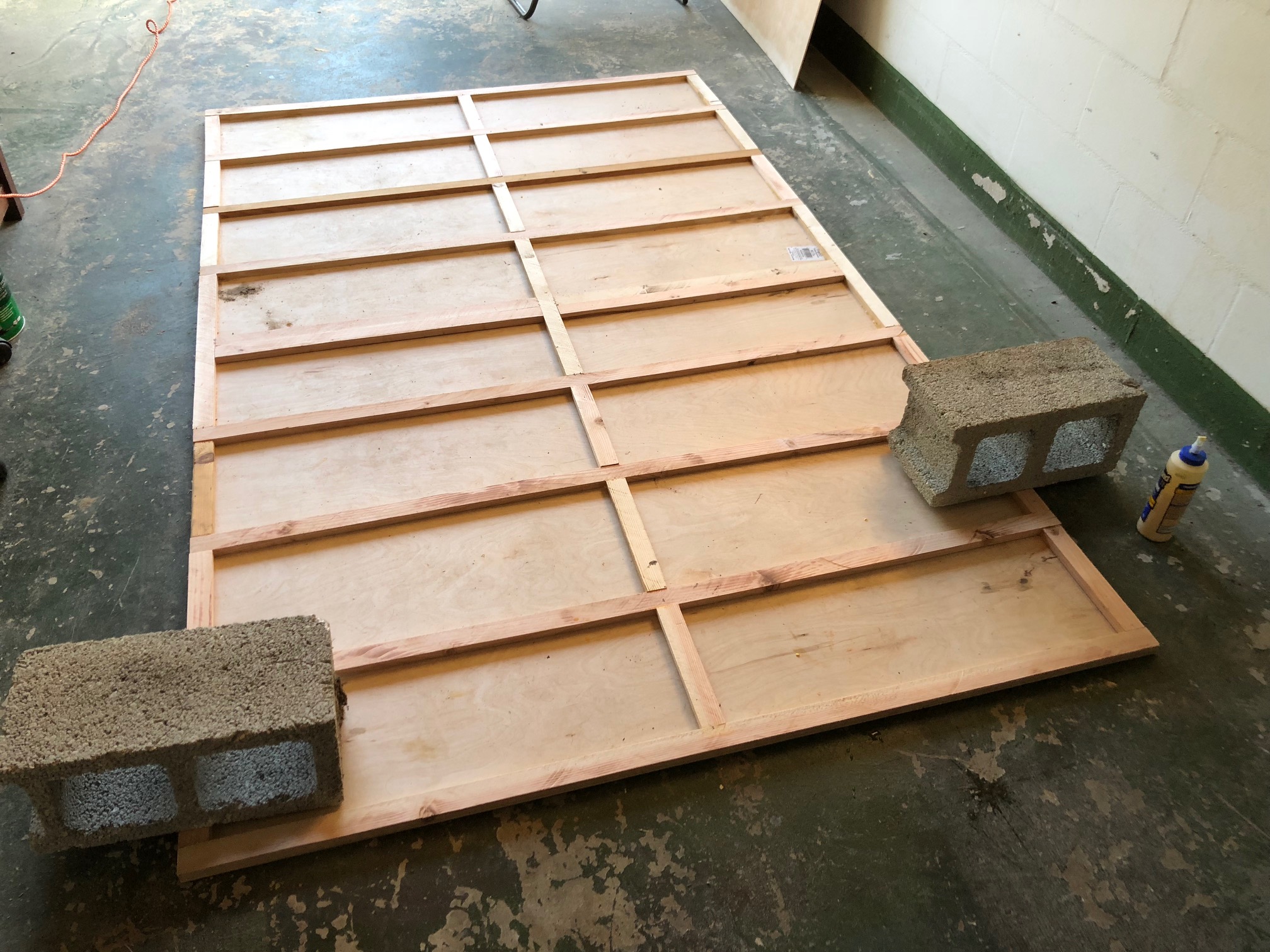

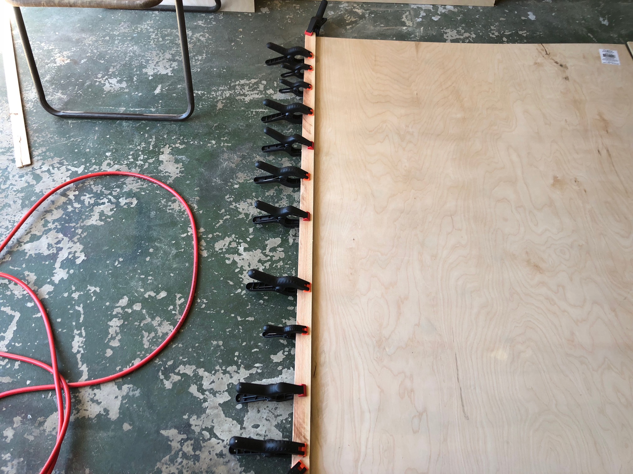

Hi all. After 8 months or so of sifting through this site and YT videos, I've started my build. I haven't settled on exactly every detail of the build, so it will probably be a design as I go project. I'm leaning towards a Runaway type design, as I like the look of those campers. I purchased the NT 5x8 trailer and have already assembled it. Yesterday, I began assembling the floor. I decided I was going to make my own 1x2's ripped from 2x4's, in an attempt to get the straightest wood possible. After a lot of ripping on the table saw, my conclusion is, there is no such thing as straight wood. :roll: i assembled the framework and used 5mm underlayment. I am impressed with the look of this wood and may use it through out the build. :thumbsup: the 13.98 price tag is appealing too! :D Used 3/4" foam insulation. You guys worried me enough about condensation issues, that I ditched the idea of just a 3/4 plywood floor. So, the entire camper will be insulated. :twisted:

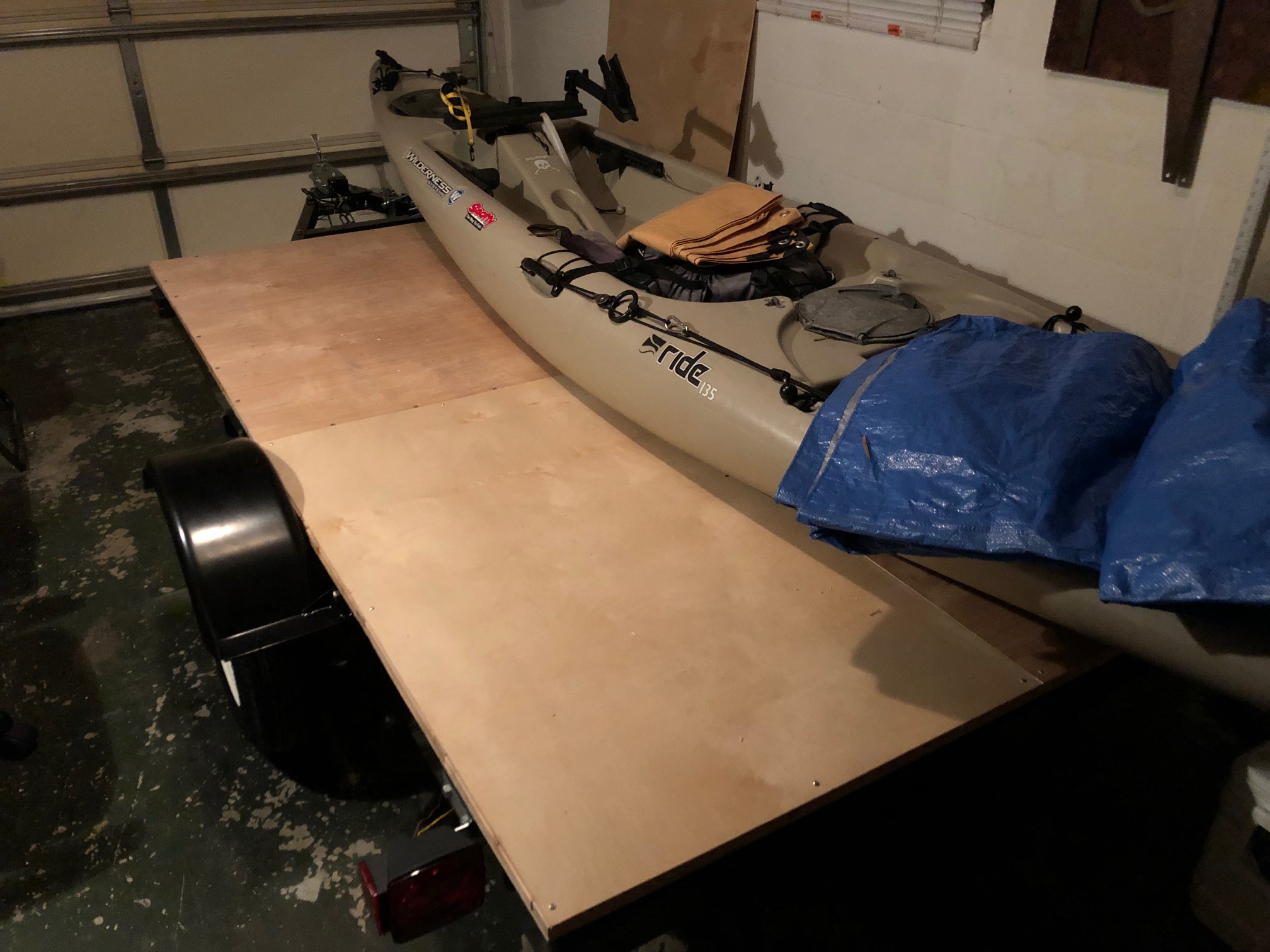

Finished insulating and skinning the floor today. I also installed the 1/4” furring strips, that will sit on the frame cross members. I then, squared the floor to the frame and clamped it. I used a rubber mallet to tamp the floor over the frame bolts, to mark their location. I flipped the floor and used a 7/8” Forstner bit to drill pockets for the frame bolt heads to rest in. Flipped the floor again and positioned and clamped it. Crawled underneath the trailer and marked bolt hole locations. Rain was coming, so I called it a day. Tomorrow, I’ll begin coating the bottom of the floor with roof and foundation coating. Here’s some pics from today.
