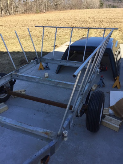

I figure I should document my mess so others can learn from it, as I have learned from so many of you. I have been making this thing up as I go along and while I doubt it will win any beauty contests it will be functional...I hope.
The trailer I got off of craigslist for $100 it came with a sail boat. I am still slipping pieces of the boat into the dumpster at work, but the 600lb steel keel and the aluminum mast and rigging got me $74 dollars at the recycling center so if my time is free the trailer only cost me $26... at least that is how I pitched it to my better looking half.
The truck cap was another craiglist score It cost me a $100 all the windows and screens are good, I am trying to sell the back window from it as it is unneeded for my build and if I can find it a new home my truck cap might not have cost me a thing.

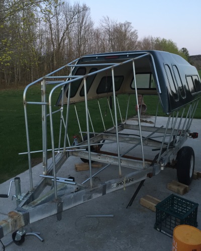

The frame has been constructed with 3/4 EMT conduit for two main reasons 1: Its cheap and 2: its easy to come by. I did a lot of interweb research before deciding on this modern marvel of Diy construction material. I had my reservations about it, but I found some forum for backyard air boat builders down in the everglades and apparently it is the material of choice so I gave it a shot. Now that my frame is done aside from a few minor bits I have no worries about my choice of materials...my welds on the other hand are a different story.
The welder is a $89 Harbor Freight Special that by all accounts is the worst welder ever built, but I may be the worst welder ever born so it works out well.
The frame under way
Cap on Frame

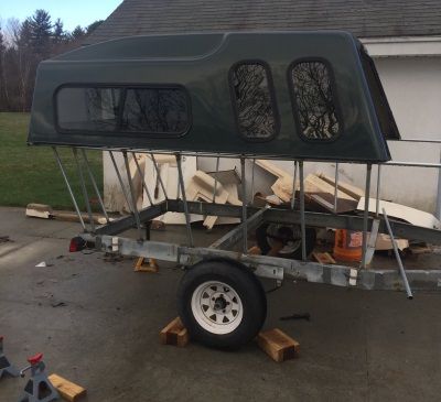

Frame Complete Side View

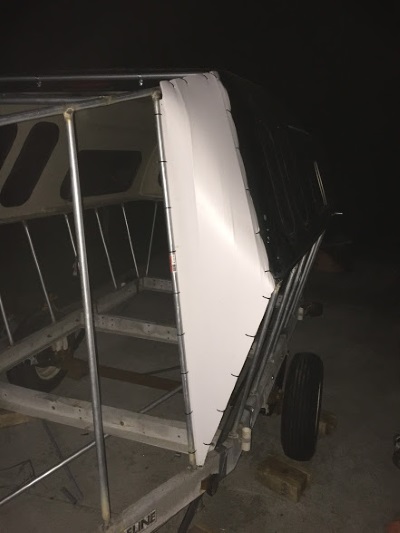

I installed on of the side panels today. It was the most difficult of all the ones I will have to do because of the weird angles where the truck cap transitions into the nose. Originally I was going to panel my camper in corrugated steel roofing panels but a discovered that coroplast is cheaper per square foot and I should be able to weather proof gaps and seams with Gorilla Tape. As luck would have it I had half a panel left over from another dumb idea so I thought I would try it out.
I used a heat gun to facilitate bending the coroplast to shape there was already a crease in it from storage so it has a "ripple" in it, I may pull it off and re do it if looks horrible in the daylight. But the proof of concept works so I am gonna call the local sign shop tomorrow and see if they can sell me the stuff cheaper than Home Depot. One of my concerns is how coroplast and Gorilla tape will hold up at 70MPH...
I also have to get serious about the floor, It will be a lot harder to put in after sides are on. I am thinking half in foam insulation with half inch ply on top, I am planning on a drop floor so I am still pondering how to brace such a thin floor over a 42 x 60 span.

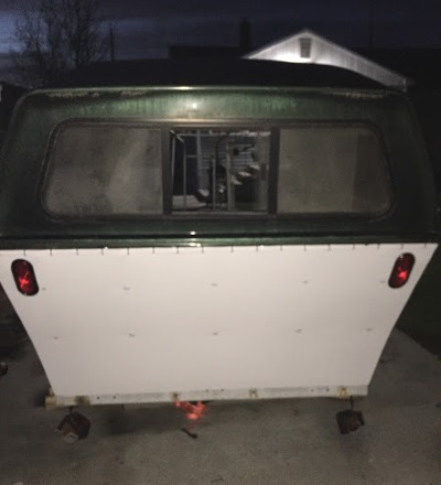

After artfully cramming a 4 x 8 sheet of coroplast into my RAV4 I realized I needed to get my trailer on the road so I could use it to haul materials. I needed to fix the lights so I decided to rough out the back end to get the lights in place so I can make a Home Depot run tomorrow. I need to mount my license plate and cover some holes with gorilla tape, but the back side is mostly done.
