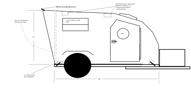

Postby PatrickM » Sat May 19, 2018 2:23 pm
My rough design(subject to change without notification) -- 5’ wide
I might go with a straight vertical back – I will be challenged enough doing the front.

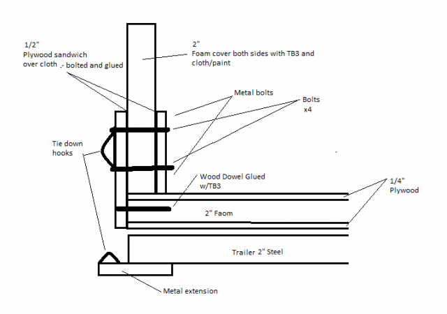

Here is my idea for the tiedowns and roof rack mount areas

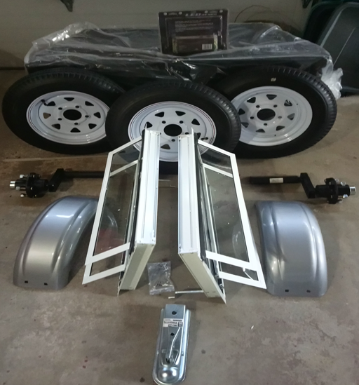

Got some stuff already - need to pick up some plywood, foam, glue, and drop sheets to get started.

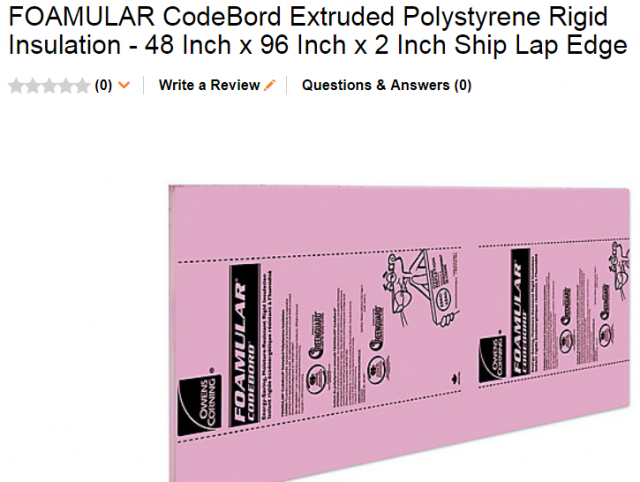

Foam prices - did not think it would be this expensive!!!!
70$ a sheet
Any one in Ontario know where to get cheaper? I have reviewed all the big box stores. :?

Postby KCStudly » Tue Jun 12, 2018 2:38 pm
Have you seen Barak's build (clicky)?
He did a PPG storage compartment at the front. The pic you posted above does not appear to have any storage room for your rig, or am I missing something?

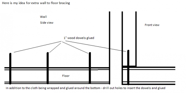

Postby rowerwet » Fri Jun 15, 2018 6:03 am
$70?! I get mine for $33 or so.
You could also build with EPS which is less expensive.
As far as foam walls to floors attachment.
Edge glue the foam to the top of the floor.
Then after you have the tear box built, lift it off the trailer, and wrap the canvas skin under the edge of the floor.
Extend this overlap 6" plus under the trailer, no further reinforcement needed

Postby rowerwet » Fri Jun 15, 2018 6:14 am
Personally I think a plain foam box, without the fancy angles would be quicker and easier.

Postby OP827 » Sat Jun 23, 2018 11:32 pm
PatrickM wrote:Foam prices - did not think it would be this expensive!!!!
70$ a sheet
I would try searching drywall and building supply companies in Ontario near you. I got my 300 Foamular from Consolidated Gypsum in Edmonton for less than big box stores. There must be similar suppliers in Ontario.

Postby rowerwet » Wed Jul 04, 2018 5:24 am
Try foundation installers and commercial construction companies, they both buy the foam by the pallet in truck loads, they may have broken, damaged or partial sheets, or partial pallets hanging around.
One of my sawfish foam kayak builders had his foam strapped to the car roof.
On the way home the wind broke his foam.
He picked up all the pieces and glued them back together.
His kayak is stronger than it would be without the extra glue joints.
He was going for very low budget, so he used EPS, he found a glass installer that had a pile of 2" EPS sheets, the glass panels are shipped between them.
