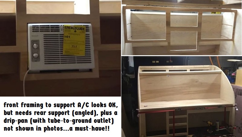

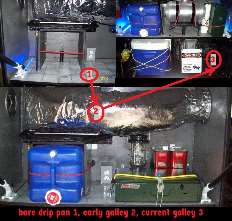

Postby working on it » Mon Aug 13, 2018 11:31 am
  • Your carpentry looks good, much better than mine, and I like your galley arrangement (mine is storage only, alas!), but I have a question about your A/C framing. Surely you have a plan for the underside support of the A/C unit, and for the handling of dripped condensation that most all A/C units produce? I see no signs, so far, of how you'll do this, since your cabin/galley bulkhead behind the A/C seems solidly sealed.

  • I incorporated a drip pan into my so-called "galley", sized to hold a Reliance Aquatainer, with a drain tube routed out & under the trailer. My LG 5000 BTU A/C unit has never once dripped into it, (probably since LG's use up most, if not all water produced, in cooling the chassis coils); but then, my A/C exhaust is fully enclosed, and might evaporate any excess condensate before it can drip.

  • This is just a question of/reminder of, if you have plans for the drip pan, prior to getting wet feet in bed some night.

This AC stuff was before the roof too.
For any drips the AC makes I used a cookie sheet and cut off the handles to fit my spot. I then made a bulkhead and ran a hose out of the trailer.
I put vents in the side of the enclosure and a vent in the back as well. The vent I originally put in was too small. So now I have one almost the entire size of the AC enclosure. That pulls from the galley.
The blocks of wood in front of the cookie sheet is for the AC's front feet to sit on to give it a rearward lean.ImageImageImageImageImageImage
