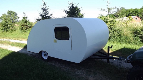

Starting this journal for an upcoming build. I wanted to share my plans/ideas and look forward to any input from forum members.
I got myself in trouble by using the search engine in the for sale by others section of this forum. I am already deep into a teardrop camper build right now. I am on target so far to complete it for fall of 2019. Mostly because I have an unheated shop. So I have to park it for the winter.
While killing time one night I was browsing teardrops for sale. BAM!! I run into this beauty located a couple hours from my house. Beside it's look it was priced very very reasonable. So I had to go look

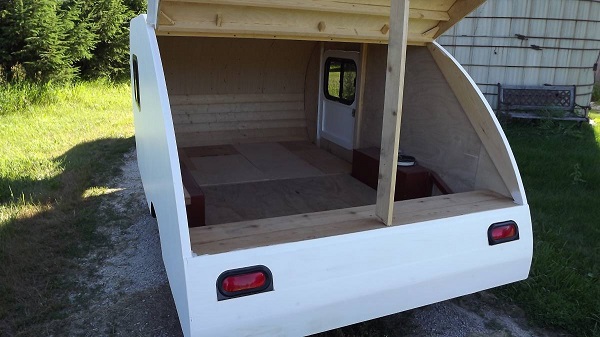

It is all brand new from the tires to the roof. It even has a custom frame with a 4" drop channel in it for the axle. You can't see it in the pic's but this thing sits low. Very cool profile. It's 5' 7" wide and 10' long. The walls are 1/2" birch ply and the roof and hatch are skinned with 1/4 inch birch ply. The ceiling is insulated with 2" foam. It is painted in white primer over the birch. The prior owner was a skilled do it your selfer and did some very nice work.

You might want to rework the back so the opening is flush with the floor. That way you don't have to lift tools or materials over the high sill in the back.

Postby Mr. Lahey » Sat Aug 25, 2018 7:30 am

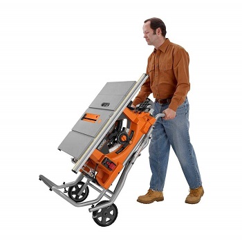

I thought about the rear load thing too. I think I've got a very workable solution for it too. The biggest item to get in and out of the tear is the portable table saw. I have this one below.
I think I can wheel it to the back of the tear, back it up to the hatch opening and lay the handles on the opening. Then come around and lift it up by the bottom handle and slide it into the tear. I'm even considering having the floor drop down an couple inches or two. I want to create a pocket or bay to help keep the saw in place while traveling. So it kind of drops into it's pocket and stays put. Removing it would just be lifting it by that large lower handle over the pocket lip. Then sliding it out and down till the wheels touch down. Plus it's really not that heavy a saw. Has a cast aluminum table. It's more bulky than heavy.
About the only things to go in and out the rear door would be the table saw and miter saw. The miter saw is only 30lbs and not too awkward. I think I can create a pocket for it above the table saw that is accessed from the rear. The rest of the tools are small. I plan to go in/out the side door with that stuff.

Dawned on me after the last post that I will have to make the table saw pocket flush with the existing rear sill. If I had it drop down an inch or two into the pocket the saw would be trapped in if I had sheet stock over it. You couldn't lift the saw up and out with stuff on top of the table. The saw will have to be able to slide in and out with sheet goods in place. Catching stuff like that before I build it, is the whole purpose of me rambling on like this here in writing. This journal is also a great way to keep track of that kind of info.

I can envision cutting the lower unit of the back, between the tail lights. Work out a hinge across the bottom of it, so it folds down. Make some changes to it, and have it as a ramp to roll that table saw up into the trailer..
I worked out of my truck and van for a few years installing cabinets at job sites. Had the Bosch table saw that is an equivalent to what you have. After a few months taking it and out of either truck or van, it started bothering my back. So I made a small ramp to use..
Then on each side of where the saw would be, I made roll outs. On these roll outs, I had the smaller tools I needed most jobs. So i didn't have to crawl in and out of the vehicles..

I've been spending a few minutes here and there trying to plan out where all the tools will be located and so forth. The more I measure and look at it, the less practical it's starting to look.
The combination of the interior wheel wells, dropped rear floor, and raised rear hatch sill are all major stumbling blocks toward a practical tool storage interior layout. No matter how I place the major items and so forth the remaining space is hard to get at, or too tight to be practical. So I'm about 80% certain the tool box tear may not happen. I'm going to take one more final look at the idea. I'm going to mock up 2 empty cardboard boxes to simulate cubic area required for my table saw and miter saw. If I can't place them in the tear in a way to have useable space remaining, then It's all over for this tool box idea.
No big deal. I'll just finish off the cabin and add a basic galley. it will make a very cool camper for someone who does not want to build one.
