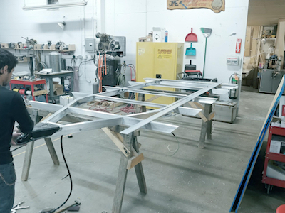

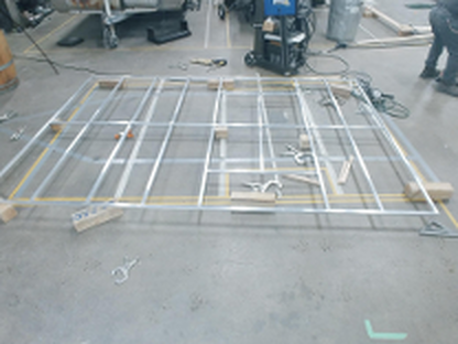

Postby kykate » Thu Nov 01, 2018 5:22 pm
Laid out on the shop floor.
Welded trailer chassis.
kykate

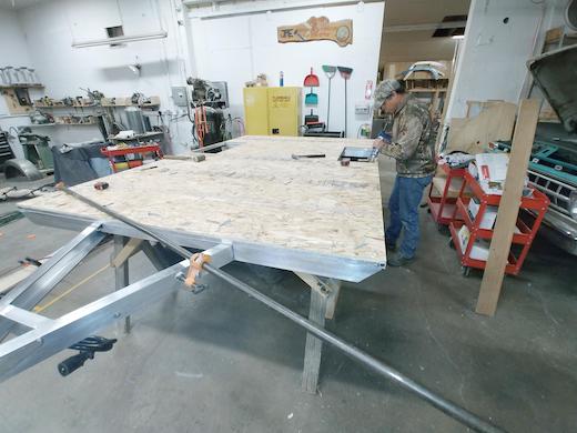

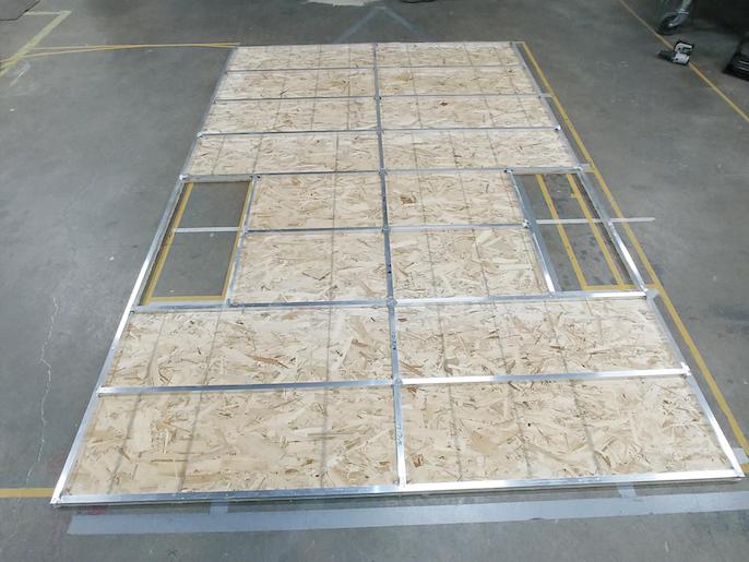

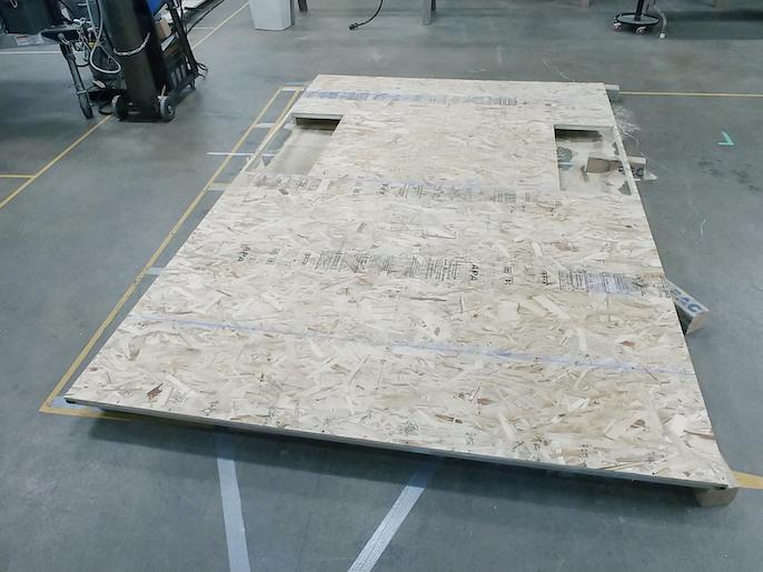

Postby kykate » Thu Nov 01, 2018 5:27 pm
OSB Floor
Underside grid work.

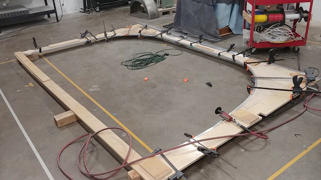

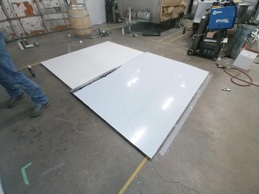

Postby kykate » Fri Nov 02, 2018 10:04 pm
kykate
Posts: 47
Joined: Sat Jan 06, 2018 6:05 am

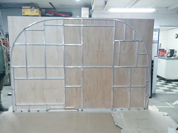

Postby kykate » Fri Nov 02, 2018 10:05 pm
Curbside Wall.jpg (34.03 KiB) Viewed 5041 times

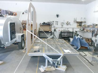

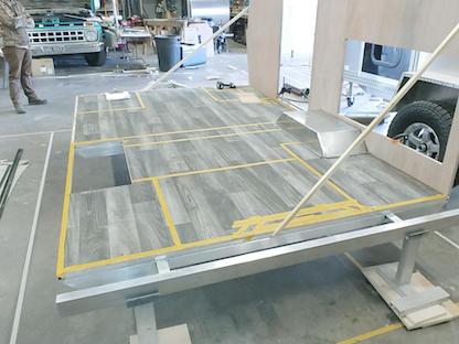

Postby kykate » Fri Nov 02, 2018 10:09 pm
Today's progress:
Front view.jpg (25.19 KiB) Viewed 5039 times
