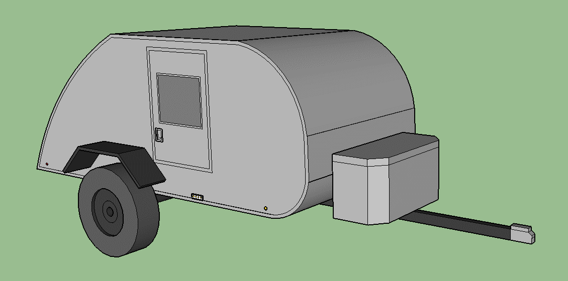

I am undertaking a pretty comprehensive remodel of the TD that I originally built in 2003. It was getting a little worn out and had been through many family camping adventures. I am moving towards a more off road capable and styled trailer. Now that we have LEDs and Amazon, there is a whole new world available. For now, I'm looking at doing the following:
1. Replace rear Model A-style brake lights with flush mount truck style LED units.
2. Replace original 5.30x12 tires/wheels with new 205/75/D15s on 15" black wheels.
3. Replace stock fenders with Jeep-style flat fenders.
4. Replace marker and clearance lights with new flush-mount LED lights.
5. Restyle interior with a mild National Parks/Adirondacks theme.
6. Complete new kitchen (tbd)
7. New exterior LED light bar and flood lights.
8. New color scheme - Aluminum w/ Satin or Matte Black with tan interior.
9. New outdoor carpet walls in tan.
10. All new wiring.
11. Tongue Box.
12. Fixing bear-damaged window
Project goal: Simple, basic, functional with nice finishes, efficient systems, and durability.
The basic box will stay the same (54" wide x 120" long).
I'm sure more will come. Here's the design so far.
