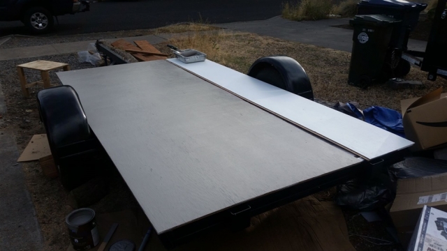

I've got a completed floor on my trailer!!!
Over the last few days I knocked the dust off my project and got it going. I'll try and figure how to add pictures here soon

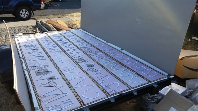

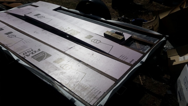

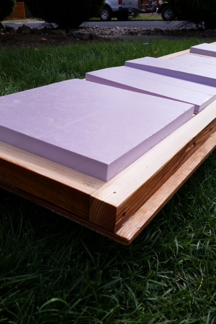

My Floor system assembled and ready to put on the frame. I decided to add aluminum screen below the rigid foam to reduce chances of damage to floor system by critters or road debris while still drain/dry and remain light.
I used pressure treated ~2x2s as floor joists (?). I made sure to add additional wood treatment to all cut edges.
Its a tight fit to get all the foam wedged in. A bit frustrating but a tight fit should be good to have.
I primed the wood and added two coats of Sherwin Williams Superpaint that I picked up at the local ReStore for $4. I secured the joists from underneath with hot dipped galvanized 1 1/2" lag bolts. Some of the holes had no access to predrill from below so it took awhile to locate the precise locations from above :x

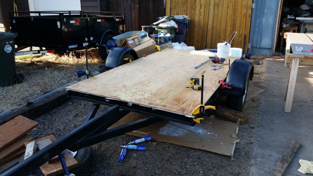

Postby Trip42 » Thu Sep 12, 2019 10:12 am
Kinda scary doing this myself and feeling like I had to do it as fast as possible. Still stopped to take a picture though for you. I used PL Premium construction adhesive along the wood joists and PL300 Foamboard adhesive on the foam. I used Titebond II along my halflap plywood joint
Screwed down my ply every ~10" with GRK #9 2" screws. They are coated to handle the pressure treated just fine

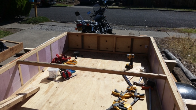

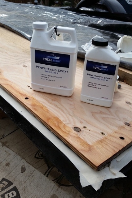

Before installing my walls I used penetrating epoxy on all the plywood edges

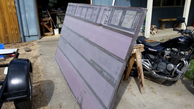

I installed 1 1/2" eps foam in my pony wall cavities. I wedged it it real tight and so decided to skip the glue
Until I decide on my permanent supports, I will use these temporary plywood ones i knocked up

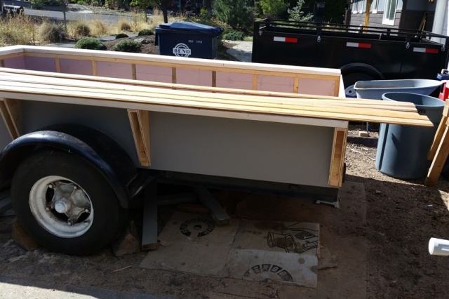

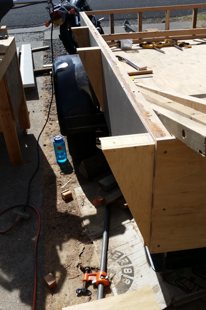

I finished my pony walls. I glued everything with more PL premium glue and bolted the walls to the frame with 4-3/8" and 1-5/16" galvanized bolt per side and 3-5/16" bolts for the front wall

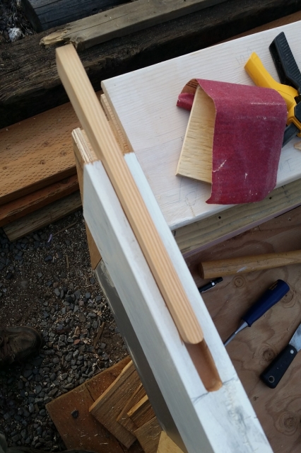

Knocked up a jig to cut 1/2 mortises with my router on my ledge boards to add strength and support. First time I've tried something like this...
I had to futz the spline in to get a tight fit, notice the sandpaper and chisel

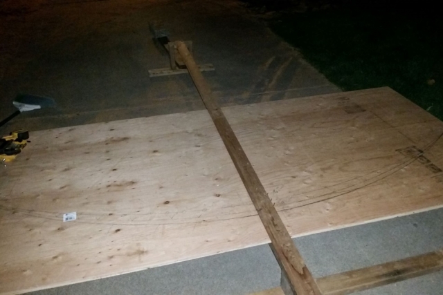

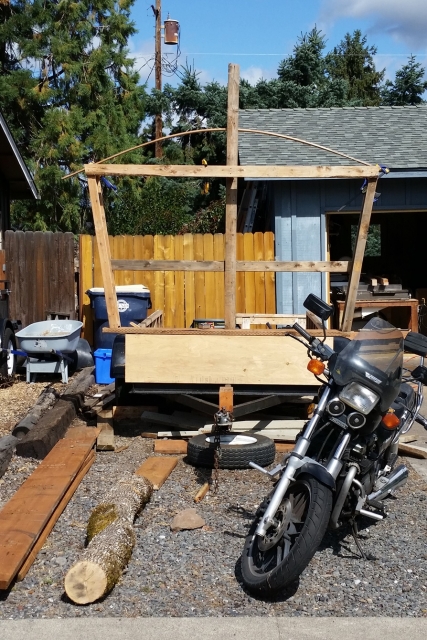

Demo of about how far my roof will overhang the rear of the trailer. This shows 16", I have about 3" over the front which i may change a bit. I double checked to make sure that I have enough t&g to cover my roof and I have just enough so hopefully I don't have too much waste

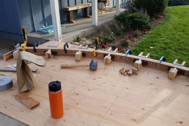

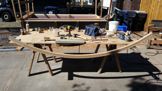

Getting my curved roof beam jig created and I worked on finding my arc and drawing my line. My roof beams will have a radius of 79 3/8" and give me an interior max height of about 81 1/2"
Testing out my beam glue up method on the jig that took me a day to build

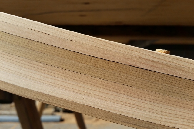

This is really exciting for me to see as I was quite nervous doing my first curved glue-lam. I used Titebond III and I did this one by myself. For the future ones I will get help as I ran up to the set time on my glue. I think it bonded sufficiently still but this one may end up on top of one of my end walls where it won't be visible.

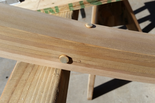

I had several screw holes/defects on the sides and bottoms which will be visible and so I tried bunging them with cedar pegs I cut. My beams are approx 2" x 2" x 98"
My first beam came out with hairline gaps along some of the seams. In the future I will need to use more glue, put clamping force across the whole width, and get help I think. I did add ~10, 1 3/4" screws from the top side to make sure that there is no slippage or increasing separation

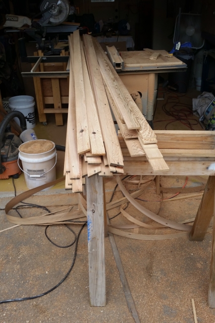

I only need another 72 strips :) Gonna be a lot of saw dust

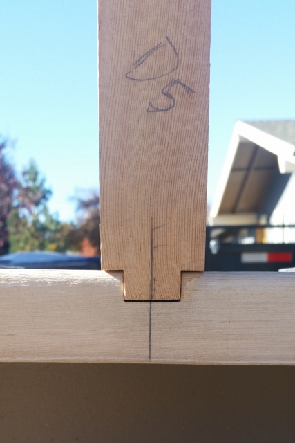

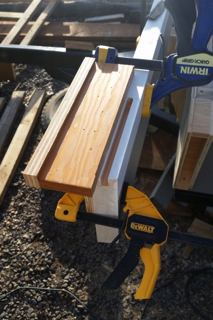

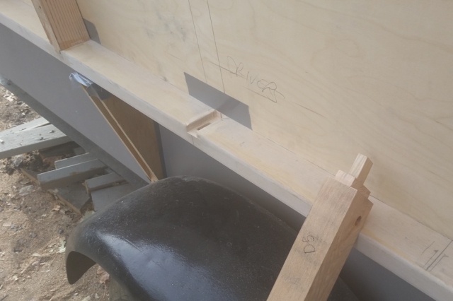

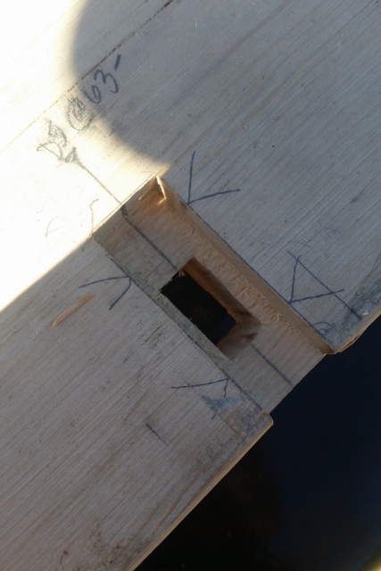

Using my router, I made a pocket for my stud and then at a 9 degree outslope, mortised both the ledge board (as shown) and the stud to receive a loose tenon
This took lots of time for my 18 studs as everything was cut to fit and needed plenty of elbow grease and hand tools to get it just so
I used titebond 2 to glue the tenon into the stud and then PL Premium to glue the stud to the ledge board. I am attempting to get max rack resistance so that I can skip adding plywood to the exterior of my walls. So far I'm really impressed with the result and I haven't even tight fit the foam between the studs which I expect will additionally limit rack

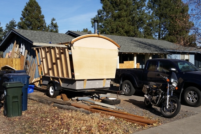

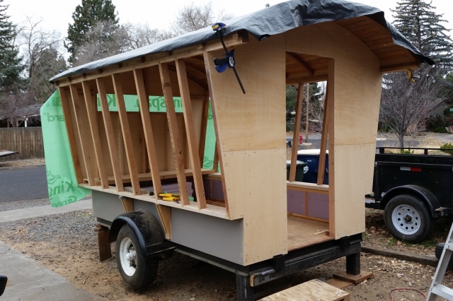

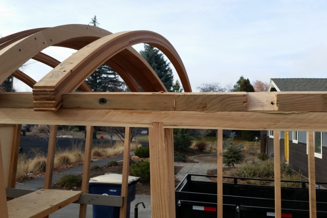

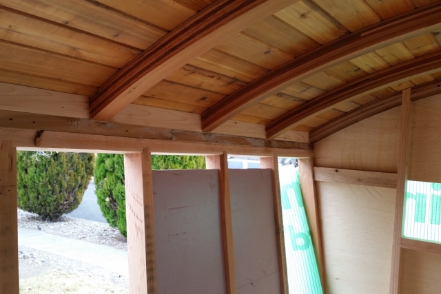

Setting my Roof beams: I cut notches in the cedar boards installed above my top plates. Glued and screwed everything together with PL Premium 3x
Roof beams dry fitted: All my roof beams in place, starting to look like I actually might make something of this build!

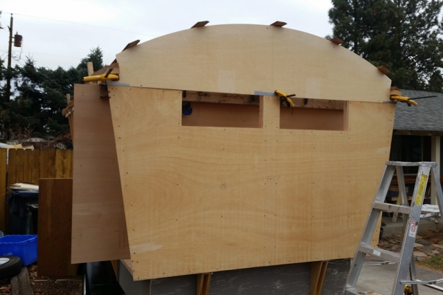

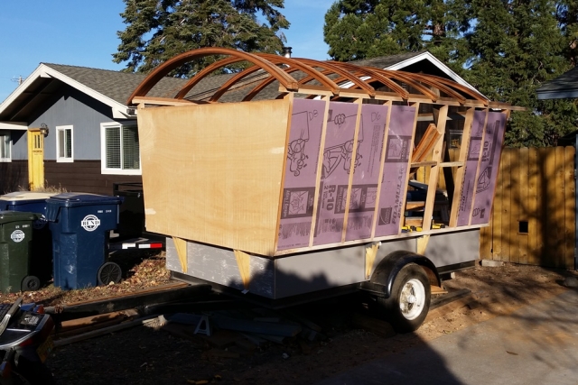

Building and cladding my end walls: Using 6mm marine plywood on both end walls

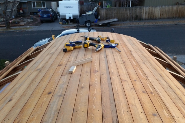

Roof going on: Clad my roof with 4" tongue and groove boards. I found these as a deal on craigslist and they already were coated with one pass of lacquer

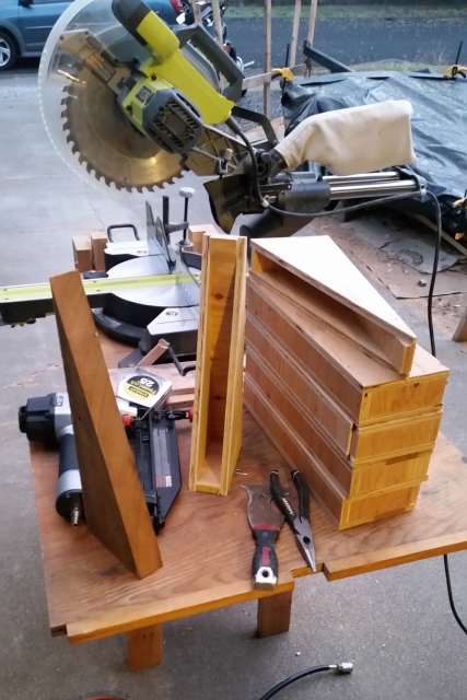

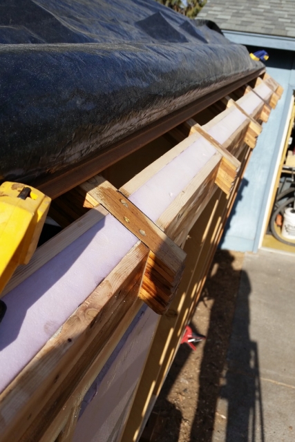

Foam sandwich bird blocking: I decided to get some insulation between my roof beams. I made a sandwich with 1 1/2" foam and 1/2" cedar to add up to my 2 1/2" wall thickness
I'm really happy about my interior roof view with the exposed beams. I plan to add 2" rigid insulation on the top of my roof
Roof on and tarped, just in time for the first snow of the season :)

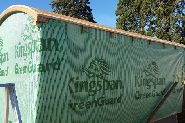

Rafter tails trimmed and house wrapped: Trimmed the ends and sites of my roof. Sides overhang about an 1" which should get the water out side of my 1/2" siding
