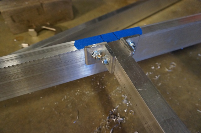

I thought I posted this picture of the crossmembers yesterday... :oops:
They are mounted to the side rail with 1.5" angle aluminum brackets, 5/16" bolts and the aforementioned aluminum spacers. The floor will be secured to the crossmembers using 5/16" bolts from below with T-nuts (or furniture nuts) inserted into the floor from above. Oh, and disregard the fact that the angle brackets in the picture are proud of the side rail... we'll chalk that up to a sloppy chop saw. I might shave them down later, but they probably won't be visible once the frame is flipped over. We'll see.

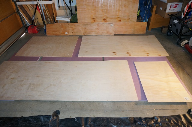

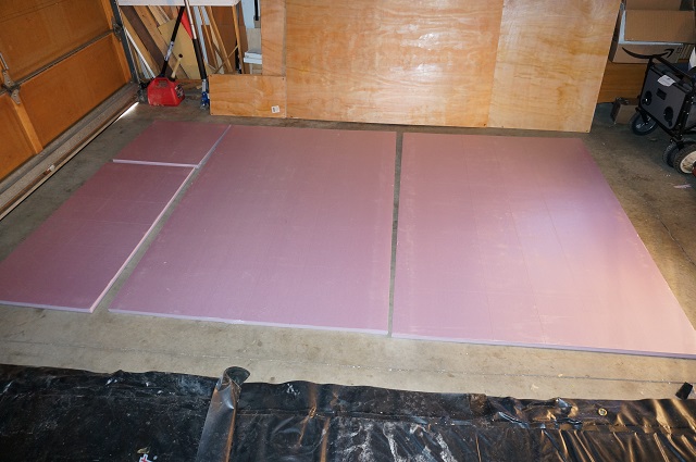

Started on the floor today. Nothing too glamorous, but here you go.
The floor will be a 1/8"Plywood || 1"XPS || 1/8"Plywood sandwich, laminated with epoxy and then skinned with fiberglass.
Foam cut and laid out.
Plywood (bottom) cut and loosely laid on top of the foam. All seams are, or will be, staggered between the three layers.
