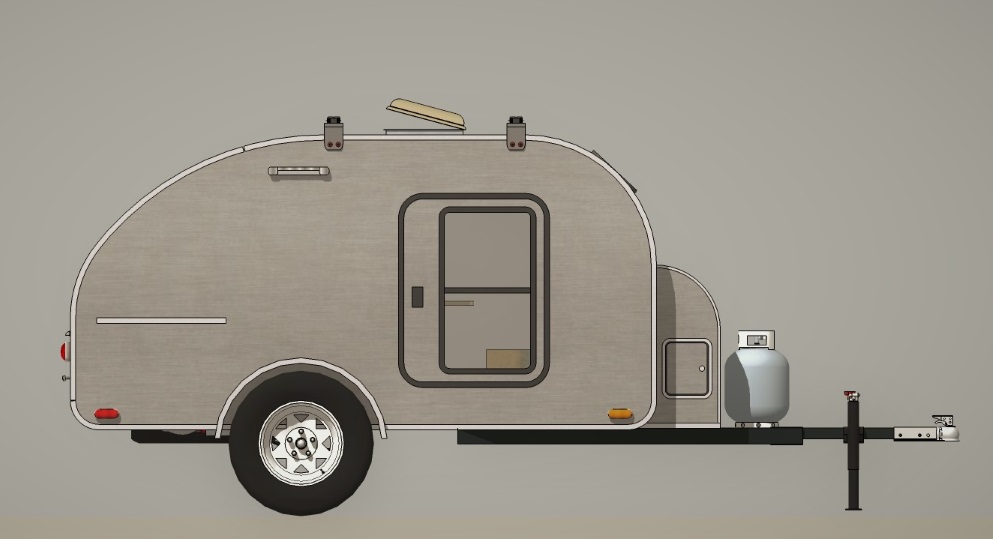

Welcome to the build journal for The Coddiwompler!
(Coddiwomple (v.) Origin: English Slang Word. Definition: To travel in a purposeful manner towards a vague destination.)

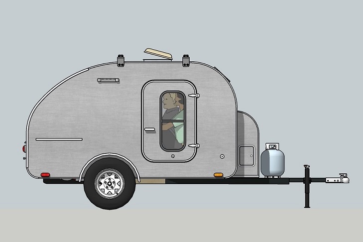

I figure that it is time for me to stop over-thinking the design and begin the actual building! My progress will be slow, because I also have a ton of other projects that need to be done around the house. But, I hope to get this done in about a year... maybe in time for the 2020 ski season.
The design is based on the Generic Benroy, and it will be 5' wide x 9' long, plus 12 inches of over-tongue storage. It will be 4'-6" tall with 45" cabin head-height.
It will be built on the NT Ironton 5x8 trailer with the typical modifications: Frame width will be cut to 58", Leaf springs will moved back about 6 inches with axle positioned above the spring, tongue extension bar will be added, and larger wheels.
I'm leaning toward solid 3/4" walls for simplicity, but the roof and floor will be insulated. The interior surfaces will be just finished plywood, with minimal, or no exposed hardware, trim or fasteners.

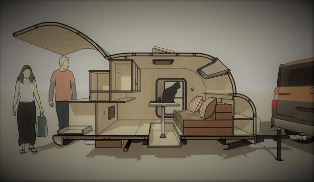

The Profile

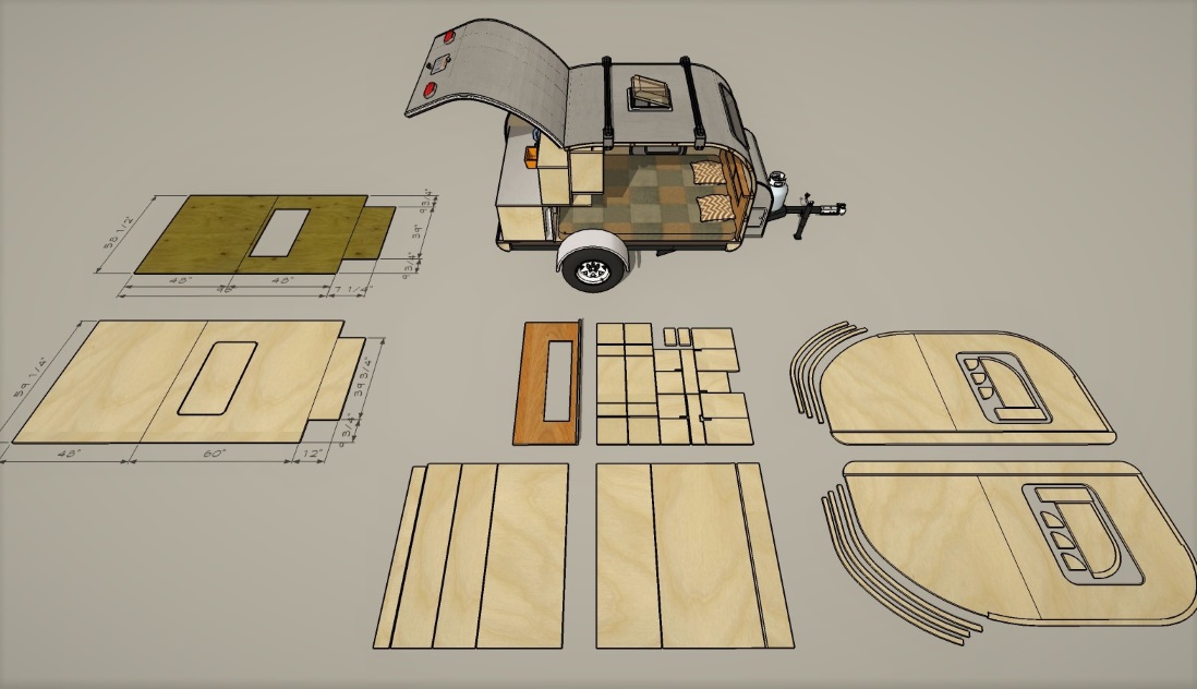

Plywood layouts

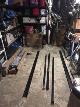

1st Step: Build the trailer. Well, maybe clear some room in my garage first.

Fun with Sketchup 2019. It now has solid section fills and line styles!!
Notice the dotted spar lines

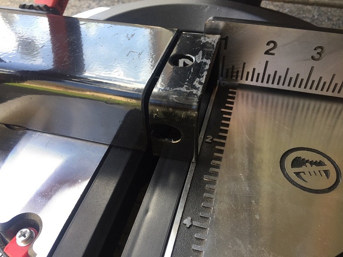

Started chopping the cross-members to reduce width of trailer to 58 inches. I cut an inch off of both ends, and re-drilled the bolt holes. In retrospect, I should have cut 2 inches from one end only to reduce the amount of re-drilling.

I think I am close to finishing the design. I increased the height from 54" to 60". I'm a big dude and I need the headroom!
I have also decided that I need 42" high doors because I would hate having to crouch to see out the windows, and I prefer not bonking my head all the time. I got a price from Challenger for almost $700 each! So I guess will be building them myself. They will look better anyway. I also re-positioned the door to allow me to more easily sit and swivel into the cabin.

Postby eLink » Tue Apr 23, 2019 10:07 pm

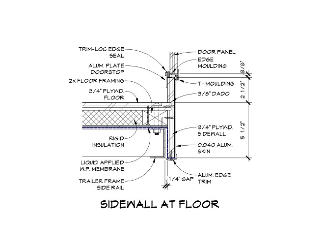

Thanks Tony. I am going to set the door sill at about 2 1/2 inches above the floor... maybe lower if I add an interior doorstop, which, I guess, will have a 5/8" lip. I was considering a 4" folding mattress, but If the door sill bites into the legs too much I suppose I'll have to find a thicker one.
Here is my sidewall/ door sill detail, kinda cobbled together from all the information found in these forums...

Postby KCStudly » Wed May 29, 2019 10:40 am
Nice illustrations! Welcome to the mad world of TD building. :thumbsup:
Re: The Coddiwompler
Postby tony.latham » Wed May 29, 2019 12:03 pm
If you are planning on using the same Trim-lok that I am, you’ll need more gap. They say that full compression will cause the seal to fail and recommend 30-50%.
Take a look at my build log- “#4”.

Postby QueticoBill » Wed May 29, 2019 4:49 pm
I would rethink that channel trim at botyom of wall. Seems like an invitation to water to collect and rot plywood wall. Anyway to have skin outside of channel?
Also, im on a long pause building on the NT trailer, think about how to compensate for side rails proud of cross rails. I'm stopping bottom ply inside side rails and running a dado down framing to clear bolt heads.

Postby eLink » Wed May 29, 2019 8:47 pm
tony.latham wrote:If you are planning on using the same Trim-lok that I am, you’ll need more gap. They say that full compression will cause the seal to fail and recommend 30-50%.
T
Good call! I don't really want to add more trim to widen the gap. Maybe I could use the smaller 'D' shaped seal.
QueticoBill wrote:I would rethink that channel trim at botyom of wall. Seems like an invitation to water to collect and rot plywood wall. Anyway to have skin outside of channel?
QB, I'm using your build journal as a reference for the NT trailer. I look forward to seeing more!
Yeah, I'm also a bit concerned about the bottom edge, but it's been done before. It's not shown in my detail, but there will be a layer of weather seal under the aluminum trim. And as a second line of defense, the plywood will get some sort of polyurethane coating.
For the gap over the cross-rails I was just going to add some thin ply strips. Then again, I may omit the bottom sheet of ply and insulation altogether.

As a rule for outdoors construction, I try to never rely on sealants as a first line of defense against watter. Plan it to drain.
