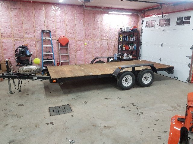

To date I have stripped the trailer to the frame, doubled the crossmembers, added steel fenders to the tandem torsion axles, changed the front jack, painted the frame, rewired with new LED lights and sheeted the floor with 3/4" pressure treated plywood. I have just started building the hybrid foam walls.
The inside dimensions of the livable space will be 5'6" by 13'9" (the exact dimensions of the plywood floor) I will be mounting the walls outside the frame onto an angle iron ledge flush with the bottom of the plywood floor to prevent any chance of water seepage. Walls will be 2" foamular C300 XPS with the framing routed into the foam on the inside to keep the outside mostly solid foam. Studs are 1" x 1 1/2" ripped from 2x6s so even where the studs are there is no thermal bridge, just half insulation. The stud frame is constructed with dowels, glue and screws for durability and it is being bonded to the foam with gorilla glue and screws with plastic washers.

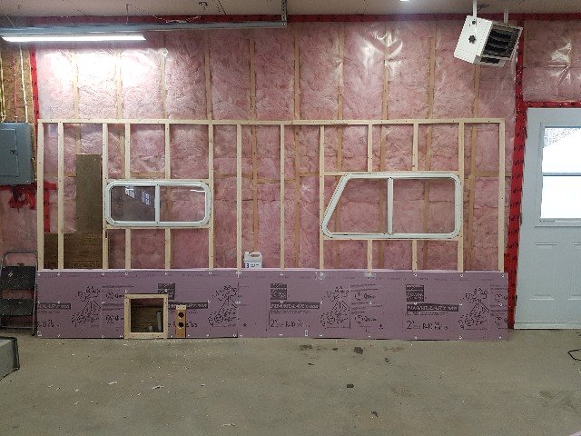

I've started a personal album with resized photos of my progress so far. Pictures have description of what was done. I've added the most recent pic of the first wall here as a teaser :P

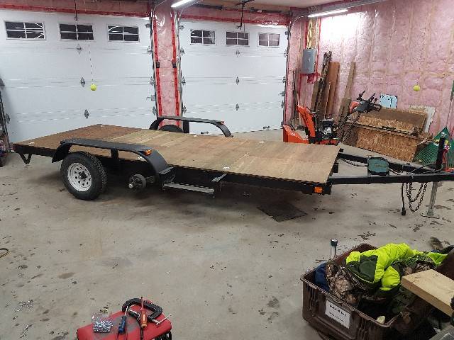

Postby MatTech » Tue Feb 12, 2019 12:12 pm
The basic idea of the build is that the platform seen in the pictures will be the floor space. The walls will mount directly to the frame outside the floor (inside the fenders). Walls will be 6' 6" tall and the roof will have a peak 6" higher for drainage. The rear 9' of the trailer will be open space to haul my 1973 Terra Jet and will have fold down couches/bed. Rear door will either be a ramp or open upwards and I will stow my aluminum ramps under the deck. In the front will be the wet bath, sink, stove, fridge and stationary cabinets. Batteries and propane will be on the a frame up front and eventually I will build walls around them turning the trailer into somewhat of a v nose cargo trailer. I will insulate the floor from underneath and all tanks will be located inside the heated space for cold weather operation. Everything from the donor trailer is being reused except the body.
This plan has gone through many changes, originally I wanted a slide on camper body that telescoped down like a hilo but in the end the axles have brought me to my current plan. They are dexter torflex axles rated for 2200# each so 4400# is my max weight with the 1000# Terra Jet and supplies on board. I had to cut all the extra weight involved with a second floor structure and telescoping mechanicals.

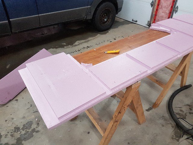

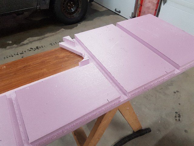

More progress today. The left side wall is almost all foamed :)
Starting to get a rhythm with the router. I'll definately need more GG before I'm done this build. Even with the 36 ounce bottle it goes fast with all the surface area of the routed in studs.
Should be solid as a rock when it's all done.

Postby MatTech » Thu Feb 14, 2019 5:29 am
With the shop vac hooked up to the router it only makes a little mess. The flip side is that its cumbersome to maneuver the router with both a cord and hose attached.

Postby MatTech » Sat Feb 16, 2019 1:59 pm
My thought process on grooving the foam was two part. For one buying two sheets of 1" foam was more expensive than buying 1 sheet of 2" and the glue required to laminate the exterior foam would have added even more cost. The other thought was that by grooving foam with straight grooves it would pull the frame into square automatically and add even more strength since my 1" X 1 1/2" studs were quite twisty and some were bowed.
I only have 2 1/4 inches from the outside of the frame to the inside of the fenders and cutting in on floor space wasn't an option. All things considered grooving out the foam seemed to be the most economical and structurally sound, time to install not being accounted for.

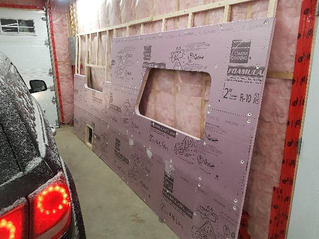

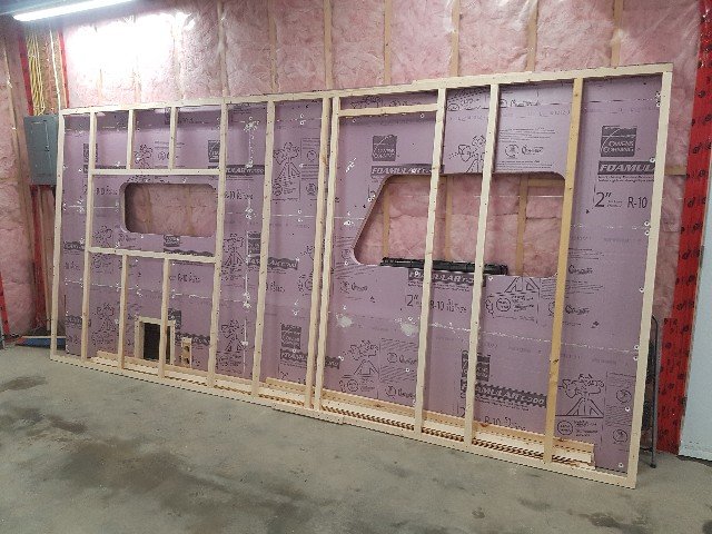

Postby MatTech » Sun Feb 24, 2019 6:14 pm
Made some more progress today. The left wall is completely foamed and I finished the framing of the right side wall. The framing went a lot quicker on the second wall since I've found my rhythm.
I will foam the second wall then I will set myself up to work on the walls flat on sawhorses and start filling the screw holes with durapro. I gave polyurethane canned foam a try as both an adhesive and for filling the screw holes but It was no fun at all. I'll stick to the gorilla glue from now on for gluing the foam in place as it is way less messy and doesn't expand as much. As for filling the screw holes, the canned foam doesn't adhere enough to the plastic washers. The only thing I will use it for now is filling foam to foam gaps.
Made a few little mistakes, mostly second guessing myself and turning out to have been right the first time lol. In case anyone is wondering why none of the windows and door have headers, this is because I will install a full length header at the very top on the inside to distribute load evenly. It will be inside the full length cabinets anyway so no sweat there.
