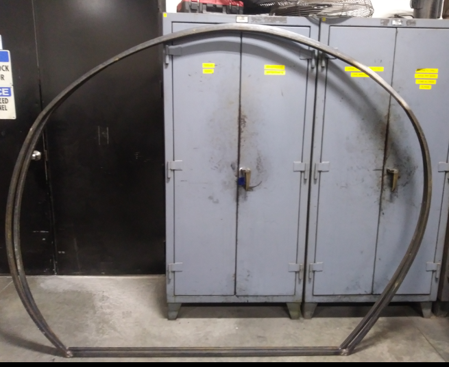

Postby Danomite » Tue Feb 12, 2019 1:20 pm
My crude homemade tubing roller sort of self-destructed while making the profiles & this is what I ended up with. But I kinda like it.

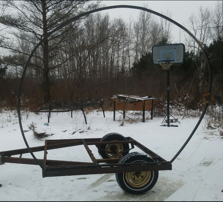

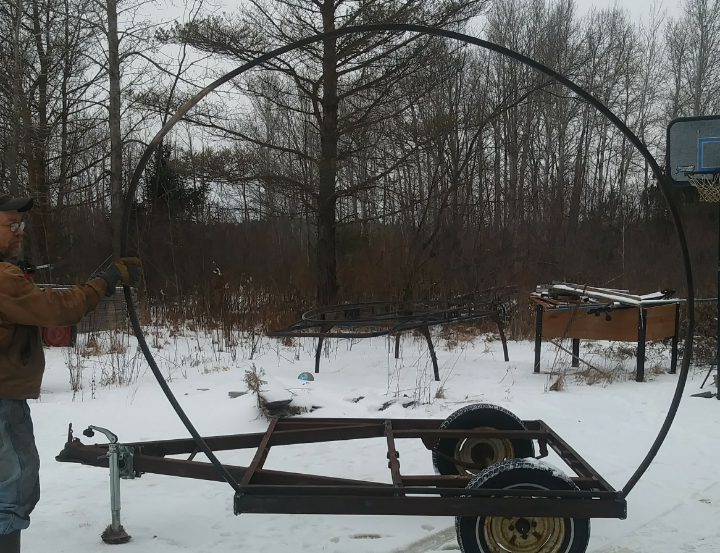

Postby Danomite » Tue Feb 12, 2019 1:24 pm
This way seems rather unbalanced and too far forward. Btw, the bed of the popup frame had been almost 11 feet long, now it is 5 ft 5 in.
Danomite
Posts: 62
Joined: Mon Feb 11, 2019 3:47 pm
Location: Sears, MI
Re: Central Michigan Canned Ham
Postby Danomite » Tue Feb 12, 2019 1:29 pm
This seems more balanced and is how I intend to have it. I am concerned about the narrow track of this axle & am seriously considering ditching it and installing a pair of torsion stub axles with tires mounted outboard of the frame for the sake of stability.

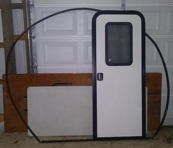

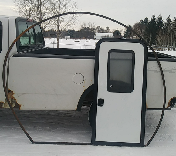

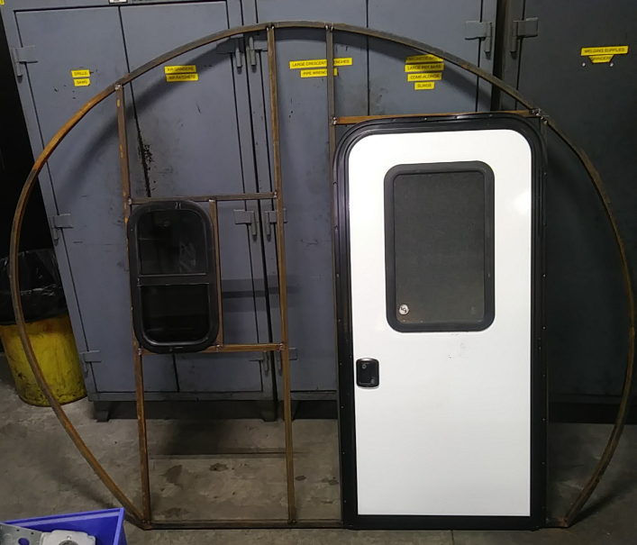

Postby Danomite » Sat Feb 23, 2019 12:10 pm
The door being 6 feet tall didn't really work well in the profile.
Danomite
Posts: 62
Location: Sears, MI
Postby Danomite » Sat Feb 23, 2019 12:15 pm
So I removed a foot off the bottom. I'd much rather have to duck my head a little upon entry/exit than be stuck with only one spot the door could be installed.

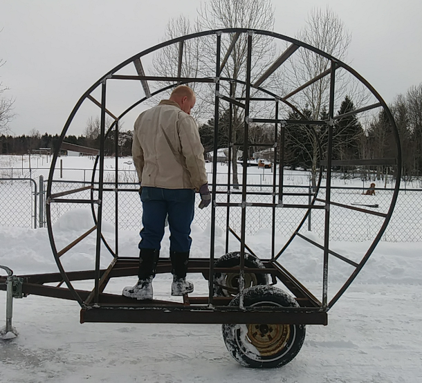

Postby Danomite » Thu Feb 28, 2019 4:45 pm
Ok, it is now 3-dimensional. The frame and skeleton weighs approximately 300 or so pounds.

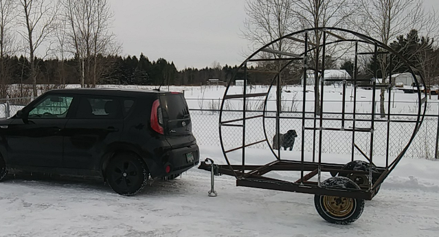

Postby Danomite » Thu Feb 28, 2019 4:47 pm
And just to get a feel for the proportion of it, I set it behind the tow vehicle.

Postby saywhatthat » Thu Feb 28, 2019 5:01 pm
Is that where the axel will set? Great start.
Il suffit de le faire
viewtopic.php?f=50&t=73945
saywhatthat
Posts: 512
Images: 135
Postby Danomite » Thu Feb 28, 2019 5:27 pm
No, I actually bought a wider axle to help with stability. The leaf springs will be mounted to the outside frame rails & the tires will sit out from that. I'm going to move the new axle as far forward as I can (looks like about 4" ahead of the current spot). I'm also trying to come up with a cool design for fenders.
