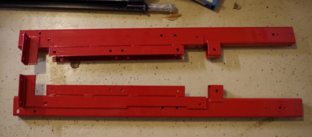

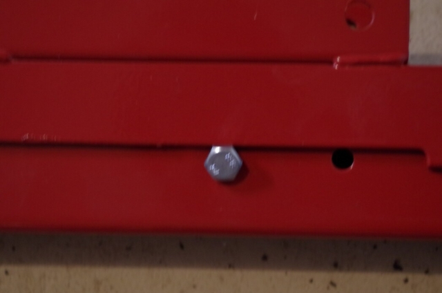

Postby stupido » Sun Mar 03, 2019 4:40 pm
Since the side rails have the trailer a-frame tongue brackets welded in place, I am limit in my axle placement. But the center cross member mount places a convenient hole such that I can bolt the spring hanger in place to mark the rest of the new mounting holes. Basically bolt 39 will go through the center cross member hole.
I end up with a 65/35% split instead of the preferred 60/40% split.
In addition to drilling holes in the hanger and the rails, I need to notch the hanger ever so slightly to clear the center cross member horizonal bolt

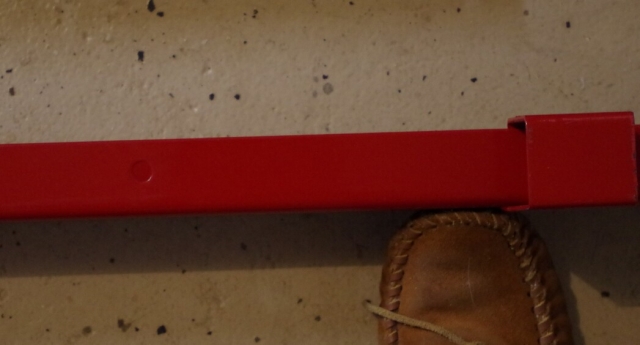

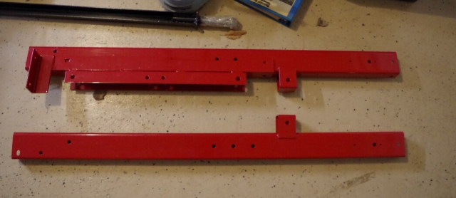

Well as my spouse said yesterday, "How many things are you juggling?" Lots. So Its been a bit but I have made metal shavings and started assembly. I made the notches for the bolts with a bench grinder and a dremel. Got all the new holes drilled. Put the hubs and wheels on to see how high it would be. Need to repack the bearings. What is the blue grease anyway? Got a close match for the paint at Home Depot.
