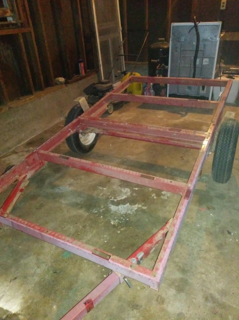

I soon learned that it was a Harbor Freight 1750lb bolt together. It has posed some concerns, but I think I've gotten past that seeing how common they are on these builds. We painted it with Krylon Rust Protector satin black and earlier this year, I bought some lumber for the floor.

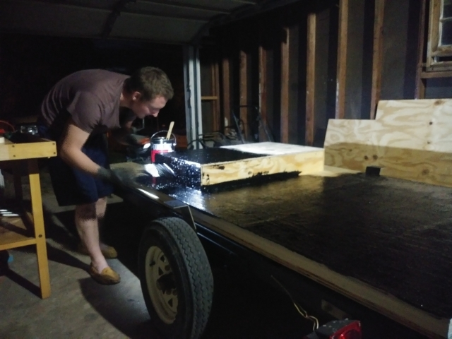

My dad and his girlfriend helped me glue (TBIII) and screw (galvanized exterior 1.5in screws) my floor together. Because I live in Missouri where it gets blazingly hot in the summer and blisteringly cold in the winter, I opted for a heavy duty floor. Not a common option, but it was a good idea to me. 1/2in ply on bottom, painted with tar underneath, glue/screwed to 2x2s matching my trailer frame, an undercarriage storage box planned in there, 1in pink insulation in between, and a 1/2 in ply on top.
Here is my fiance helping with the tar. I was more than happy to give him the task.
