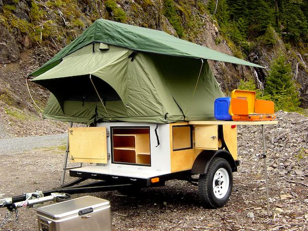

Good luck with your build. You might want to consider building your box so that the top could accomodate your tent to get you off the ground when you are camping. Maybe use this as an example.

We have a 6 year old and my arthritis means my elbows have to point out when I sleep. I have a large tent. The original plan was a queen size camper with a bunk bed over our feet sideways. I just decided I wanted more Elbow Room. Literally
