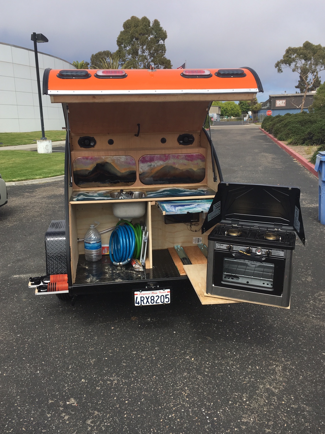

Zion Utah was pretty warm and we were able to test out our climateRight 2500. It worked like a champ!
Have not tested the heating as of yet with this unit.

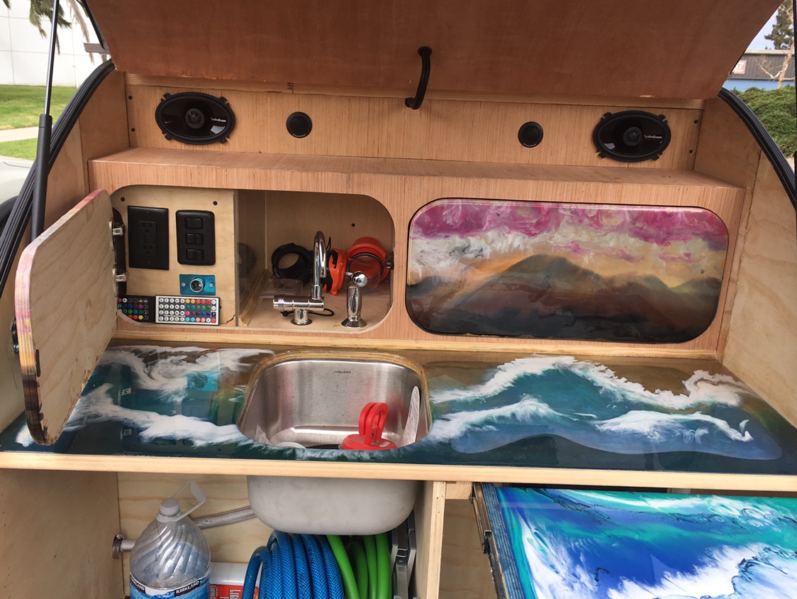

I took the factory ports off and self tapped abs sewer connections on. I wanted to use the colored hoses to match along with more durability.
Here is my kitchen in the stop cooking and drink a beer mode. Turn on the tunes with BT wireless receiver. 4 ohm system Slim 8" SUB (4) 4x6 RF"s (2) RF tweeters, marine 1500W amp with crossovers. The kitchen LED's are synced to the music.
I know..........a little over kill . I was afraid I wasn't going to have good enough sound.
Now I'm cursed with staying under Vol level 3 in campgrounds.
