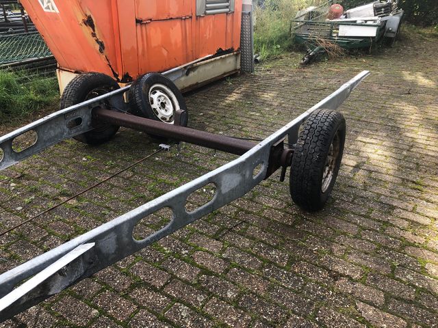

At the same time i looked for a suitable trailer. In Europe you can't buy trailers like Northern Tool is selling.

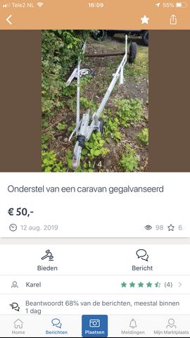

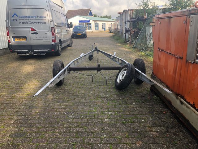

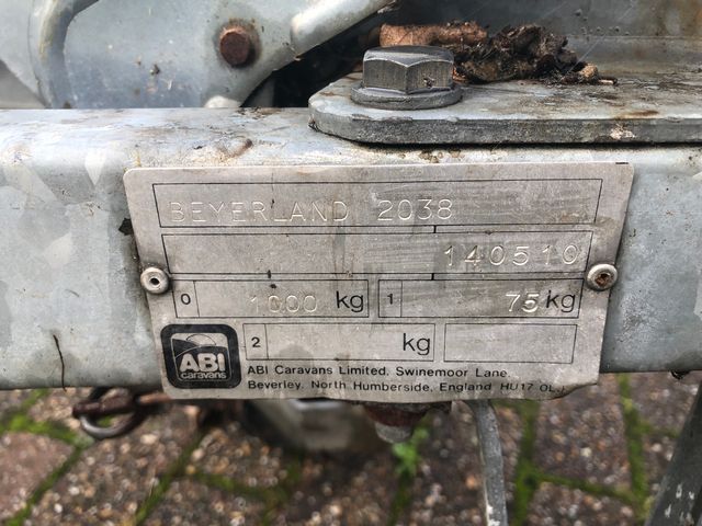

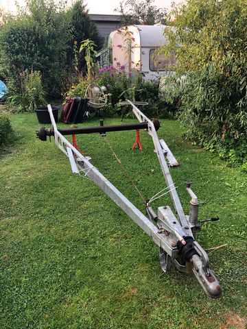

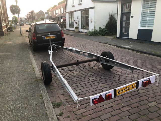

I've found an empty caravan-chassis from the brand ALKO (most used in Europe) just 30 kilometers from our house and it only cost me 50 EURO. Got the trailer and parked it in my garden where the build is gonna have place.
Trailer is with brakes and total weight can be 1000 kilogram, i hope the teardrop is not gonna be that heavy.

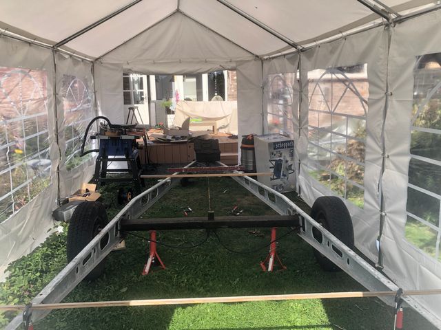

Postby Jan-Willem » Thu Sep 19, 2019 6:59 am

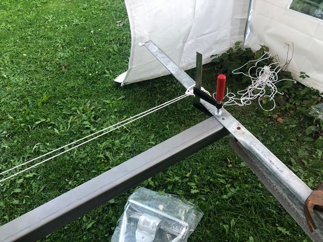

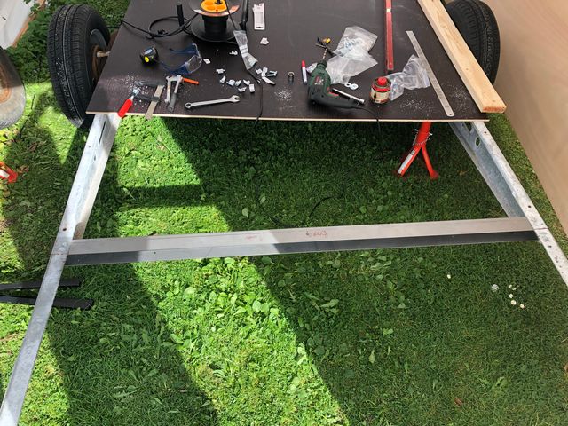

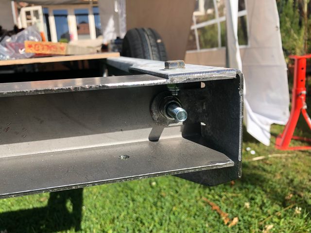

Next thing to clean up the axle and mounting a beam to the rear of the trailer so that the frame is rocksolid. I removed the last 50cm of the end of the trailer because i don't need that length behing the wheel to the back.

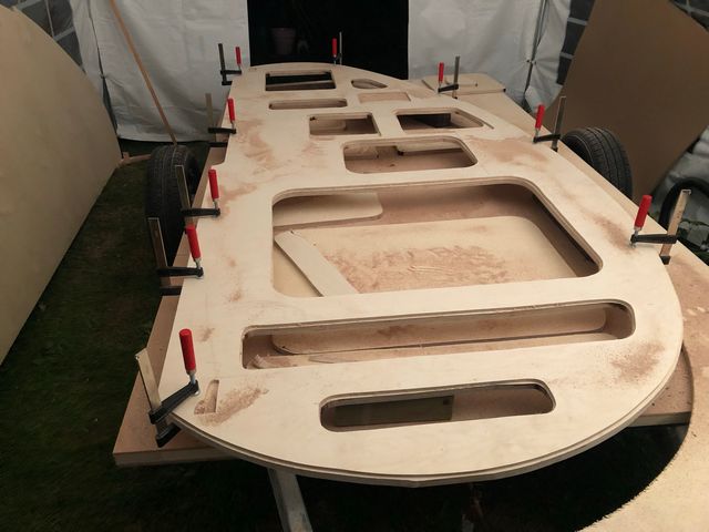

Postby Jan-Willem » Thu Sep 19, 2019 7:07 am

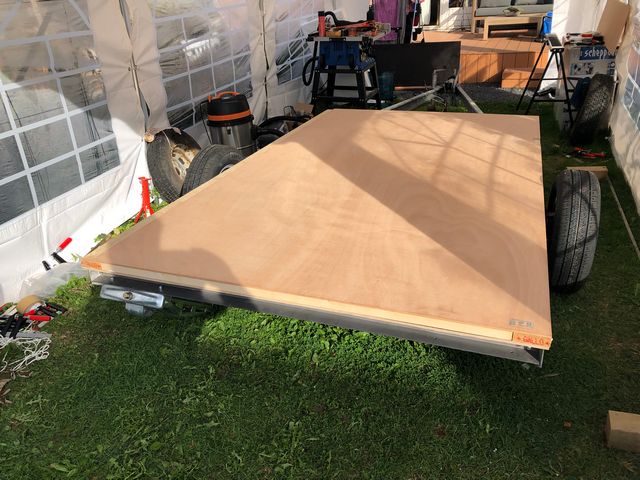

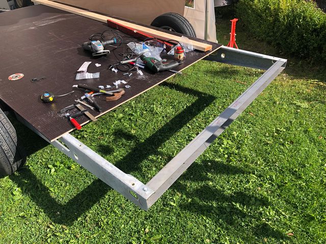

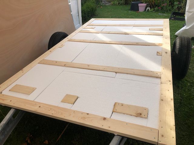

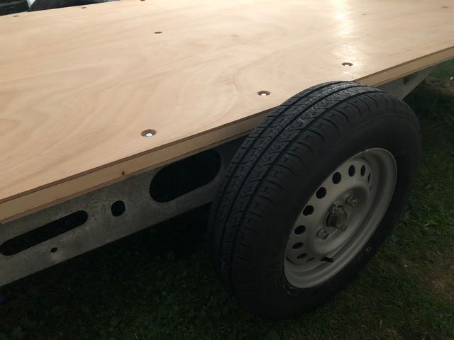

Building the floor was the easiest job. Using 9mm betonplex (multiplex with a thick watertight layer) at the bottomside.

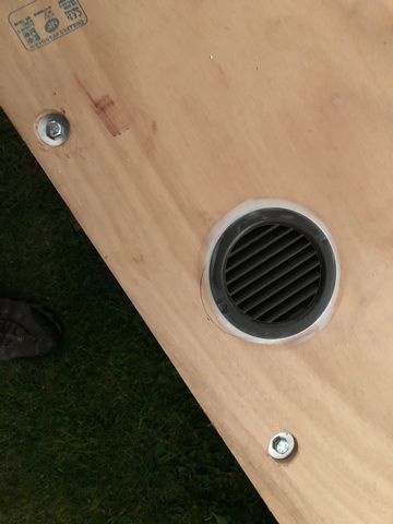

air vent in deck for cool air to fridge

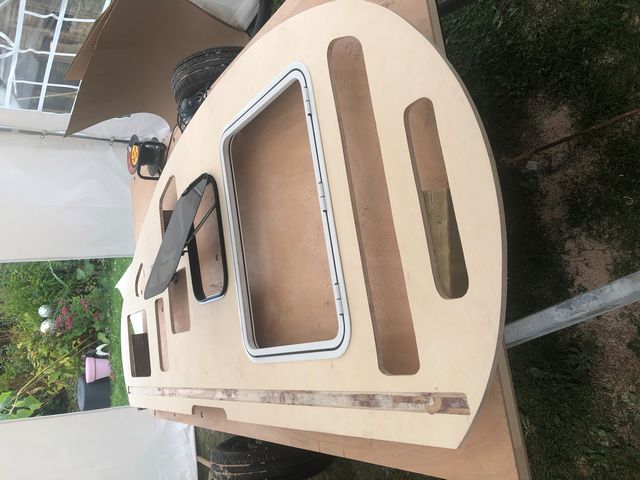

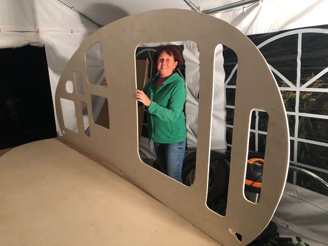

Postby Jan-Willem » Thu Sep 19, 2019 7:14 am

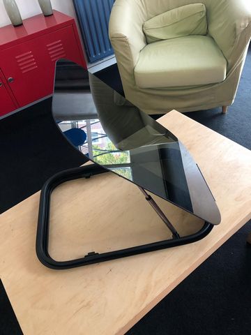

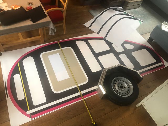

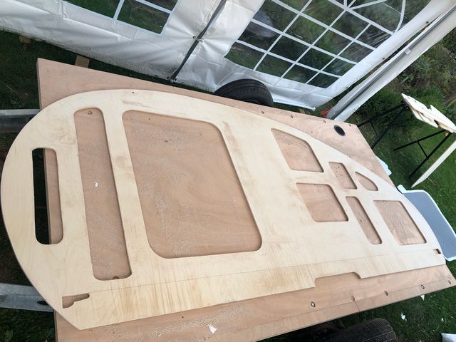

used the Wyoming Woody plans and redesigned them in Illustrator and let the print full size. Glued that on 9mm multiplex to make the outer and inner template.

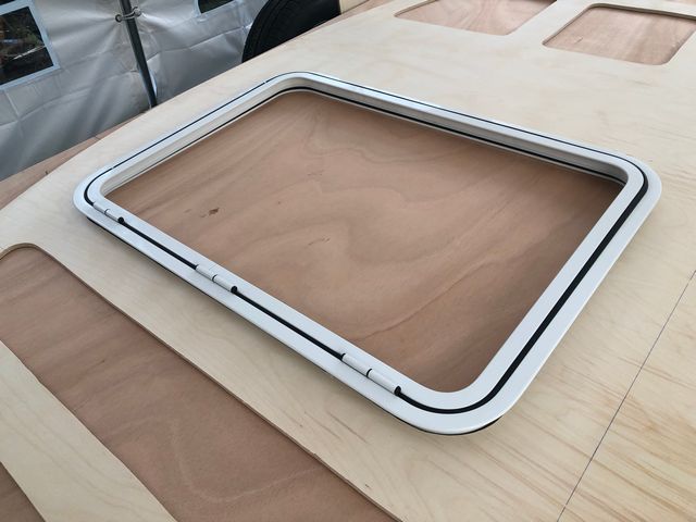

Today the windows arrived from Germany, 250 x 500 mm, safetyglass and only 99 euro
Print 1:1
doorfitting
next fitting
windows are delivered

Postby MickinOz » Thu Sep 19, 2019 8:57 am
50 Euro! That's 81 Australian dollars. :cry:
And just about perfect for the job.
What a bargain.

Postby edgeau » Thu Sep 19, 2019 4:14 pm
Nice progress. I was surprised the trailer did not have a rear cross member but you solved that in short order.

Postby pchast » Thu Sep 19, 2019 8:55 pm
You have made a good start....
May I suggest that you reduce the width of the framing on
the sides and front and back to help reduce weight. Also,
I found it useful to take and keep pictures of framing and
blocking with measurements as I built.

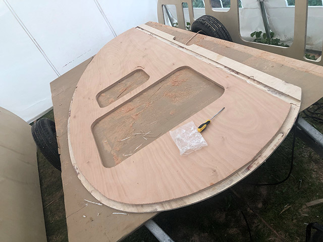

Postby Jan-Willem » Fri Sep 20, 2019 1:35 am

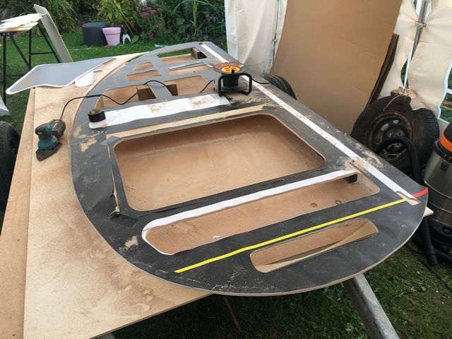

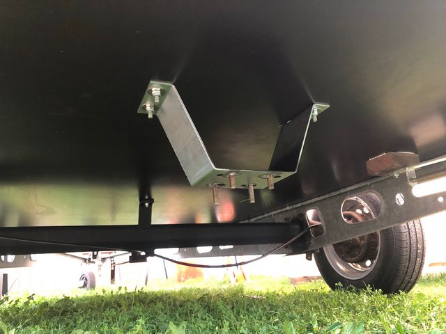

Another step further in the construction process. The supports placed at the rear and a bracket for the spare wheel under the rear of the floor. Then the first sidewall roughly sawn with use of the template, now we can start routing.

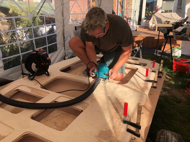

A tip from my experience. Lots of sanding before routing as it will duplicate every little bump in the original.

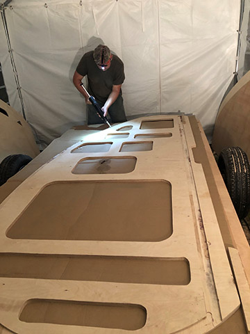

Postby Joost1207 » Sun Sep 22, 2019 11:31 am
Hi Jan Willem, looks like a nice build! I built a woody quite similar 2 years ago, hugely enjoyed the process. Check out my buildjournal for the pictures. Let me know if you have any questions!
Groet,
JoostImage

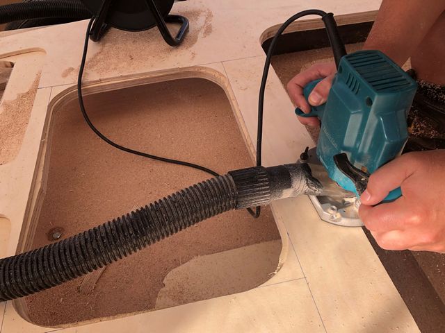

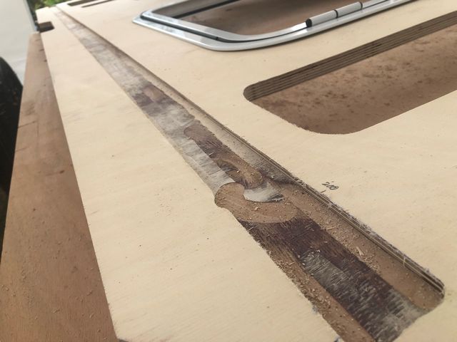

Postby Jan-Willem » Mon Sep 23, 2019 1:54 am

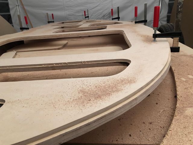

Worked on the first wall today. Routing is easy from the template. Long part at bottom is 6 mm deep and fits at the side of the floor when putting together.
Found the hard to find hurricane hinge in Belgium, male and female part, 170cm long for € 68. (https://www.noyens.be/webshop/index.php/webwinkel/aluminium-profielen/01-010-0001-detail

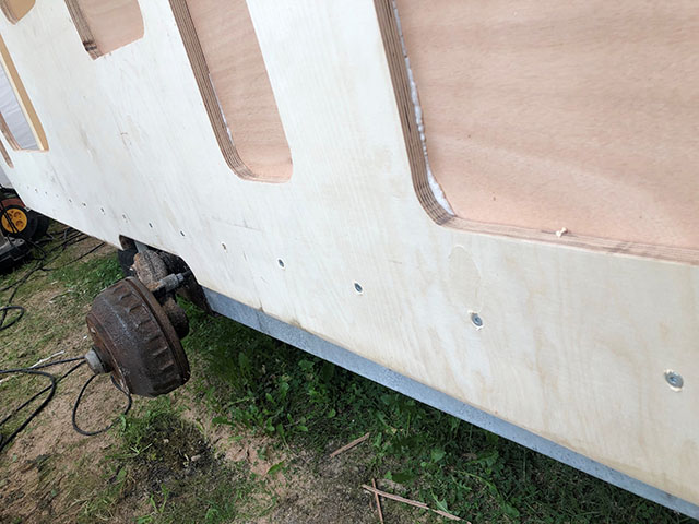

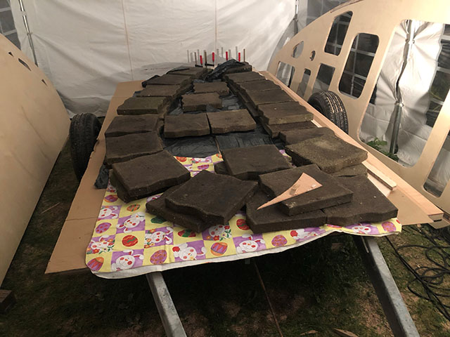

Tonight glued the first innerwall of 4mm multiplex to the main wall (18mm). And load about 450 kilogram of stones on it. Ready for today. tomorrow routing and finish the other wall before assembly to the floor this weekend.

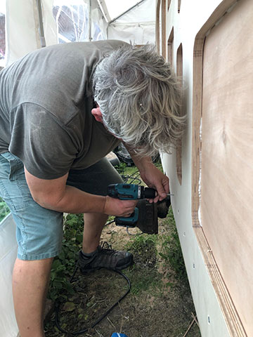

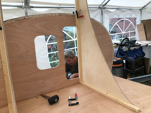

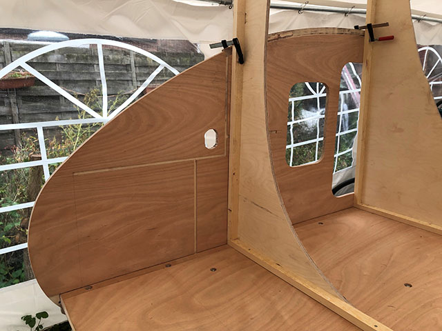

Postby Jan-Willem » Mon Sep 30, 2019 5:25 am

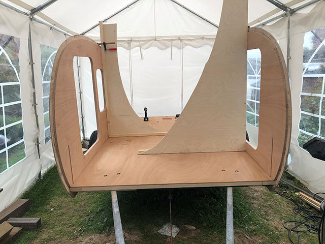

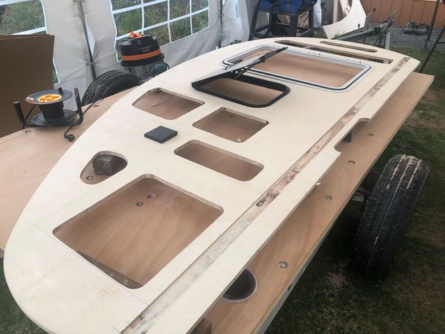

first use the router to mill the shelves of the cupboards and kitchen into the walls so that it can later be supported by them. Both sides had to be exactly the same so a precise job. Then placed the first wall and glued and screwed. the other wall is only screwed because the cupboards still have to come in between. Now get started with the cabinets.
