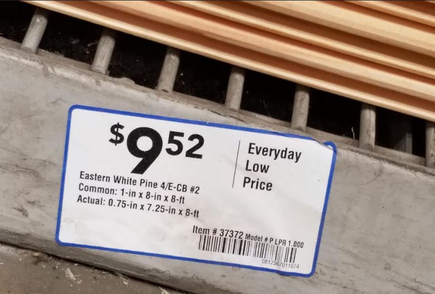

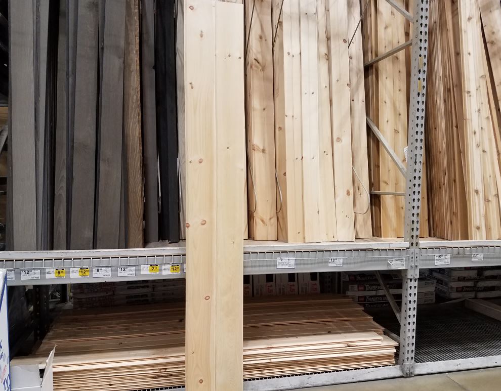

For my roof I'm planning (at the moment) to epoxy and paint. I recently built a small mini boat with marine grade ply covered in fiberglass and epoxy. This seems like it would be a good option for the roof? https://www.youtube.com/watch?v=oW-zfNxbrDc (Incidentally, I think it would adorable to have the mini boat sitting on the front of the camper tongue when towing to campgrounds)
The Coleman door was fortunately one solid piece so the framing and installation should be much easier but I'm still working on how I want to do that.
For my exterior I had an idea the other day to use tongue and groove pine boards that I saw while walking through Lowes. They were relatively light and would be easy to mount. They lock in tightly to each other and with some sealant and paint might be an acceptable exterior finish for the walls. On one side they are grooved to look like two pieces and on the other side they are wide 8" without the groove. Then on the inside I could insulate and finish as desired. The nice thing about this build is that the camper is just shy of 8' long on each side, so... an 8' long board is plenty long; no butt joints. It's a very tiny conversion.
Still thinking and sketching. My goals are to make it strong, simple, and low on cost. We'll see how well I can hit each of those goals.
