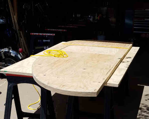

I put my template together and traced the profile and cut it out. As you will notice, when you don't have much space, any flat surface becomes storage
Here I am tracing the profile. When you don't have much space, any flat surface becomes a bench
20200509_210912 small.jpg (464.75 KiB) Viewed 6450 times
20200510_124435 small.jpg (463.82 KiB) Viewed 6450 times
In my spare time, I put the skeleton boards about 3/4 inch plywood. I say that because, for what ever reason, sheet wood does not come in even dimensions. Because of this, I was unable to make the spline attachment in the book. I would have loved to cut a 1/4" slot and place stacked 1/8" baltic birch in the slot but my 1/8 baltic birch is 3mm and my 1/4 inch piece of board that I bought for the batten is 5 mm. After pondering the question of where now, the skeleton boards are put together using 8 Biscuits each. Sorry, no pictures of that. A 10 foot piece of plywood is just not that interesting.
After a little time passed I marked the critical things on to the template. A dimensional bust I found was in the location of the front storage area (Headboard Dados). To fit an 80 inch queen mattress, locate the inside/cabin edge of the rail at 11 inches as shown on page 20 and not 10 inches from the ceiling as shown on page 64. I am pointing this out for the next guy that tries this. I work in the construction industry and have seen it happen many times, including designs I have created so i was no big deal to me. Anyhow, onward. Apparently there is a limit to pictures so I will continue on a second post.

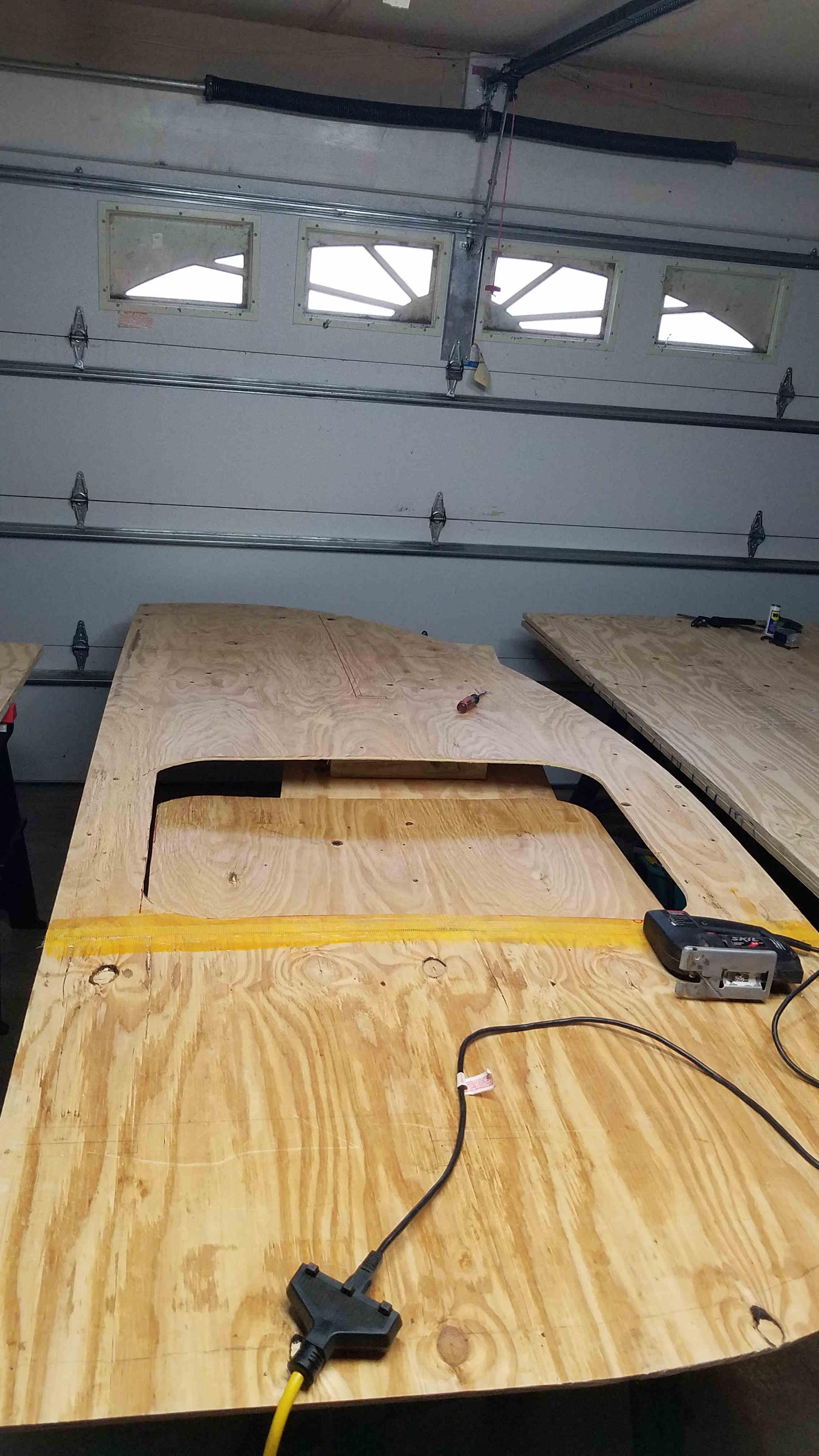

As I said earlier, I purchased doors to save time and hope they would fit better than what I would build. To make the cut out, I placed the door on the template and traced the flange that passes through the wall.
20200606_194234 Small.jpg (511.65 KiB) Viewed 6446 times
Guess what? The door didn't fit. After some fiddling, I found that there are pieces attached to the flange, looks like plates and fasteners and such. So after expanding the opening, the door fit
20200606_202105 small.jpg (478.34 KiB) Viewed 6446 times

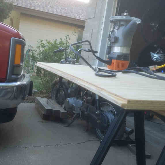

All's good so far and I though I would have a picture of the skeleton for you but disaster struck next. Tip number 2. Check the collar that holds the bearing on the trim router bit in place and make sure it is tight.
I stacked my two boards for the skeleton, lined them up just right, screwed the template and the boards together, cut the excess off with the jig saw (talk about a slow process) and proceeded to trim the skeletons to size with the router. That is when disaster struck. Somewhere along the way the collar came loose. The bearing moved up the shaft and the template started riding against the shaft instead of the bearing. If this had happened near the beginning, no problem, it would have been cut out and discarded. No this happened at the rear about 6 inches from the end. This portion gets cut out but saved for the side of the hatch. I am working on ideas on how to fix it but also fear I may have to rebuild the skeleton plywood. My next post will have the answer whatever that is because I don't know what it is at this time. Also, I will make the pictures smaller so, hopefully, they are easier to view

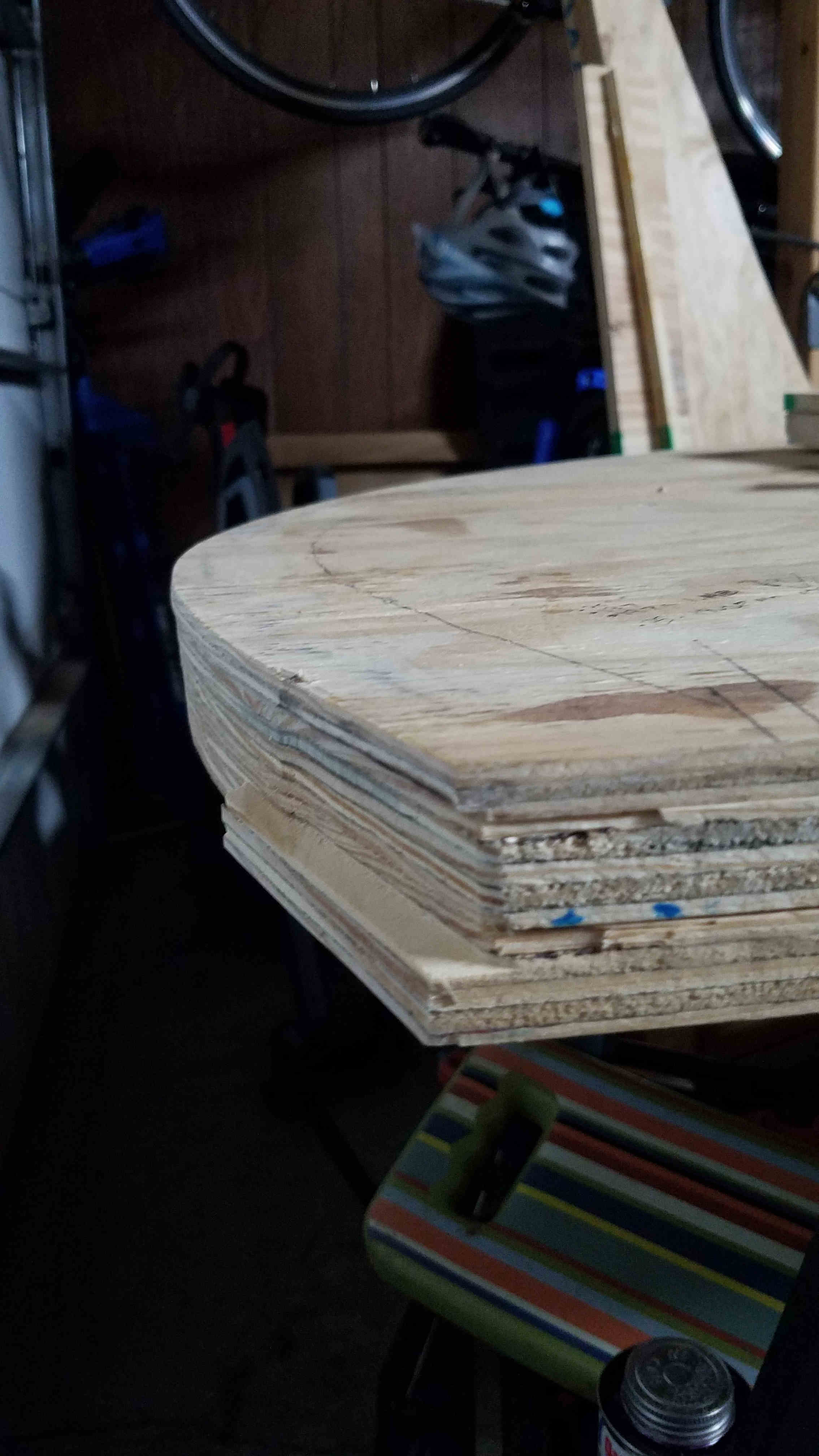

Mine was a Bosch. Anyhow, the damage is right at the very end
20200609_214614 Small.jpg (411.64 KiB) Viewed 6384 times
It was very windy so I had the garage door down to keep the dust from going everywhere. It looks like the router leaned over a slight bit when I got to the end and maybe had to reach to get around the curve. Also, the bit is 1 inch long so it got both boards
The solution that I am considering is cutting the end back a foot to 18 inches and attaching a new piece on the back like was done on the front. Restack them and try again. My only concern is the side having that joint in it. Lets hope I can get it glued well enough that the glue joint is stronger than the wood

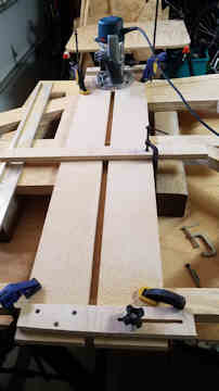

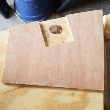

So I played with the tongue and groove bits this afternoon and got everything lined up after an hour or so of fiddling. This evening I went on and cut the back end off the skeletons. I cut about 13 inches off the back end
20200612_191654 Small.jpg (49.82 KiB) Viewed 6278 times
After cutting off the second one, I cut the first tongue
20200612_194955 small.jpg (49.28 KiB) Viewed 6278 times
This is what it looks like with the new piece on.
20200612_200502 Small.jpg (43.28 KiB) Viewed 6278 times
One of these pieces must have a slight bend in it. There was a lot of banging to get it together. This is a dry fit. Tomorrow I will actually glue it up. The problem with an overstuffed garage that you share with a car. You have to put your toys away every night to bring the car back in. When I get to the floor, I don't know what I am gonna do. I guess move some bicycles and other things to the shed :thinking:
Tony, thanks for sending me back down this path. I think it will work much better than the biscuits :beer:

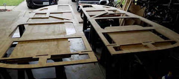

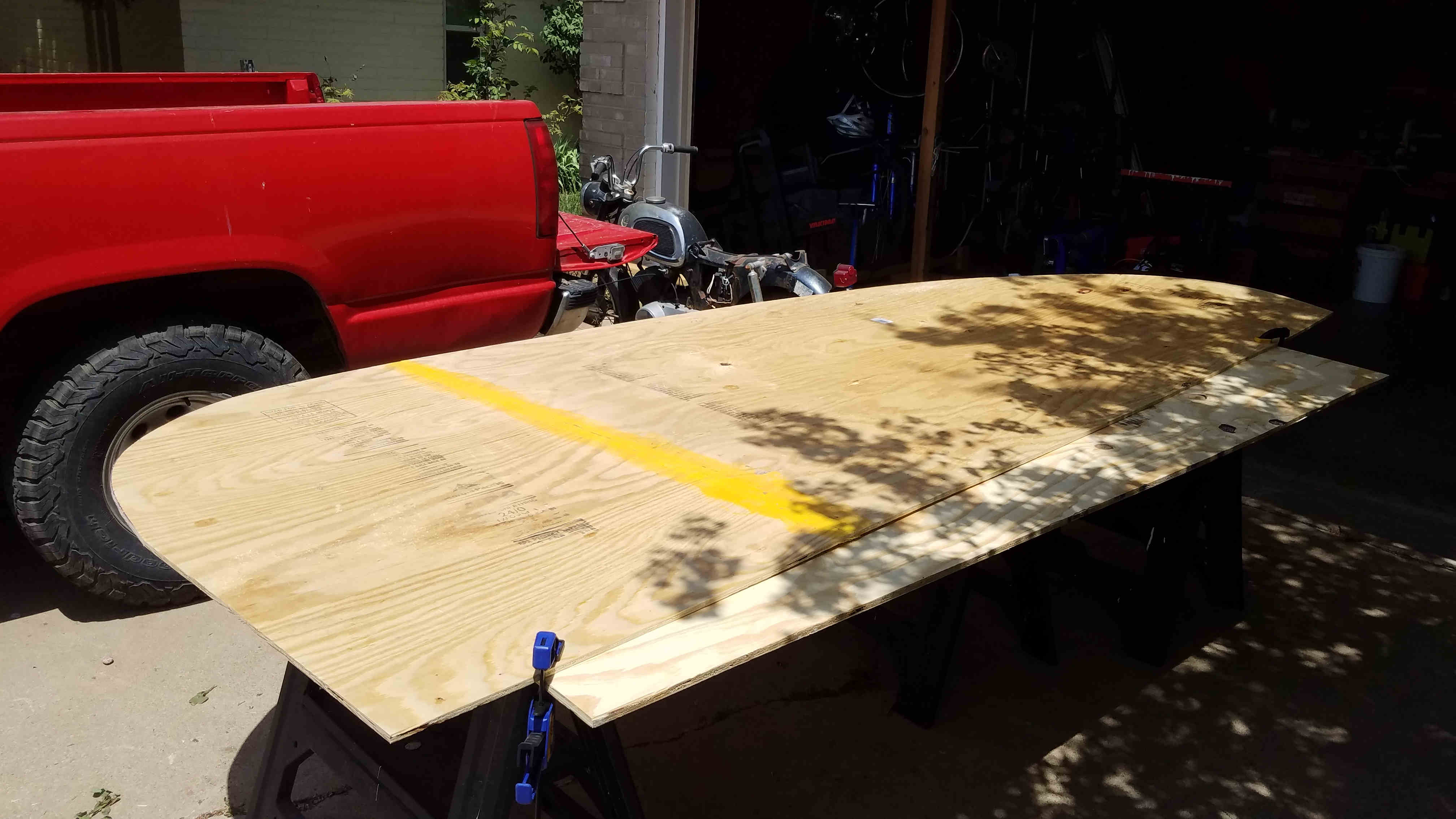

This weekend I hit a small milestone. The skeletons are complete and ready for covering

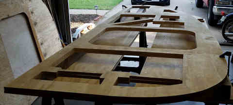

I started by building the dado jig. I looked around at what I could find and came up with the adjustable one using parts that I had around the garage from a previous project. Here is the jig after the dados were cut. It took a couple more passes without the jig to completely cut through the stack
20200627_152932 Small.jpg (32.71 KiB) Viewed 5918 times
The board in the middle is the stop for the top of the shelf so I didn't mistakenly cut through and make a continuous dado.

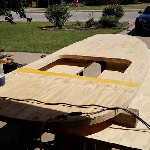

After the dado was cut, I cut out the template for the hatch spar. When I put it on the skeleton stack, I found another mistake when the line I drew on the skeletons was in the middle of the area to be cut out with the template. It leads me to another tip for future builders. Mark both sides of a feature that you want to transfer from your template. I only marked on side figuring I would measure the second side and mark it. Well, I put the second line on the wrong side so I will need a shorter queen mattress when I outfit the trailer. I still think it is in tolerance but I may have to trim the edge. Any how, here's how that looked
20200628_174447 small.jpg (46.75 KiB) Viewed 5918 times
Here is the end product. I went on and flipped the one side to make it easier for me to remember the inner skin goes on different sides of the skeleton
20200628_193337 small.jpg (36.67 KiB) Viewed 5918 times
Tomorrow should see the first sheet of the inner skin go on to the first skeleton.
