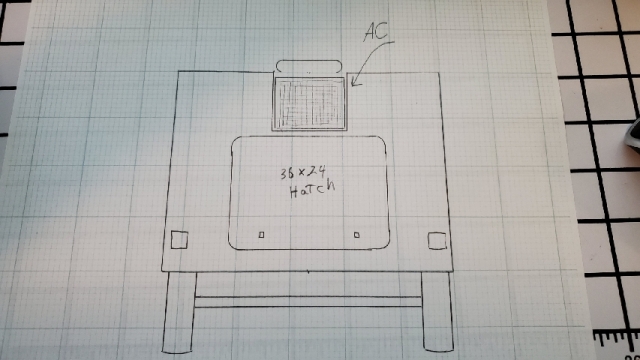

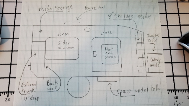

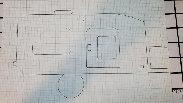

Here are my concept sketches, one set plain for clarity and another notated. I welcome any feedback on this, I have already ordered doors, windows and hatches, a few more items like this and I'll be ready to start on the walls.
I am adding AC. I believe my design will mask the idea that it is a window unit or at least minimize it. We live in Texas and mostly travel the surrounding states. It's always HOT. I am not insulating the floor but I am using 5/8" rubber foam mat for the flooring. (good for the knees) I also probably won't insulate the walls and will build them with cabinet plywood at 3/4". I will insulate the ceiling.
**There is a radius on the front but it didn't come through in the drawing.

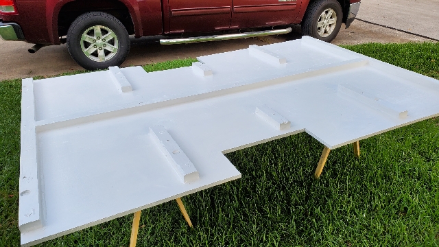

Here is a look as I am putting final touches on the floor
Sealing the 2x3 with caulk
Creating pockets so it sits flush over the bolt together HB trailer
Floor coated and ready to flip and bolt down. The coating included the edges all the way around.
I'll detail my wall connection strategy later but it will sit on top of the floor for full height. I'm 6 feet tall. I'm undecided at this point what to coat the outside with. I know I don't want to do epoxy or pmf. I also don't want it to look like painted wood. Maybe we'll prime it and go with bed liner. I'm also leaning heavily towards FRP for the roof. I would use white roof patch but it'll get grimy fast.

Keep in mind an allowance for your window flanges (both inner and outer with a little fudge factor added) when deciding your window placement (i.e. rough opening cutout) adjacent to the rear storage locker bulkhead. (I'm sure your thinking of this, but the drawing makes it look very close.)
Thank you, you are correct. I drew this right to left so it's a fudge and not intended as a build guide but just general layout. In reality the door will probably be a little more forward and the windows a little more over the wheel. I also have a similar error on the rear where I made the hatch too tall and it extends to far down to accommodate the sloped lower corner. Details... Details... :)

If you could grow that 32" tall door to 36" your noggin would appreciate it. (I don't know if you are building the doors or buying them.)
:beer:
I hope i don't regret the door height. I purchased the door. I had a 36" door in my cart but a few days later when I went to order it wasn't available. I wanted to get the order done so I settled on the 32" door.
We are accustomed to very small hiker tents so I'm hoping this works out. Worst case I install a larger door down the road.

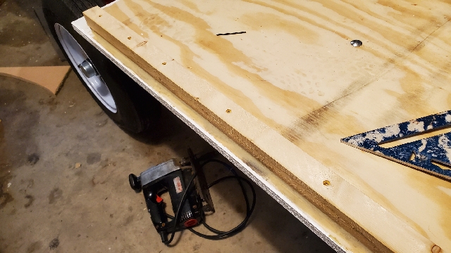

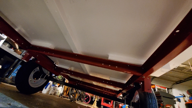

Finally I got the floor bolted down. Being under the trailer messing with 15 carriage bolts in a very tight spot in a garage north of 90f was not my favorite place to be. I figured I would post this picture because it was a minor victory and it probably won't look this clean and new much longer.
I'll get to work cutting out the profile, windows and door later today, I'll also try and get the wall mounting rails in place. Going to use a 2x2 rail running on the inside of the floor leaving 3/4" to the edge to set the wall in place. The same process will be used for the front and rear bulkheads.

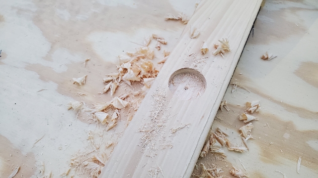

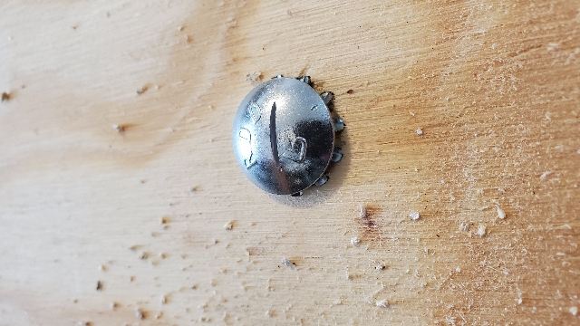

A little more progress today, freak'n hot outside! I had 2 of the 15 carriage bolts that wouldn't catch and tighten (I used lock washers under them). Here is my solution, made it easy for my wife to help. Use a rotary tool to make a slot for a flat head.

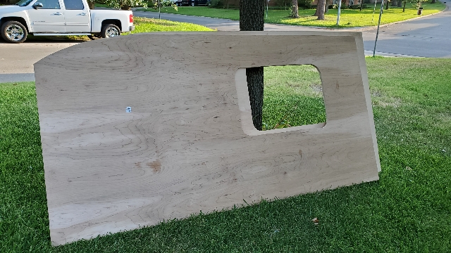

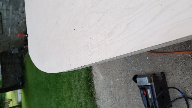

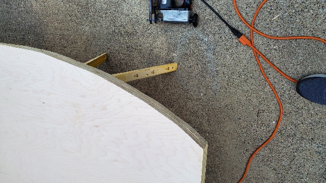

I got the radius cut on the 2 walls. I used my trusty jigsaw to cut the first, then used the scrap to trace out the next. Then I clamped them together and used a belt sander with 40 grit to match then up very well.
Before
After
The downsize on the images is extreme, not sure how well the difference comes through.

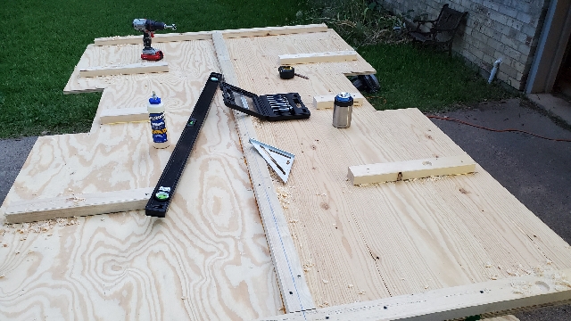

A new set of progress pics. I have also been thinking hard about the AC situation and have come up with a new plan there. Originally I was going to leave the rear of the AC and the top open to the air but flush with the lines of the camper but I am now planning to enclose it but the hot air exhaust will be a vent cover of some sort and fresh air intake will come from side vents with duct work built in to the cabinet.

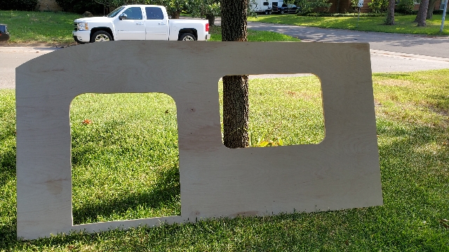

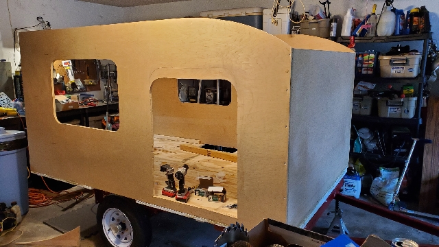

I got the profile and door/window placement cut on each wall. It's a very basic maybe boring profile but should ride nicely behind my Sierra. The only thing worth noting is there will be an 8"-10" addition to the rear of the camper.

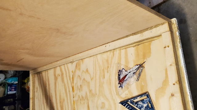

I got the front wall up last night. A little messy with the adhesive however there will be a WIDE skirt/trim around the base to seal the seam between the floor and wall connection.
Here is some detail on how I am attaching my walls. I'm losing a little sleep over how to protect the wall where it bridges the wheel well. The edge of the board will be exposed. Open to advice here, I am thinking to coat it with tar and maye wrap it in a C channel.
Probably too late but prong washers are the solution. The fact that they also distribute he bolt head is a good thing too.
Re: Starting a new build "Big Tiny"
Postby pchast » Fri Jul 17, 2020 9:13 pm
They used to be called carriage bolt thrust washers.
Now I see in McMaster they are bolt square lock washers.
:thinking:
Today's changing world often baffles me. :lol:

Walls up and first real feel for what we are looking at. I'm excited.

Postby philpom » Sat Jul 18, 2020 11:12 am
Yes, that would have been perfect. Instead I used external tooth lock washers. At this point I have no interest in backing all of those out.
