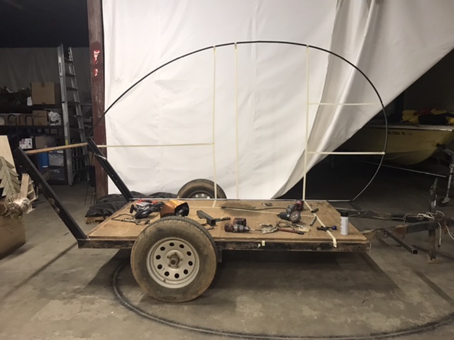

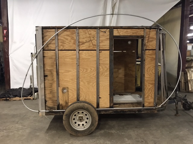

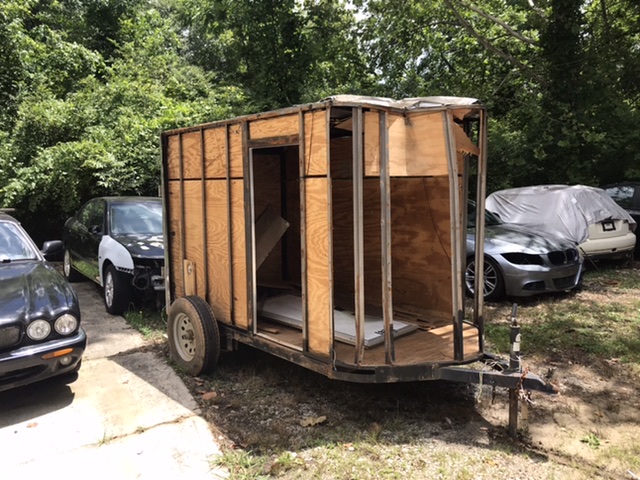

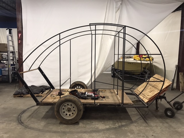

I was originally going to build a trailer frame from scratch out of square tubing, but then decided to look for an old boat trailer as a donor for the axle, wheels, hubs, coupler, ext. I live next to the largest lake in the southeast - should have been a good plan. But, everything started at $500 and up - which didn’t seem cheap enough to warrant the labor to convert it to what I needed. I finally found a single axle boat trailer not far away for $100 with a bad wheel bearing. I gathered up tools to fix the bearing and went to buy it, but it turned out to be a 6-lug, 5000lb axle with really big and really rusty surge brakes. The frame was also heavier than I wanted. I explained this, then he said he had another option. It was a Pace American 5’ x 8’ v-nose enclosed trailer that had been wrecked in the top front and roof. He had already stripped all the skin off, but it still had the ramp gate and was towable. It had 15” 5 lug wheels and a drop axle, all in great shape. Same price - $100.00. Sold! The trailer was almost the perfect size - though I had planned for the whole camper to be 6’ wide and this one was only 5’. I was going to widen the trailer, but then devised a plan to get around it - make it wider at the front where the width was most needed, and have it step in to the 5’ width before the wheels. Saves a lot of work, and adds some interesting design detail.
The donor trailer:
The donor trailer with a tear template in place:

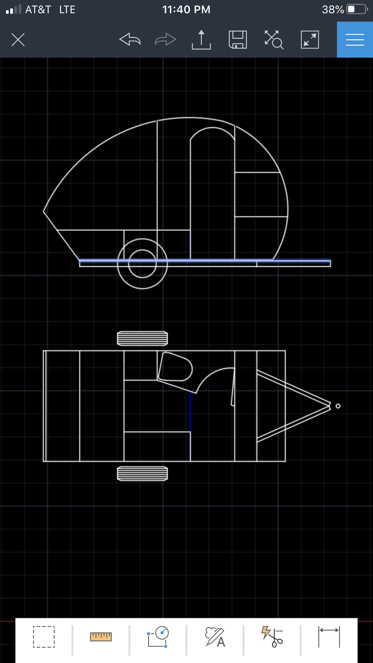

Here is a simple drawing of the floor plan and side view.

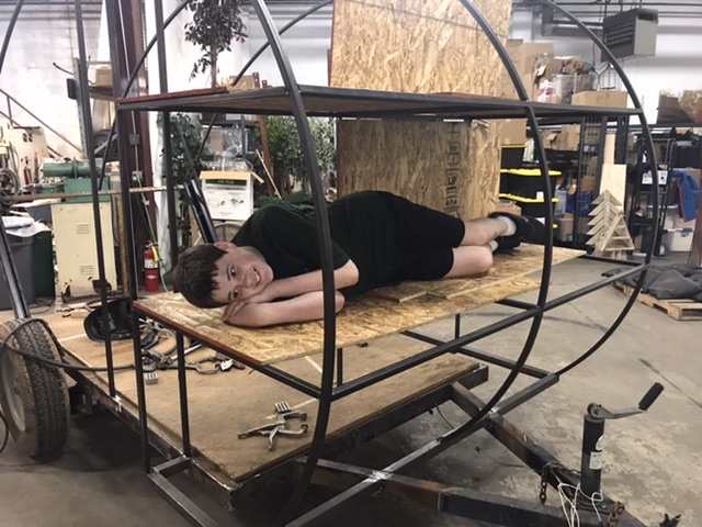

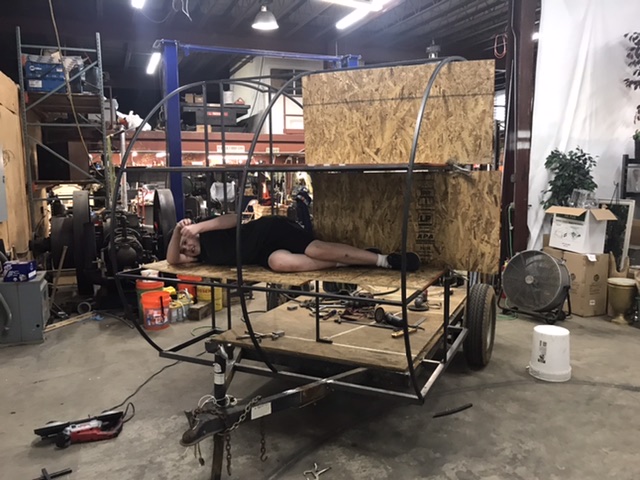

Postby tubularfab » Fri Jul 17, 2020 10:02 pm

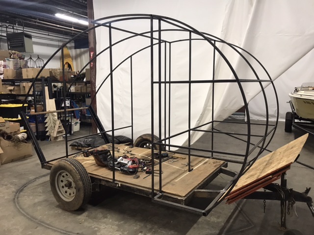

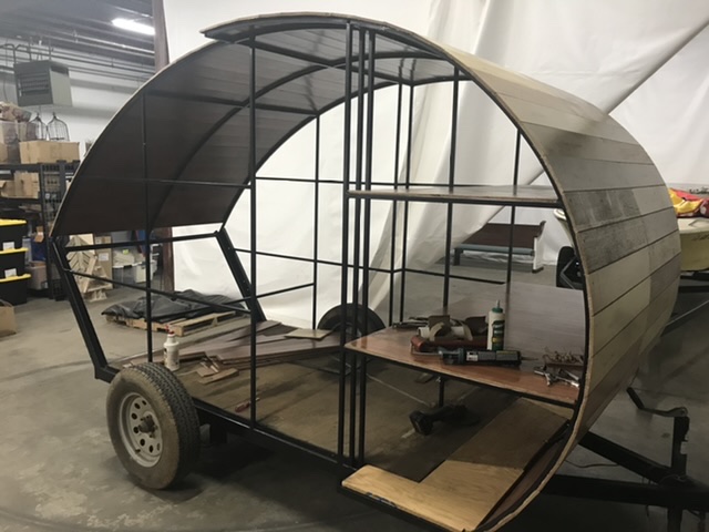

Progress over the last week. Making good progress on the framing.
The biggest kid proving out the bunk space:

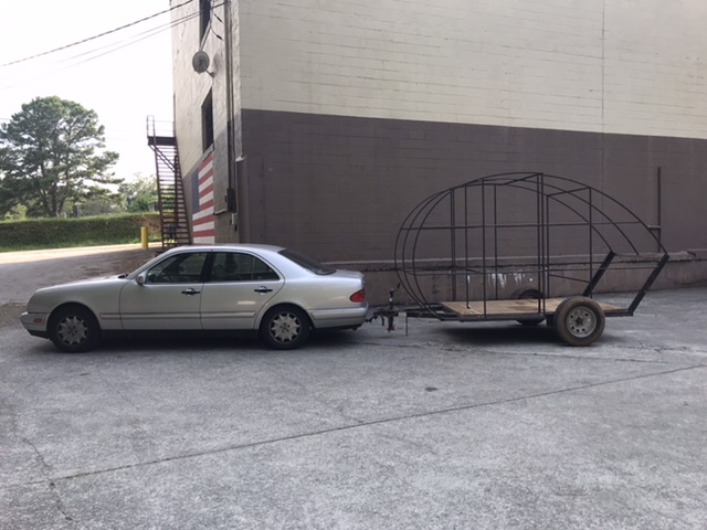

Postby tubularfab » Mon Jul 20, 2020 7:39 pm

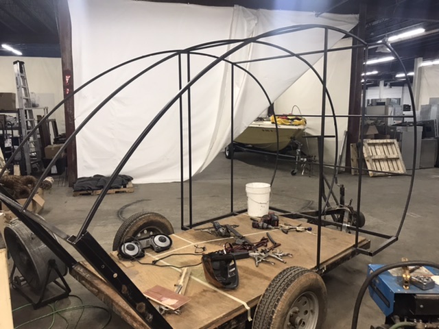

I got a few more tubes tacked into place, and then decided to see how it looked hitched to my smallest tow vehicle. The old Mercedes diesel will be used to tow it most of the time, but it will also be pulled by my dually at times, and also a Honda Odyssey.
I have a couple more bracing tubes to add, finish weld it all, and then I’m ready for paint.

Hello. I like your frame and the build method that goes with it, I’ll be watching with interest. I’m guessing you roll those curves with a commercial machine. :thumbsup: Is that right?

Your design image won’t completely show in my iPad Pro ( can’t slide it) so I cannot quite see your plan.

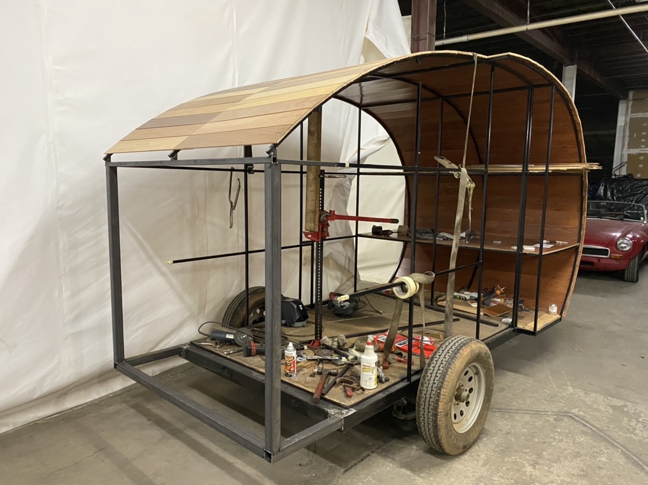

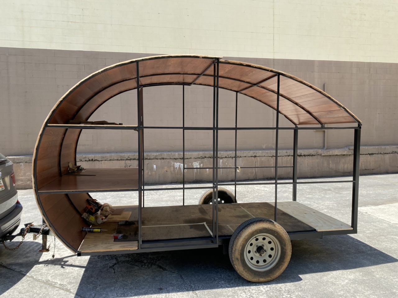

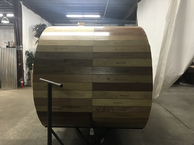

So, my last post was July 20 of last year. That was the same week that my boss said it was time to switch from “work at home” back to normal work. And, I discovered quickly that after 5 months of not making a 55 mile commute into the center of Atlanta I wasn’t really looking forward to restart the daily traffic nightmare. Also this same week a local high school reached out to me needing an Engineering teacher for the program they had spent the spring and summer building all new labs for. This would be a 14 mile drive on rural roads with no traffic. And, summers off to travel!! (I should admit that I really wanted to get back to a teaching job as well, besides the other perks I focused on!). So, I changed jobs and quickly had to start spending a lot of time building curriculum for the program. As a result my shop time took a big hit, and consisted primarily of paying jobs!
But, I did get the wood paneling (yes, technically flooring) on the roof right before starting the new job. I just never posted pics:
I like the outside appearance except for the batch coding that is inked in under the polyurethane and simply won’t come off. But, the outside is going to be covered with insulation and roofing anyway, so no big deal.
To answer the question above - yes, I used a cool tube rolling machine to get the frame tubes formed. It was a pro machine, but could have been done on an entry level hand cranked one from harbor freight as well.

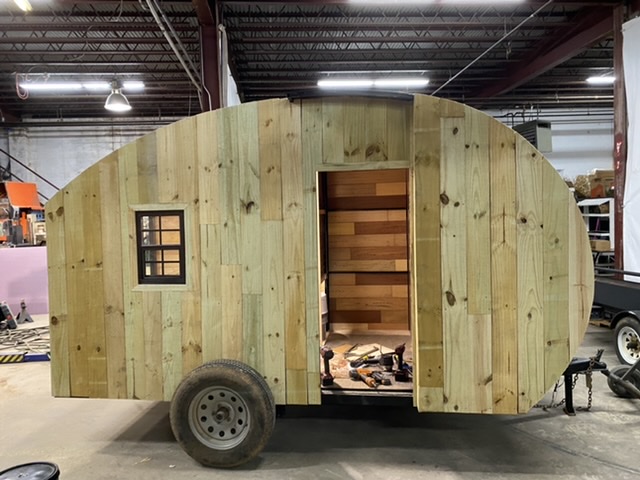

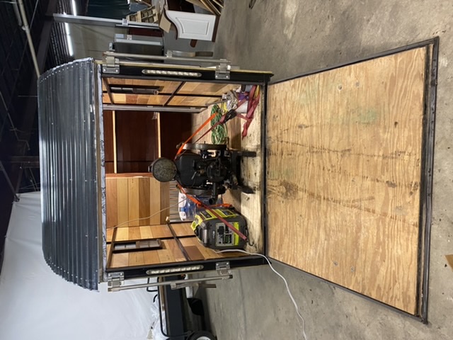

First, I decided to enlarge the ramp gate and make it vertical:
Pulled it outside:

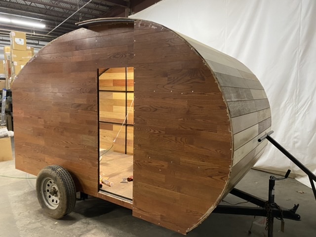

Added siding - letting the back side of the flooring panels to be exposed:
tubularfab

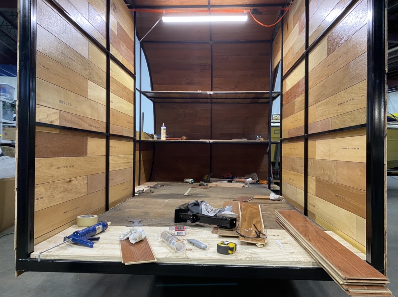

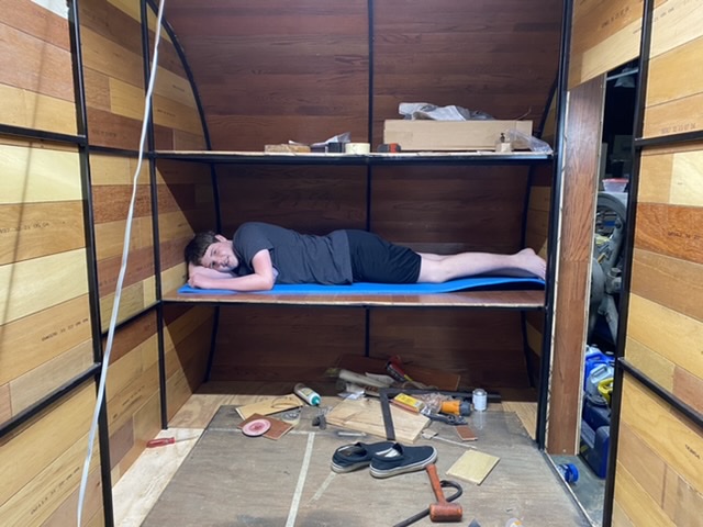

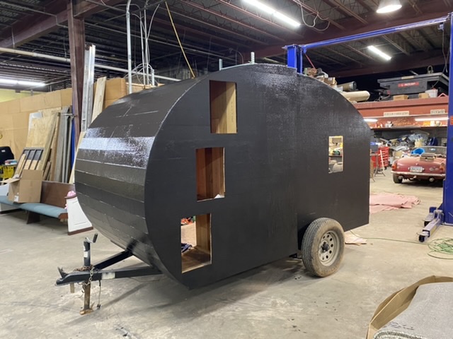

More:
The front bunks:
Whole box coated with rubberized coating to waterproof it:

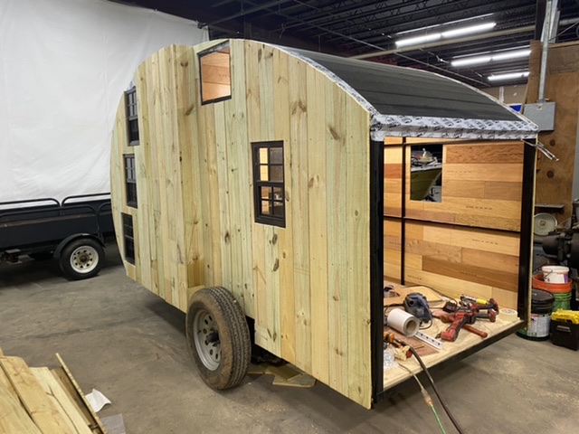

Postby tubularfab » Mon Jun 21, 2021 8:25 pm
Siding (fence pickets) installed:
Started the roofing:

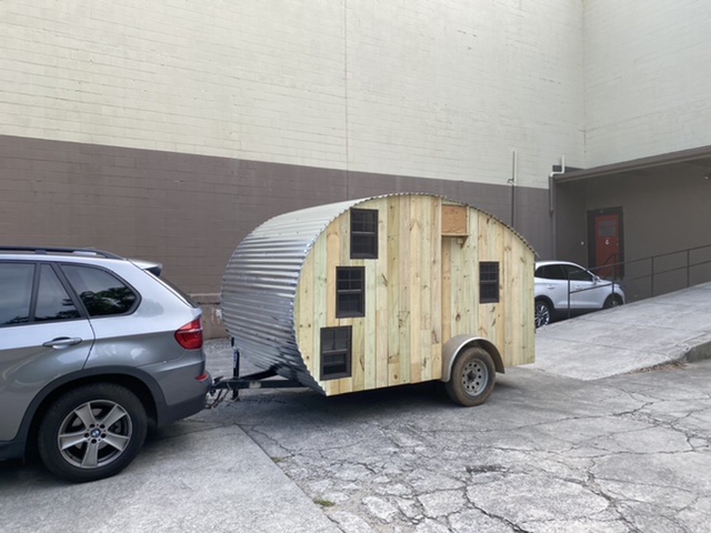

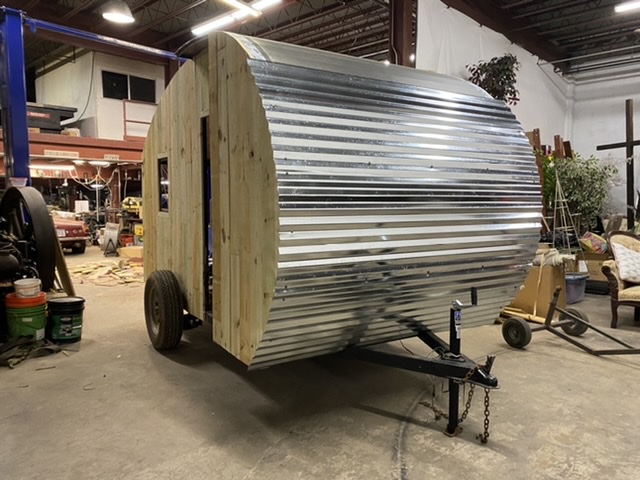

I needed the camper to go on a trip, so I had to stop building it here for now. We packed it full of stuff, including an antique hit-n-miss engine, then started a 2000 mile trip. It gave us no issues and towed well. I did not get the main bed built, and we nor the shower / bathroom so we did not camp in it. It was used to haul all or stuff and as a home base at the engine show.
As done as it would have to be for the first trip:
On the road!
After the trip - showing the engine I hauled to the show.
tubularfab

Outstanding! I really like the individual windows for each of the three bunks. I'm curious why you chose to have a narrower cabin behind the bunks. Aero-wise you already are clearing a wide path through the airstream, it would make more sense to me to keep the same width all the way back and enjoy a bit more square footage in the cabin. Having a ramp in the rear to load engines and such you could consider a lifting bed mechanism and maybe use a folding table and chairs for dining.

Yes - I had conflicting ideas on the width for sure. I used a 5’ x 8’ enclosed trailer frame and axle, which is the width of the back half. I bumped the front out so I could have 6’ long bunks. I considered widening the whole thing but didn’t want to have to deal with the axle. So, this was the compromise…
Also, it provides protection for both the door and the A/C…
