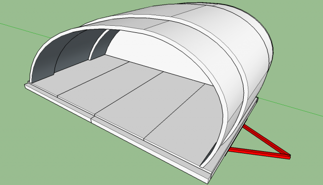

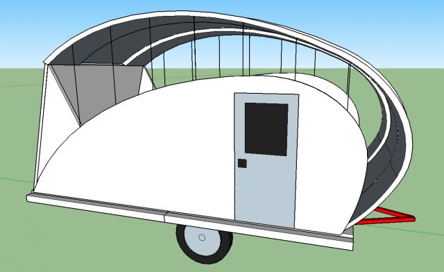

Here are drawings of my idea about how fiberglass-reinforced plastic (FRP) and kerfed 2-inch thick foam sheets (a form of structural insulated panel - SIP) might be used to create a dual slide-out variant of the Alto, which I nicknamed the Corto (Alto is Spanish for "tall", and Corto is Spanish for "short"):
Yes, I'm aware that the floor panels in the drawings with the slide-outs extended/retracted aren't oriented the same, the tires aren't faired-in when the slide-outs are extended, and that the trailer might be unstable in a strong crosswind. These are concept drawings, not structural plans. I'll be fleshing out my ideas some more, but in the meantime, I have actually done trailer building that's independent of the living quarters portion. I could just pitch a pup tent on what I have completed, at this point!

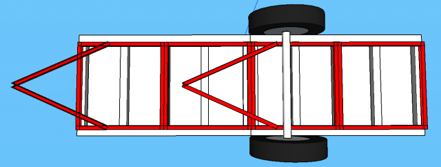

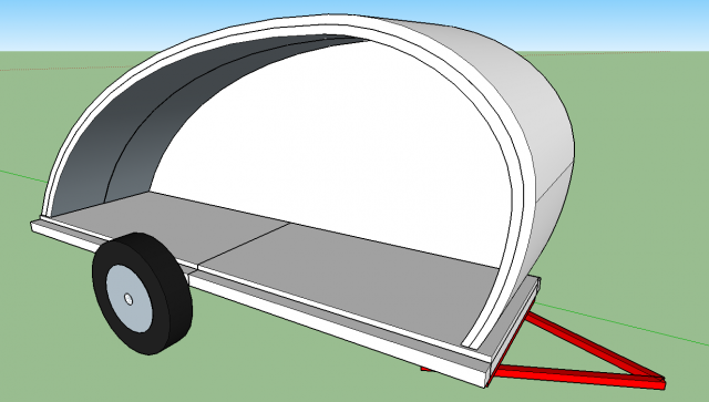

I've also acquired enough FRP and foam sheets to build 12 SIPs, but that will only be enough to build about half of its full, 7 x 16-foot potential size. The Altos are about 8 x 17 feet in footprint, in comparison. I'm considering building a 4 x 8 foot prototype first, since I have the trailer frame built and have more than enough SIPs to fabricate a traditional small teardrop trailer. That would likely be very useful to work out issues before I make mistakes that might be much more expensive, in terms of material/money and time, at full scale.
I haven't quite worked out what to use along the panel edges for both protection of the foam, as well as bonding structure corners. I had considered using a thick polyethylene sheet material that's relatively easy to cut, but it's too flexible for structural use. I could just saw strips of FRP and bend/fold them around corners, bolted through the panels, as they're very stiff and resistant to damage due to structural flexing under dynamic pressure from airflow on the road. However, they couldn't be easily bent around curved corners without radial cuts through the curved edges. I'm trying to keep the number of cuts, holes drilled, etc., to an absolute minimum to reduce the build time and effort as much as possible.

Postby John61CT » Sat Sep 19, 2020 6:29 pm
Great stuff!
What's with the extra A-frame?

Postby RJ Howell » Mon Sep 21, 2020 5:47 am
We drove to Levi to check the Alto out a few years back. I opt'ed out due to quality vs. price! I loved the lifted roof, but all else failed to impress me. You'll be much better served for your dollar building one!
The concept of the window panels remaining fixed and sliding in the walls relies in my mind, to heavily on the gasketing. Because of the construction, it made the walls fair to flimsy, again in my mind. I built a truck camper and went canvas (duck cloth actually) at my sidewalls for the lifting roof. I've now seen several lifted roofs that are folding hardside! This makes so much sense as the walls are structurally sound as is the folding sections. Add windows as you wish! I have screens almost entirely.
Why do you want the side also to slide? Issue to defeat is getting that lifted roof not only weather tight, but ridgid. Interesting,. :thinking:
