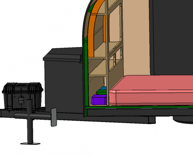

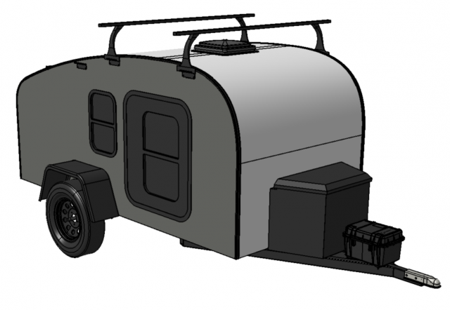

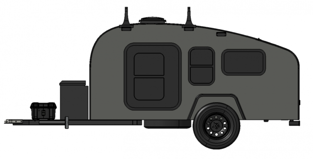

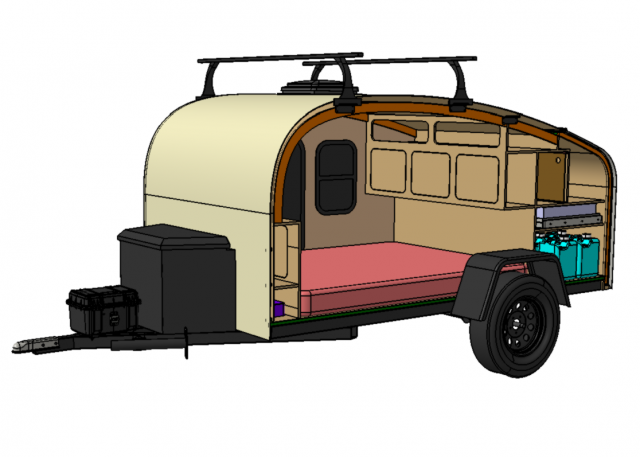

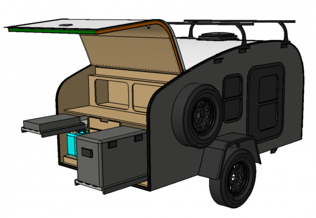

I realized I didn't give much detail on the "foot locker/galley storage" side access door idea.
Here's a picture of the area showing the access door aft of the window (and a proper side profile view) and a cutaway so you can see the cabinet layout.
Is it worth the trouble and potential for water intrusion, or should I ditch the side access door?

Postby tony.latham » Wed Nov 25, 2020 9:57 pm
Me? I'd pass on it. You'll have plenty of access with the hatch open.

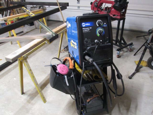

Okay - time to get building and turn this from a design thread into a build thread...

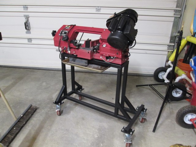

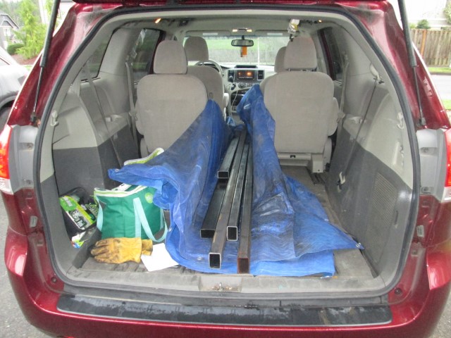

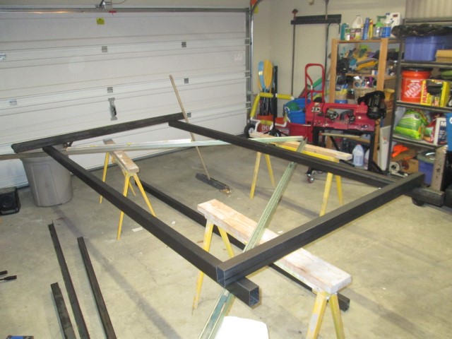

Did some garage prep and brought home the steel for my frame yesterday and got most of my trailer pieces cut to size today. Put the Harbor Freight bandsaw and its custom base to the test...
Tomorrow I weld. :)
