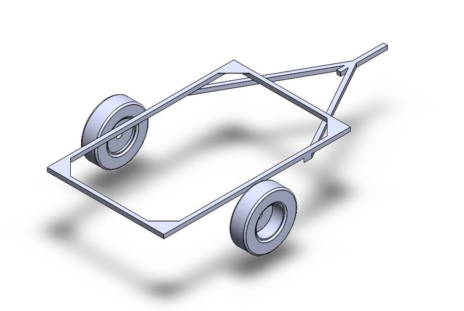

Step 1 (Custom Trailer):
  • 59" x 95" trailer base
  • 2x2", 1/8" wall thickness tubing
  • 205-75-15 Tires (This seems to be a common size according to etrailer)
  • #9 Dexter Torflex Axle @ 1500lbs (if I can find this..)
Question 1: Do I need any cross members to support the floor in the center?

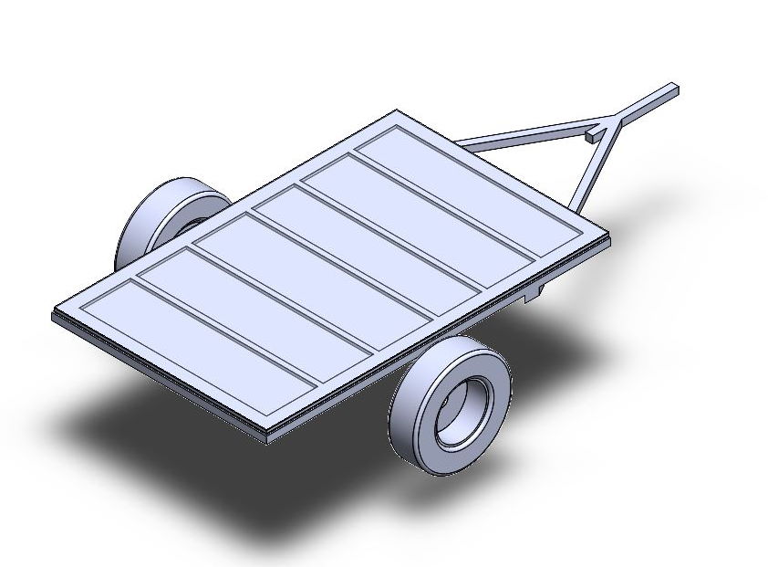

Step 2 (Floor Sandwich consisting of):
  • Floor: 59.25 x 95.5" x 1/4" marine plywood cut from a 5x10" sh
  • 1x4" exterior blocking
  • 1x2" interior blocking
  • 3/4" insulation
  • Some sort of 1/4" plywood on top
Question 2: What should the bottom be coated in? I've seen roughly 100 different answers from tar, to paint, to fiberglass. I'm trying to stay away from fiberglass

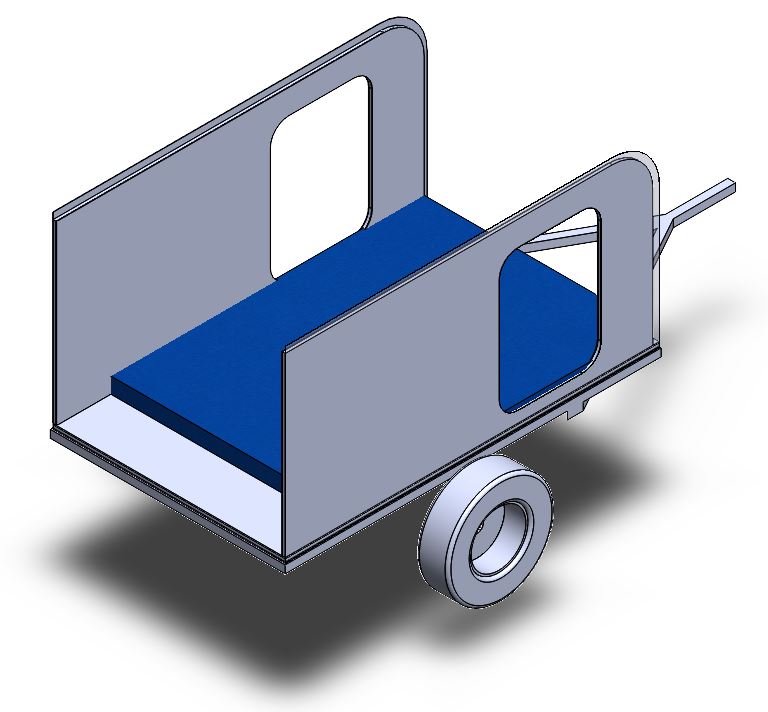

Step 3 (Wall sandwich):
  • Exterior: 1/8" baltic birch
  • Skeleton: 3/4" ACX Plywood with 3/4" insulation
  • Interior: 1/8" baltic birch ply
The skeletonization is not shown yet since I haven't figured out what the galley or interior cabinet work will look like.
They are all special order. I order mine direct from Dexter.
Your floor design will be remarkably stiff. I use two strips of 3/4" ply for my floors set with the grain vertically for stiffness.
The gussets are temporary to keep it together until one side is sheathed. The plywood is to support the heavy stuff in the galley. The outer floor frame is made from 1 x 6s since my bolt attachment points are about 3 1/2" in.
The Torflex axle will stiffen up the frame. I add a piece of angle under the galley since I put a battery, water jug, and cooler back there. That's a lot of weight.
I believe in using something that soaks into the wood and cures for this. You can't beat epoxy for this and I don't see any reason to use fiberglass. Several coats of back-to-back thinned polyurethane will also do it.
If you want to set a trap for dinosaurs, you might go with a tar-based roofing product like they used to use --and some still use. (That's humor, BTW for you guys that use Henry's.)
Skeleton: 1 x 2 poplar w/ 1 1/2" insulation
I live and camp in the Rockies and think you are overdoing it on the wall insulation. I build with 3/4" in the walls and 2" in the ceiling. It's plenty. I also use 3/4" CDX plywood for the skeleton because it is a lot quicker and adds flexibility for hardpoints (drawer sliders, gas strut attachment points, hooks etc. You can screw both together and gang cut them. That wall thickness may also cause issues if you are buying commercial doors. (Check with the manufacturer.)
You don't need marine plywood on the bottom. Do a proper job of sealing it and you'll need to include your camper in your will. I use 1/4" underlayment. It's cheaper than AC and built for wet environments. But any exterior plywod will work fine.

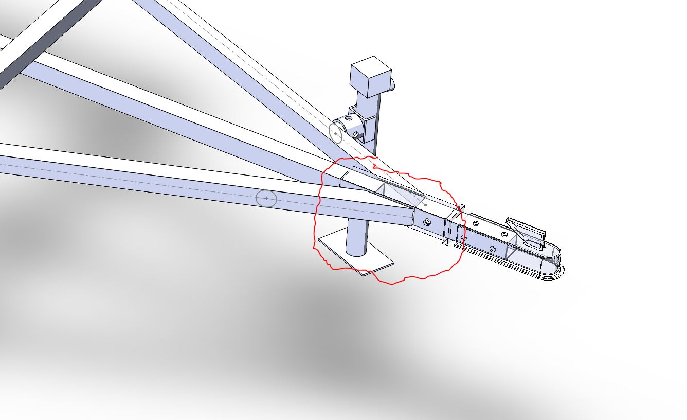

One more question about the frame/tongue. I'm using your removable tongue design. How far does the "central" member go into receiver hitch?
Removable trailed tongue based on Tony Latham's designs.
1-1 trailer tongue.JPG (89.5 KiB) Viewed 962 times
I think it's about ten inches on the inside of the tube.
