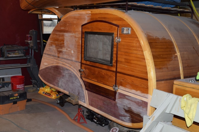

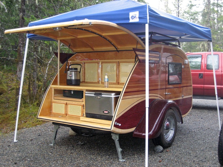

It's been 12 years since the SlumberMax was built. It has gone from Alaska to Louisianna and from Michigan to California. It's getting a little tired and is ready for some new finish, paint and tires. Here it is circa 2009/
And here is is now as I've started sanding and disassembly...
A couple things I've found out about the test of time.
On the hatch and over the roof, I used 4 oz glass, MAS epoxy and shot it with auto clear coat. 12 years later, it still retains its shine, has very little sun damage, and a couple spots from water damage. I will clean it up, paint the roof rack, and probably re-shoot it with clear. All in all...the fiberglass, epoxy, auto clear coat has withstood the test of time very, very well.
On the sides, the wood strips did not get glass, but were epoxied and spar varnished. Some of the wood strips have opened over time and the varnish is tired. Hind sight says I should have glassed the sides for stability when it was built. Anyway, the sides will get stripped down, filled, and finished with new epoxy and varnish.
The fiberglass fenders have been repainted several times due to rock chips. They will get new paint and protection. The trailer gets new wheels, tires, and I've already replaced the hub seals and greased the bearings.

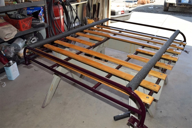

Anyway, I finished up refurbing the roof rack. It was made out of 1 inch electrical conduit that is fitted and welded at the joints. Over the twelves years of service, it has held up well without any cracking or paint loss on the frame and has hauled quite a bit of firewood and stuff like that. I'm calling it a success for light duty use...
The only thing that failed on the roof rack really was the finish on the ash wooden slats. They did not receive a seal coat layer of epoxy under the finish when I built it...and I think the finish might have been a cheaper poly of some sort, but I can't remember. The finish failed on the vertical surfaces (edges) and turned black. Just goes to show the value of not cutting corners on wood finishes. The refurb included sanding them down and application of three coats of Man O War Spar Varnish. I've had pretty good success with good marine spar but, like anything, it will need to be kept up over time.
The rack itself got a cleaning and new paint (Restoration Shop Acrylic Urethane Royal Maroon) and new pipe insulation for the top rails. The old pipe insulation turned chalky from exposure.

Finished up on the refurb. Hubs greased, new wheels and tires, fenders, frame and roof rack painted, swap for 4 to 7 prong tow plug, hatch lifts reinforced, and lots of new varnish and auto clear. It wqsn't too bad for 12 years old but it is nice to have that backlog of maintenance completed.

The top and hatch were glassed (so they stayed sealed) but the sides were just epoxied and varnished and some of the strips opened up. I had to take the sides down to bare wood to fill cracks those cracks. That's why the purple heart is purple again! I've had my fill of sanding and varnishing for this go around.
